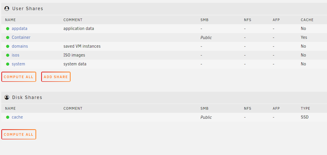

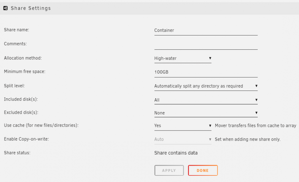

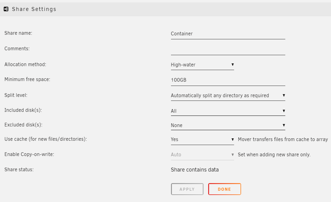

User Share setup:

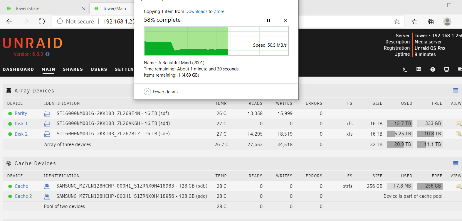

What happens when copying.
No activity on cache.
(now tested with RAID0 on cache to see if it worked better)
Have I missed something?

Still not clear from your screenshot if you are accessing disks, or accessing user shares with that copy.
Did you turn off disk sharing as I suggested?
The User Share: \\192.168.x.x\Container\(Ztore)
Edited by PeterNet
Do you mean the source and destination are both in the Container user share?
Source: My table computer (Downloads folder)
Destination: Standalone Unraid Server with User Share: \\192.168.x.x\Container\Ztore (Subfolder Ztore after User Share "Container")

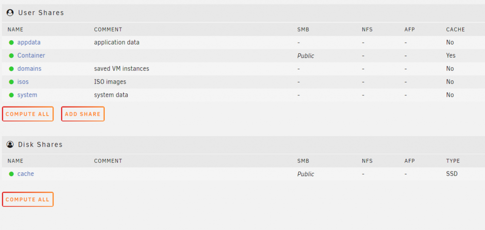

Cache Share seems to be turned on by default, after activating Cache.
