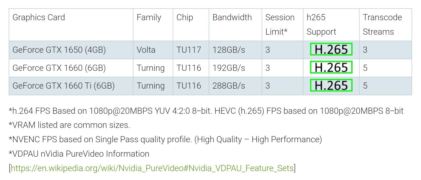

By the way, the GTX GPUs are limited by Nvidia to only two simultaneous hardware transcodes.  That is why many users go with the Quadro P2000 as it supports "unlimited" hardware transcodes.  Of course this is only needed with AMD CPUs or non-iGPU Intel CPUs and if you want hardware transcoding instead of the load on your CPU with software transcoding.
I didn't know about the 2 transcode limit for GTX GPUs?
1 minute ago, Paul_Ber said:
It doesn't list 1660 Super?  What is the "session limit" vs "transcode streams"?
I'm going to go out on a limb and say its capable of  Streaming 5, but its locked to only allow 3.
