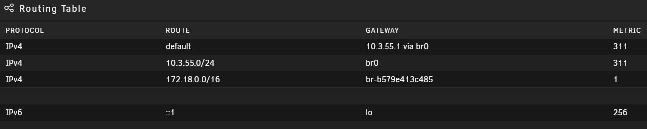

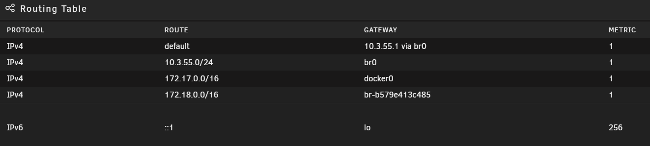

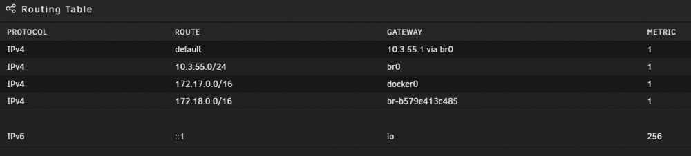

        - That network has a metric of 1 in my ip routes, whereas my eth0/br0 subnet always has a 200+ metric
        - I don't know how to change the new Docker network (br-b579...) to a higher metric... could this be the cause?
        - When Docker is enabled the 172.17.0.0/16 docker0 network shows up with a metric of 1, same symptoms (no dockers use it, all are on proxynet)
        - Screenshot above also has the "optional metric" for my eth0/br0 IPv4 gateway set to 1, yields the same symptoms

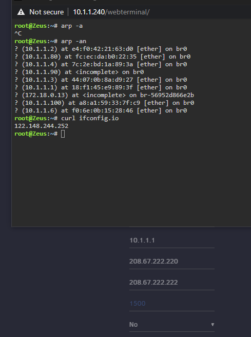

Digging into tcpdump of "curl ifconfig.io"
    - unRaid settings: external DNS servers statically assigned in Settings > Network (open DNS = 208.67.220.220 and 208.67.222.222)
    - The traffic (packets) going from point A to B were just fine, quick as it should be... but something was slowing the overall request down
    - 106 packets over 15 seconds
    - 33 of those were ARP requests to my local router asking "who has [myPublicIP]?
        - This got me curious... why is unRaid continually trying to figure out that my router is the next layer 2 (mac address) hop to my public IP?
Digging into ARP requests
- Resource: https://osqa-ask.wireshark.org/questions/5412/what-does-arp-42-who-has-19216811-tell-192168133-mean
- ARP (Address Resolution Protocol) requests are similar to DNS requests but they are IP to MAC resolutions rather than Domain to IP resolutions

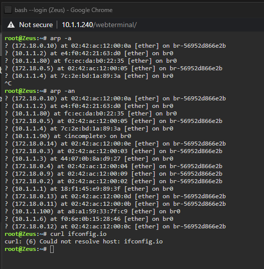

- running arp -a was very slow (this shows IP addresses and their corresponding MAC addresses)
- running arp -an (no DNS lookups) was instantaneous
    - Surprisingly this is the same after resolution, but it makes sense because DNS requests of each local subnet IP and 172.18.X.X docker subnet IP fail
TLDR Resolution
Since unRaid kept asking my router where my public IP was and being a novice...
I figured what the heck, lets set the first DNS server in unRaid > Settings > Network to my router
- BAM! curl requests are now instantaneous, checking for plugin updates takes ~5 seconds, loading CA tab takes 2-3 seconds
- This was exactly the opposite of SO many threads I have read... they all suggested removing the local router as a DNS server
Honestly, this isn't a favorable solution... as I have always preferred assigning each machine external DNS servers and avoiding the local router
Digging into tcpdump of "curl ifconfig.io" with local router as the first DNS server
    - unRaid settings: local router and external DNS servers statically assigned in Settings > Network
        - local router as #1, then open DNS = 208.67.220.220 and 208.67.222.222 as #2 and #3)
    - 42 packets (64 less) over less than 1 second (14 less)
    - None of those (33 less) were ARP requests to my local router asking "who has [myPublicIP]?

I've had almost identical issues with my setup. I've tried to set my first DNS record as the router (as suggested) but CA still takes 60sec and then timeout.
I've tested ping google.com whilst array is stopped and left it running to check changes when i start the array and it seems to not be able to connect once the array starts.
ARP testing below.
First is with Array Stopped
arp -a took too long to load.
arp -an was instant.
curl was slow by successfull
Second Image is Array Started
arp -a slow but successfull
arp -an instant
curl failed as you can see.
PING
ping requests failed to DNS and IP when array started. Successfull when stopped.

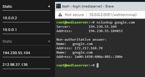

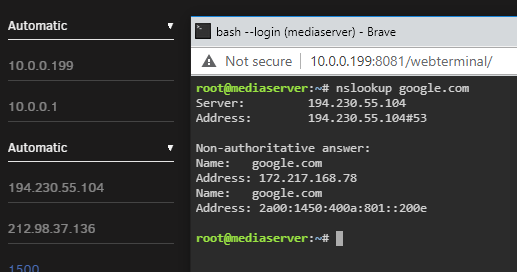

I have a lead. If I switch to "automatic DHCP" from static, everything is super snappy (unraid menus) and nslookup works, If I switch back to static and add DNS like 1.1.1.1 and 8.8.8.8, nslookup stops working. If I revert back to auto DHCP, it works again. If I revert back to static IP without touching DNS, it still works.
Is it possible that XGS-PON requires you to use your ISP provided DNSes ?

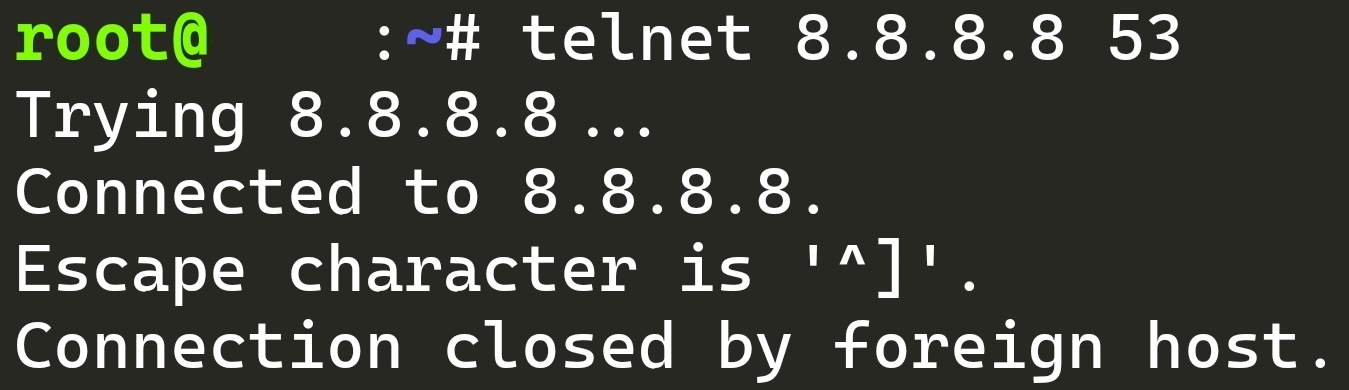

It is entirely possible that your ISP is blocking outbound requests on port 53 (DNS).
Quoting that answer so you don't have to click the link...
"Yes, they can block custom DNS - and its fairly trivial. All they need to do is block port 53 exiting their network (except from their nameservers - but in practice its more likely to be from their broadband IP ranges)
The logical reasons for doing this include (which I vehemently disagree with, but thats besides the point) tracking usage, forcing traffic to local caches, blocking access to certain sites, injecting adverts instead of errors for non-existent domain names.
There could theoretically also be benefits to you (prevent some kinds of malware, faster DNS resolution times for people with wrong DNS settings)"
To test if they are, just run this at the terminal:
telnet 8.8.8.8 53
If it times out/fails to connect then your ISP is blocking outbound requests on port 53.
This is what my successful result looks like (not blocked):
