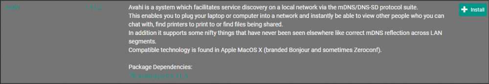

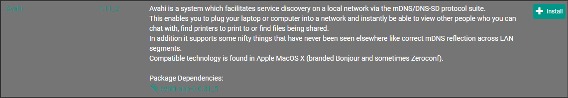

Was just having this issue on my server "randomly", did all my typical reboots, trying different DNS servers (Google, OpenDNS, Cloudflaare, etc) to no avail....  was going through my mind and thinking of stuff that's changed recently and I use a PfSense firewall and had installed "Avahi" package recently to allow one network (hardwire) to Chromecast to my other network (WiFi) and haven't noticed any issues since installing it... until I logged into my server, a few weeks later.. of course. :)
After removing the package and turning DNS to "manual" then back to "auto" seems to resolve it. (can also change it back to manual and works fine)

I've nailed it down to something around the mDNS stuff, as before its mentioned in the log everything is OK, once that starts up (well before the array starts) then it all falls over.
What is UnRAID doing with mDNS?
Edit: To clarify, SSH in and start the ping bbc.co.uk as soon as you can. It works OK for a few seconds until something else is done during the startup and then it goes slow.
Edit: Confirmed.
Pings start going slow just as this happens:
/etc/rc.d/rc.avahidaemon start
Running /etc/rc.d/rc.avahidaemon stop
Fixes it...
