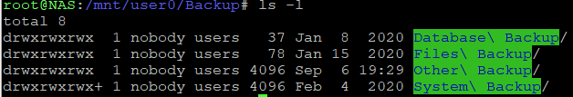

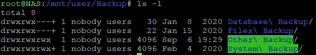

/mnt/user/Backup ls -l
While /mnt/user0/Backup ls -l
Sometimes inside "Files\ Backup/" folders are now owned by user "sshd"
Any idea what i am doing wrong or why this is occuring?
The backup jobs are simple rsync jobs, any idea what i need to change to have the permissions not change? Thanks.

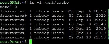

What are the scripts that you're running; how are you invoking rsync? Are they run by the root user? What are the ownerships and permissions on the original files that are being backed up? Do the first two screen grabs show the situation before and after running the scripts or not. If not then the difference could be explained by the fact that the /mnt/user0 path excludes the cache disk or pool from the union, while /mnt/user includes it. In which case, what does "ls -l /mnt/cache" look like?
The rsync script is invoked as root, it then sends the files to another unraid server.
The permission in /mnt/user/Backup was looking like the permissions in /mnt/user0/Backup before the rsync script ran.
I have multiple different scripts backing up to the /Backup folder, there are windows machines running FreeFileSync daily to send files to /Backup/Files\ Backup/ but whenever the rsync script has ran the windows machine credentials no longer have read access to the /Backup folder, i've ran the the "Fix Permissions" thing on the Backup share multiple times and i've narrowed it down to the rsync script doing something with the permissions everytime.
Cache permissions seems fine

I don't use FreeFileSync so I can't comment on its use. Regarding rsync, the very simple
rsync -a /path/to/source /path/to/destination
should preserve permissions and ownerships when run as root.
found the issue, i was running one of the backup scripts as a different user and rsync default tries to clone the permissions
