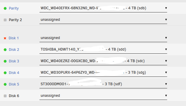

this should be the correct order of the HDD, the corrupted drive should be in slot 1 which i have not assign in yet.
do let me know the step by step that i need to bring up the corrupted drive.

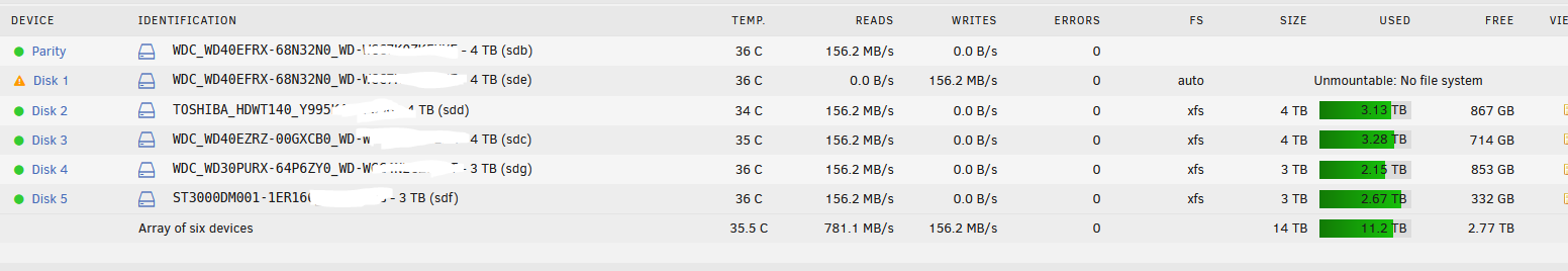

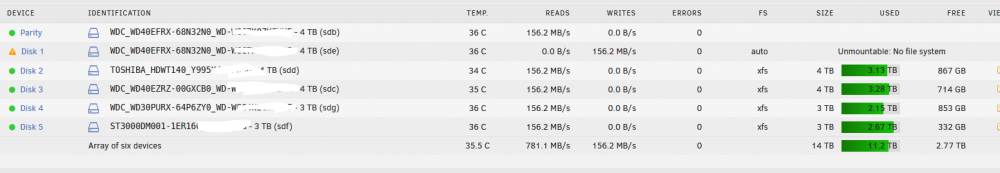

i started the array follow the instruction, but my folder still missing, is that normal?

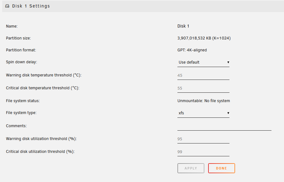

You can do it now, since not much point rebuilding if the filesystem can't be fixed, to use the GUI check you need to set the filesystem on that disk to xfs, you can do that by clicking on it.
i have stop the array and change the files system to sfx. but it still show as unmounted, should i follow the xfs_repair repair 1st?
Yes, that's expected, you have to run xfs_repair, using the GUI or the console.

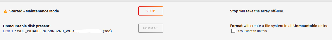

using GUI,
i have run the check with -n, then without any option. and now running with -L
2 minutes ago, Ong Hui Hoong said:
using GUI,

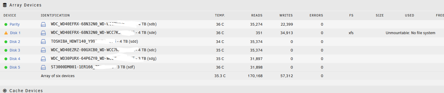

afrer with -L, still same, and there is some read write on the parity, did i screw up? :(
or should i just format the disk?
Don't format, post the output of xfs_repair -vL
should i do it with the parity disk in? it look like writing some data in to parity :(
