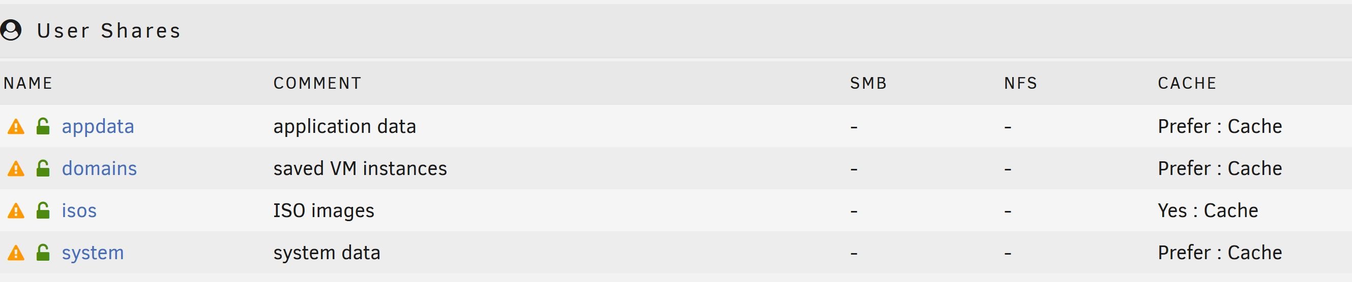

Go to User Shares, set appdata, domains, system shares to cache-prefer.
Go to Main - Array Operation and click Move

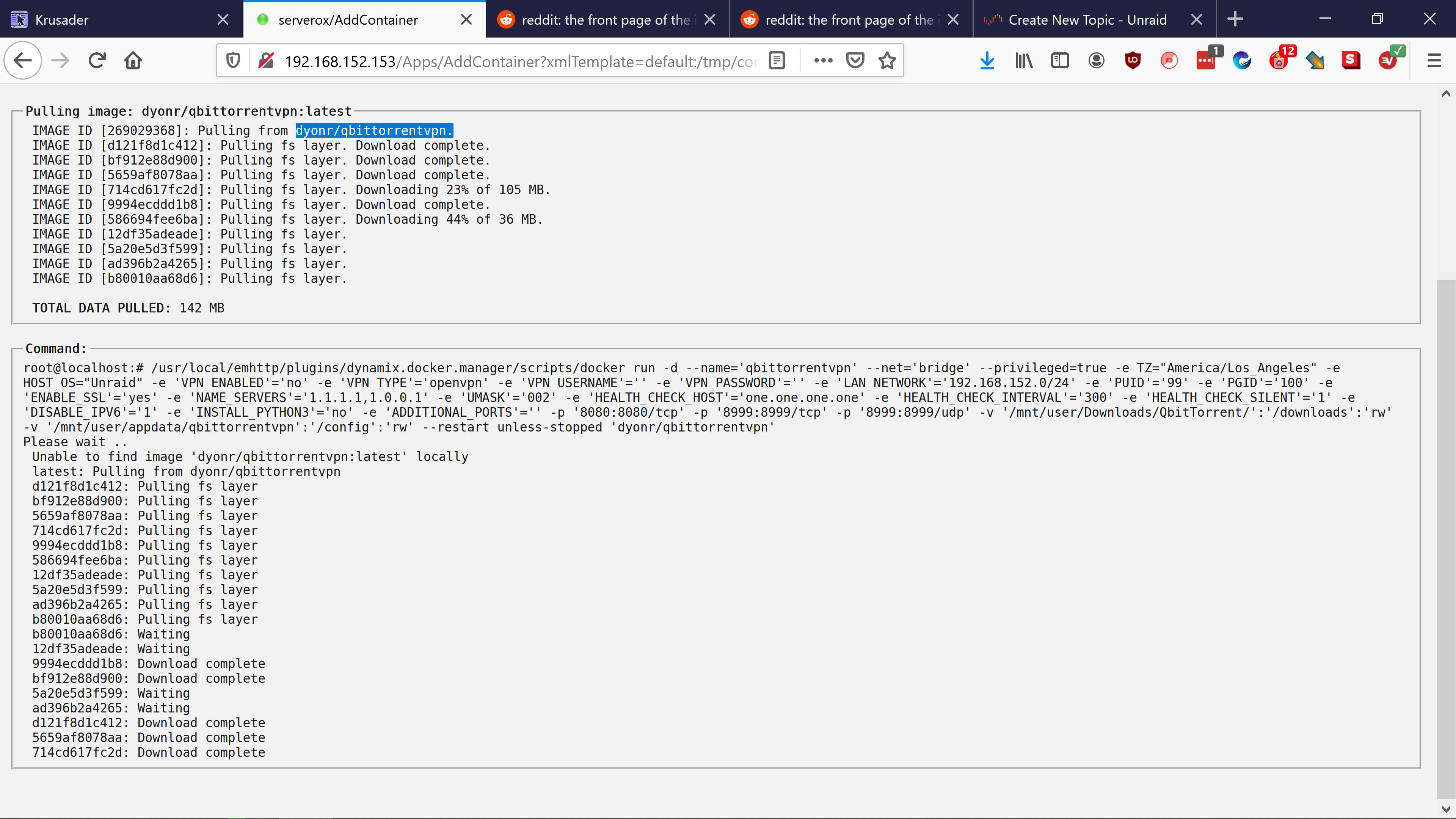

binhex-qbittorrwntvpn and dyonr/qbittorrentvpn both seemed to work fine but then the thing seems to hang....Clipboard-1.thumb.jpg.82e4be207c294a29c0167606e18ff6e5.jpg
it just seems to stop.. this is dyonr/qbittorrentvpn ....
How long do these things usually take.. I mean... an hour would be long enough right? The "moving dot" on the server tab in my browser stops moving...

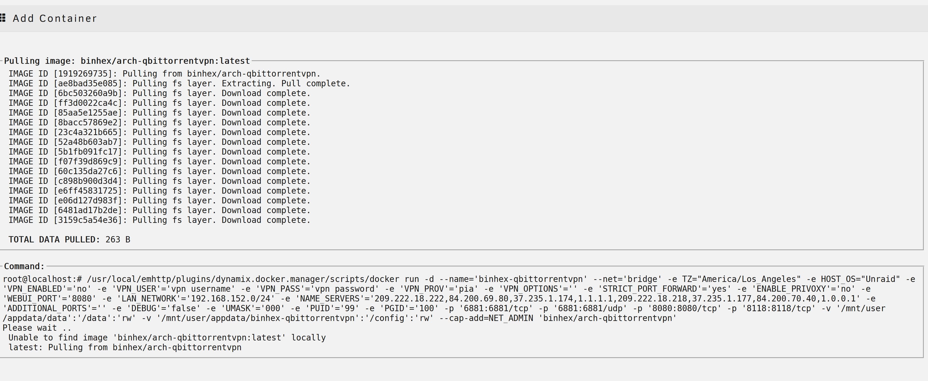

This is Binhex's one... stalled....

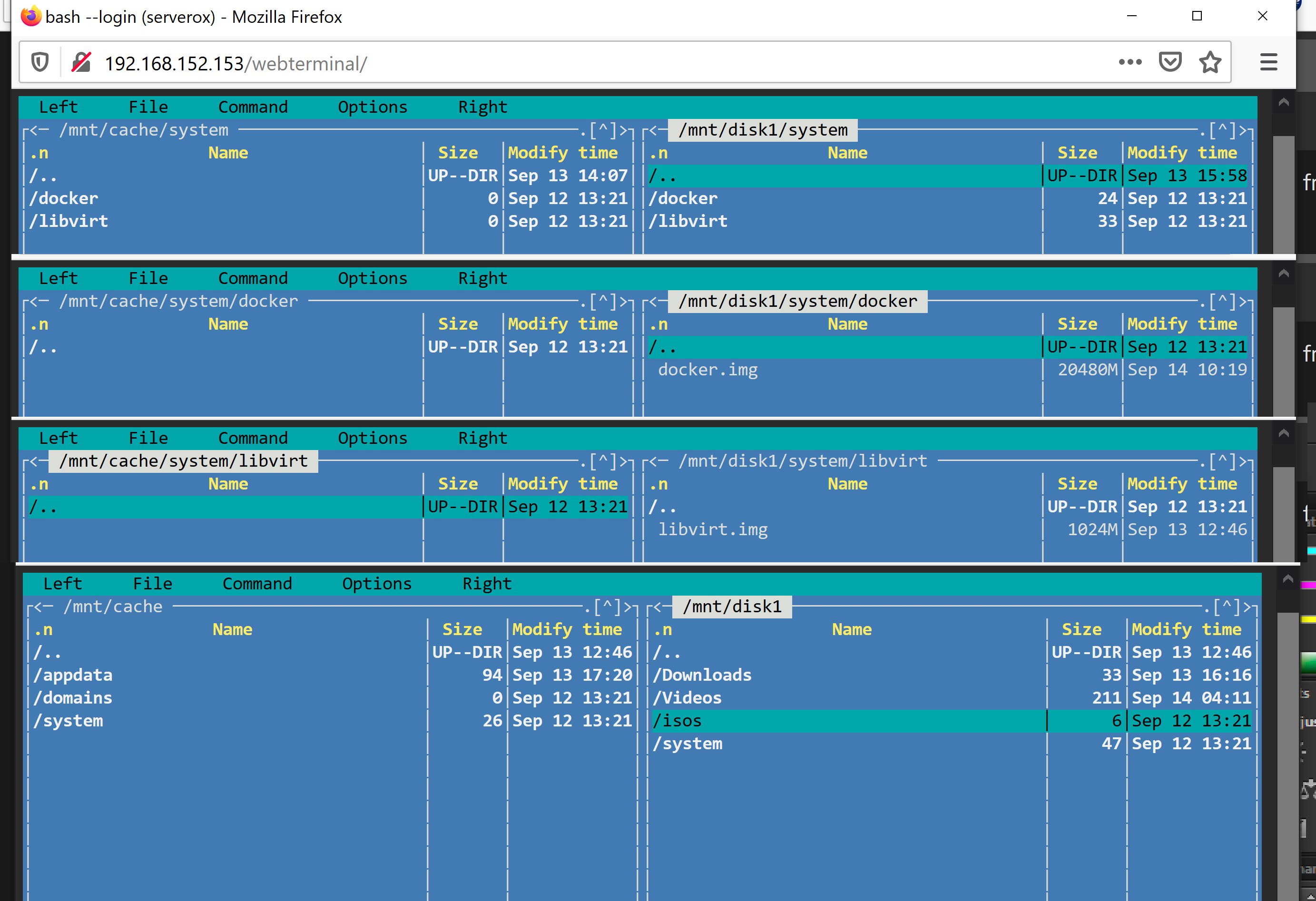

Compare the files at /mnt/cache/system and /mnt/disk1/system. It should be using those on cache.
In any case that isn't likely the reason for your problems, just something to make the general docker setup work better. If docker is using files on the array, those disks will keep spinning, and dockers will have performance impacted by slower array.
There are only files in Disk1... when I first started the array, I didn't have the cache enabled... is there a way to move all these files across? I also have  a empty iso directory on the disk 1 as well.
