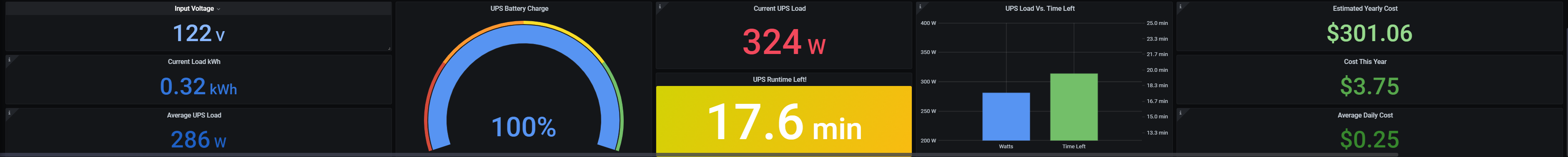

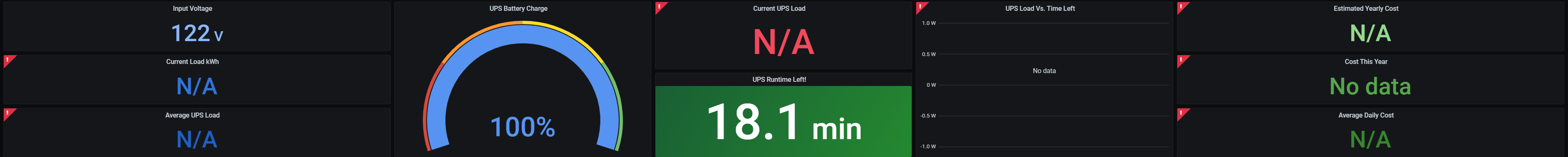

Hey @falconexe.  First off - thanks for the lesson on doing the cpu information the "old" way.  I explored doing that, but then I took the time to dive into the regex and it was ridiculously simple.
I also finally got back to the UPS portion and I did figure some things out with the UPS stats.  It seems that any panel that utilizes a variable is not getting parsed.  The variable doesn't seem to get included in the query.. for example in this query:
SELECT last("load_percent") * .01 * $upsmaxwatt/1000 FROM "apcupsd" WHERE $timeFilter GROUP BY time($__interval)
the "$upsmaxwatt" isn't getting passed, the query inspector shows "error parsing query: found /, expected identifier, string, number, bool at line 1, char 37".  This error is happening with each variable and I cannot for the life of me figure out why the variable isn't getting passed - they are all filled out.
For giggles I installed a different panel that includes UPS stats (Unraid System Dashboard v2 from @GilbN) and the UPS data on his works out of the box, and other than the variable names they appear identical in query structure.
Thoughts?  Anything else I can supply or look at to help figure this out?
Thanks!

27 minutes ago, falconexe said:
I'll look into it. I run the same code with those variables and my graphs display fine. It is possible that when I made the variable name change, there are lines of code remnants looking for the old variable. I am going to tear it down at the code level and look for anything weird in the JSON. I'll also branch this version and rename the variables and queries back to the original name to see if that solves it. Stay tuned.
@shwa87 So I looked at the code, and everything looks perfect. Everything acts correctly. Can you try putting in a different value in to the UPS variables (MaxWatts and kWh)? Save the dashboard, and then refresh? If it works, put the values back and save again.
The only time I have ever seen this is if those 2 variables are not set.
If I empty those 2 variables, this is what I see.
If I put them back I get.
If the issue persists, can you post a screenshot of your UPS section?
That did it. Changed values and it populated before I even saved.  I saved, then changed them back, and we're good.  THANK YOU!  Excellent product/design and amazing support.
FANTASTIC!!! Glad to hear it!

I solved my UPS issue. I realized I had a comma instead of a dot in the energy cost.
This is the correct way to do it in France and I just pasted it from my utility supplier. Now that I fixed it from 0,1557 to 0.1557 I am good on that front. ;)
I am sharing in case it can help others.

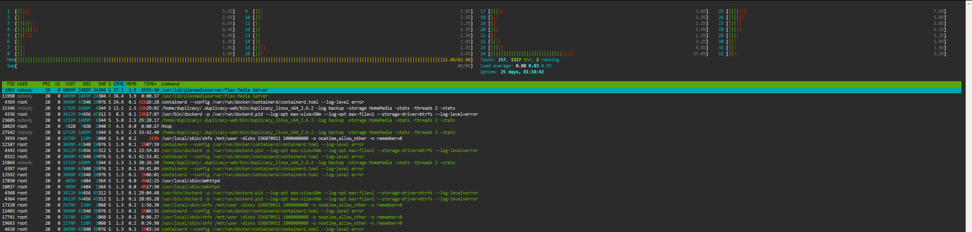

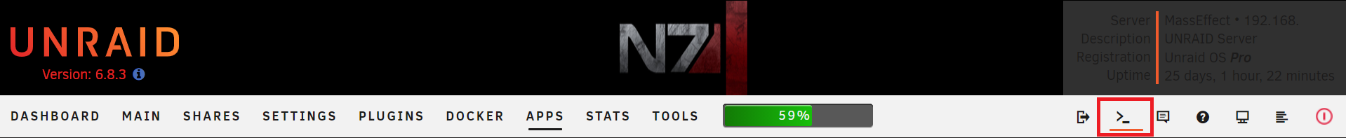

1 hour ago, SPOautos said:
Awesome looking dashboard! I just downloaded the app, I'll try to figure out what all I need to do tomorrow to get it going.
On a side note, with CPU usage, is it possible to see what all is running and how much CPU each is using? (kind of like how Win task manager does). There are times where my CPU usage gets kind of high but I have a lot of things going and not sure which one is running up the resource usage.
Excited to get this setup, looks great!
That not I am aware of in Grafana. But what you are looking for is call HTOP. Click on the terminal and type it in.

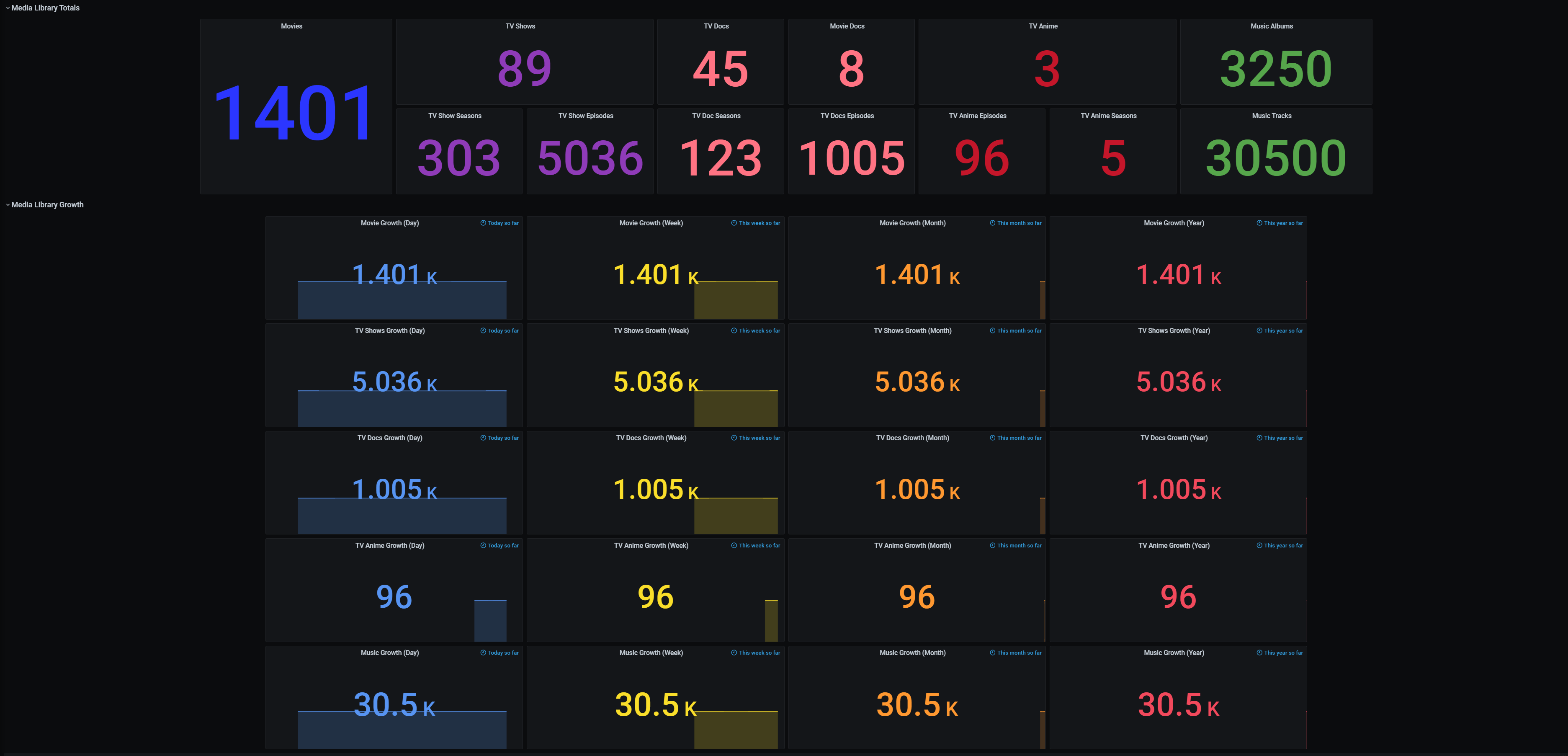

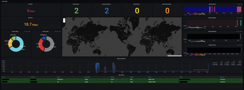

I've been working on both 1.4 and 1.5 simultaneously. They will still be released separately, but the code overlaps in some areas, so I had to figure some of it out now.
Goal is for a super clean and refined Varken/Tautulli/Plex Dash which will be integrated directly into UUD, sporting some of the same falconexe style/customizations (like working growth trending) found in the UUD.
@Stupifier Thought You Would Appreciate This Sneak Peek...
Edited by falconexe

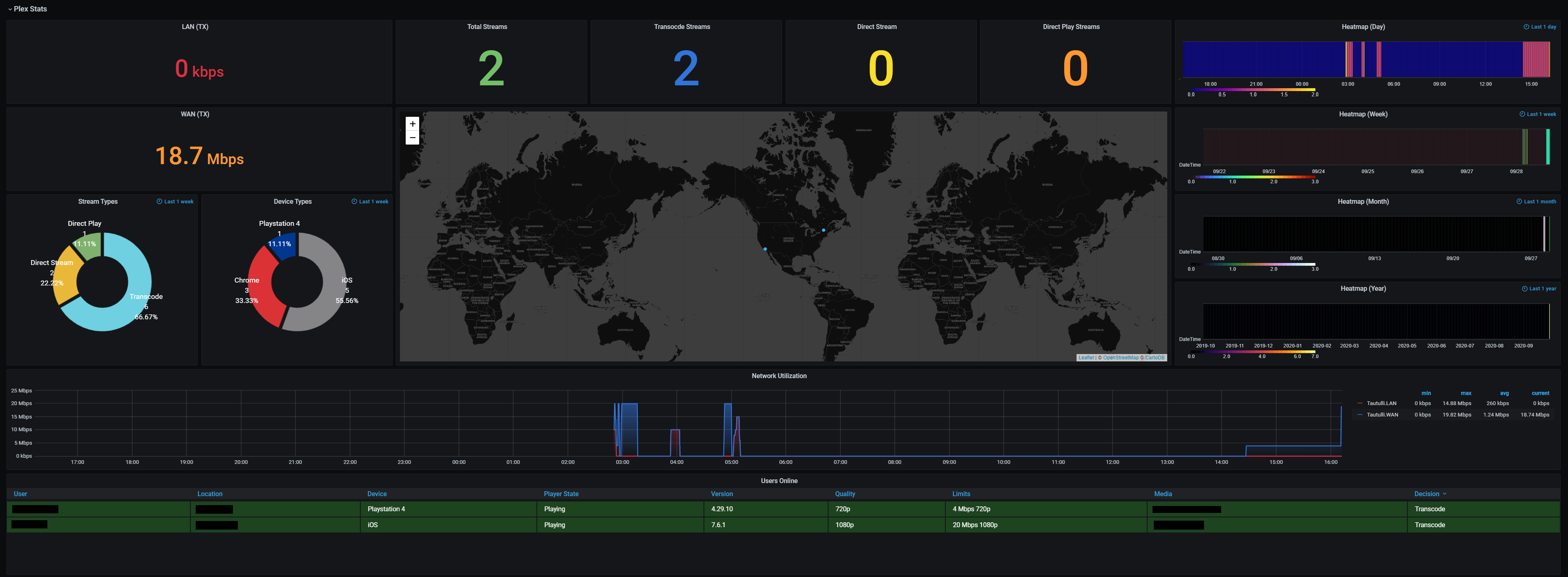

Looks awesome man!!!!

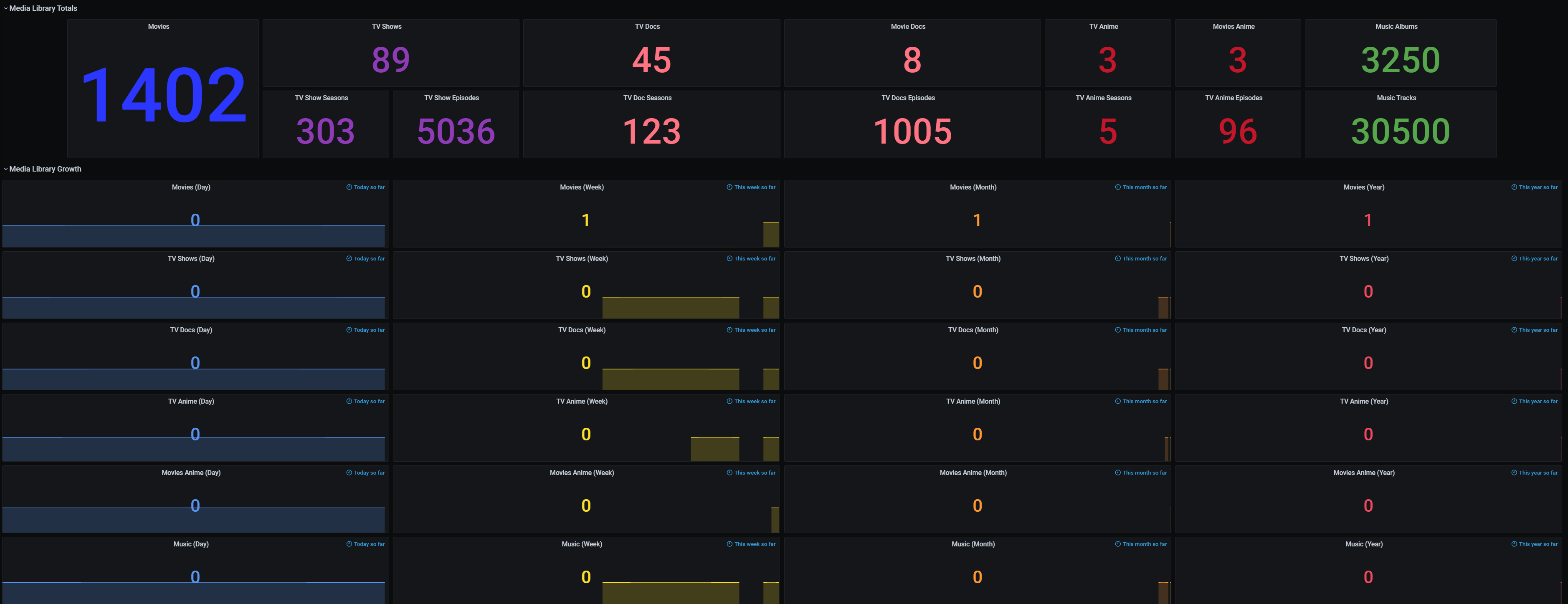

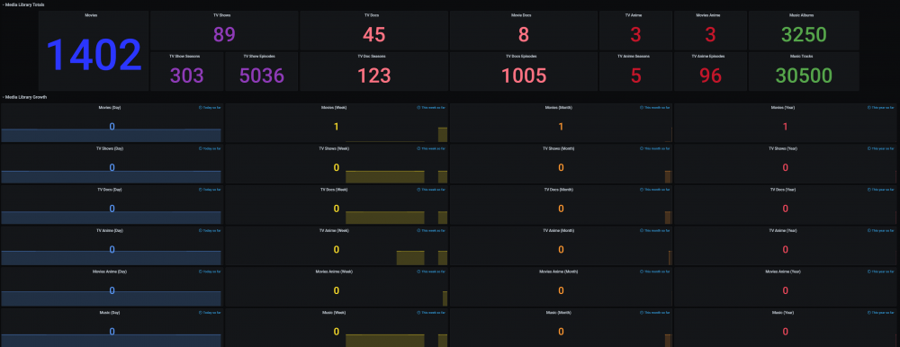

Here's the latest on that bottom section...
Edited by falconexe
looking fantastic, somehow 24" inch screen seem soon too small, I wonder if you got it correct with your 43" screen.
Glad you like it.
Click the pic for full rez. It is in 4K.
Edited by falconexe

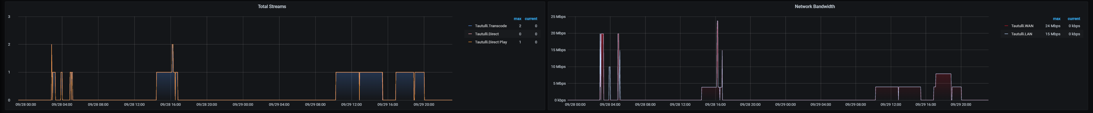

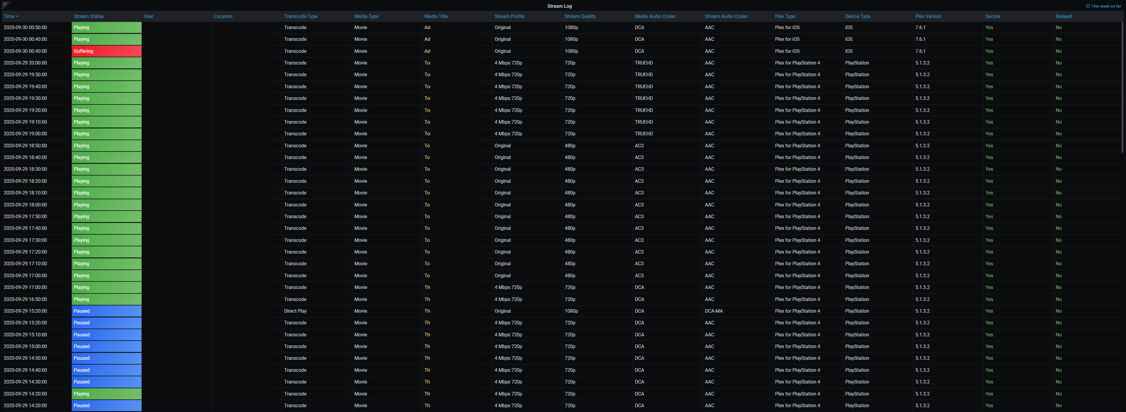

Correlating Varken graphs showing network utilization and total streams. Very interesting...
This is what I worked on tonight.
Fully Custom table displaying Plex streaming log every 10 minutes going back 1 week. Custom overrides, dynamic colors based on stream metrics, and much more. Want Unsecure Streams highlighted? Done. Want Relayed Streams brought to your attention? Done. You won't find this in any other Varken Dashboard!
