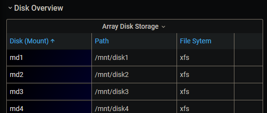

How do I adjust individual column widths in the data tables? As you can see here, there's a lot of empty space that could be eliminated. Since we don't all have 4k monitors, there just aren't enough pixels on the screen to display the data without a lot of horizontal scrolling.
This is the top of the "Array Disk Storage" listing, and there is essentially no interesting data on it without scrolling:
I tried adjusting column widths once, but it ended up rearranging the columns and totally mangling things - there must be a better way that what I was doing!

Go into the query and place a column width override on each field as you see fit, then save.

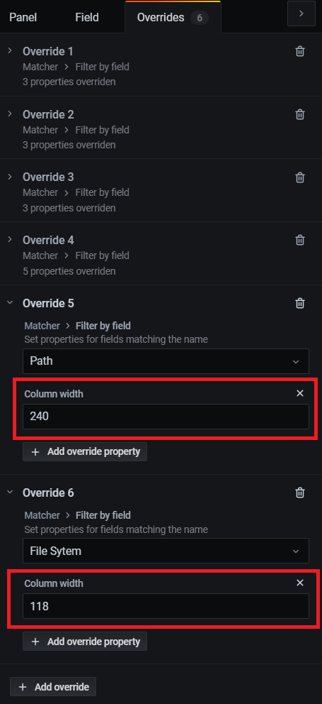

@FreeMan Here is a screenshot. Overrides are on the right side when you "Edit" the query.

Ah, that makes more sense.
For some reason, it took me a while to find that right-side panel. I'd been looking for things you'd been telling people to do, but I couldn't find the options you were talking about. I stumbled on it a couple of days ago. It's much easier to tweak things now!

Glad you found it!

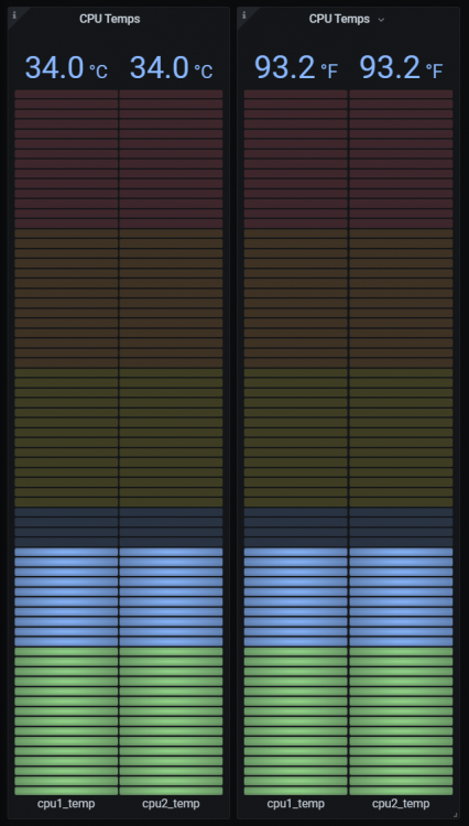

I've noticed that there really isn't an easy way to get Fahrenheit scales to work as well...  I can live with Celsius though...

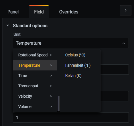

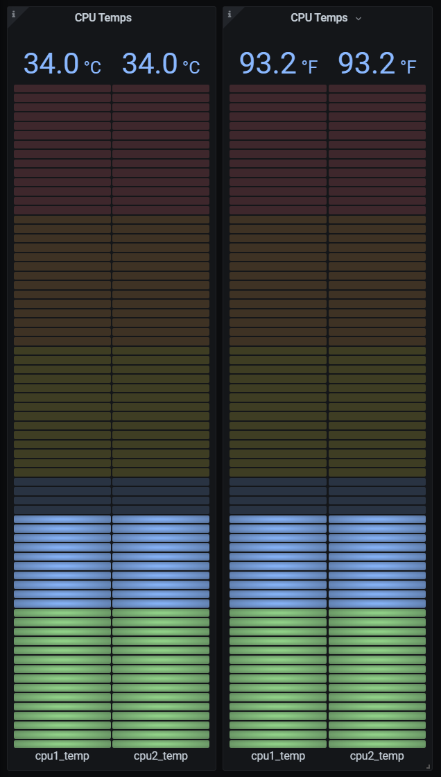

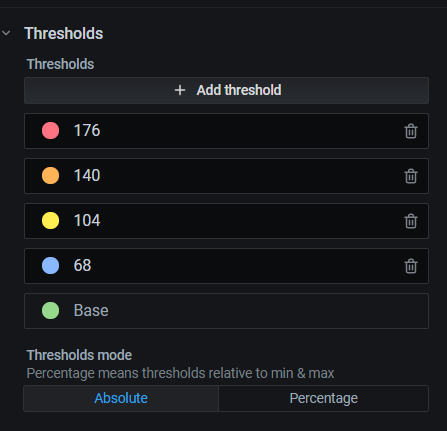

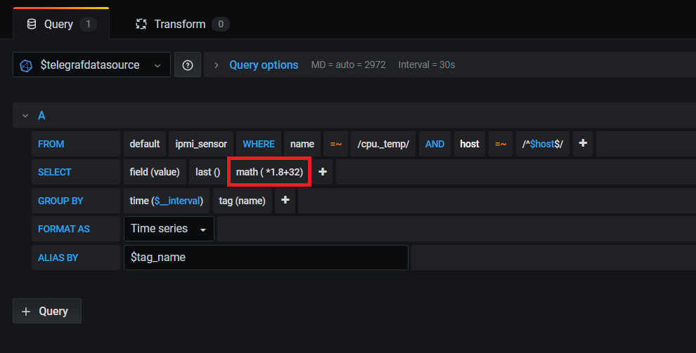

I haven't tried this yet, but you can always slap a MATH function (F = 1.8*C+32) on a Celsius query and then change the datatype to Fahrenheit with an Override. Once I get some time, I'll give this a shot. This is very easy to do though.
Edited by falconexe
@danktankk Ah what the heck. I'm in a good mood. Here you go.
Just add MATH to your select statement and punch in ( *1.8+32). Then go over to the right panel and set the UNIT to F. Then finally, adjust your Thresholds to F values (colors).
Side By Side:
Edited by falconexe

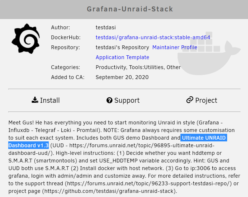

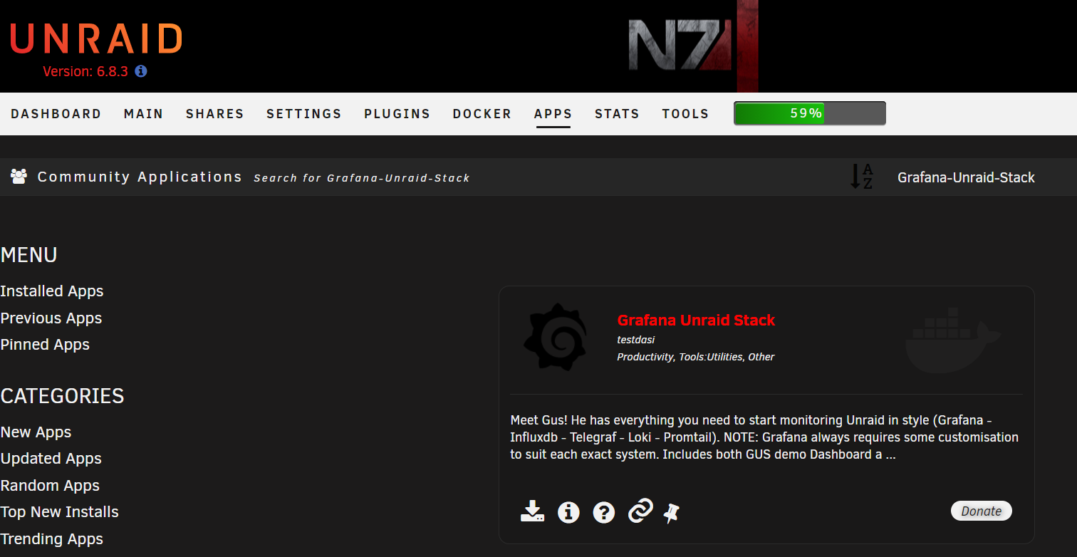

@SPOautos You can also give the Grafana Unraid Stack (GUS) a try, which is a single docker that installs all 3. It also comes preinstalled with my UUD 1.3. You'll still need to perform the configurations on Page 1, but that would be a huge start for you. Check out Post 1 for the the link...
Edited by falconexe
Thanks...
You can download GUS from the Apps section of the UNRAID GUI.
@SPOautos I also STRONGLY suggest you read 👉THIS👈 ENTIRE forum topic as A LOT of tutorials, tips, tricks, guidance, and direction has been included with detailed screenshots.
Finally, you should also check out GilbN's Tutorial here for a good foundational knowledge of what UUD is and how it works.
https://technicalramblings.com/blog/how-to-setup-grafana-influxdb-and-telegraf-to-monitor-your-unraid-system/
The UUD family has been great! We're all here for you and will get you up and running!
Okay, this may be part of the confusion. The one you mentioned...."Grafana Unraid Stack" is actually the one I installed.  So since I installed that one, I do not need to install the others nor your download....its all there in the one package correct?
I'll swing on over to that thread too and check it out now that I see it has a separate support thread for it.
The UUD is ONLY a dashboard that can be imported into Grafana. You still need to configure Telegraf's Config File, download/install Telegraf Plugins, etc.
Let us know if you get stuck anywhere. You got this!
And correct, you do not need to install the 3 dockers or the UUD version 1.3 since it is baked in. GUS is a one stop shop for the prerequisite apps you need.

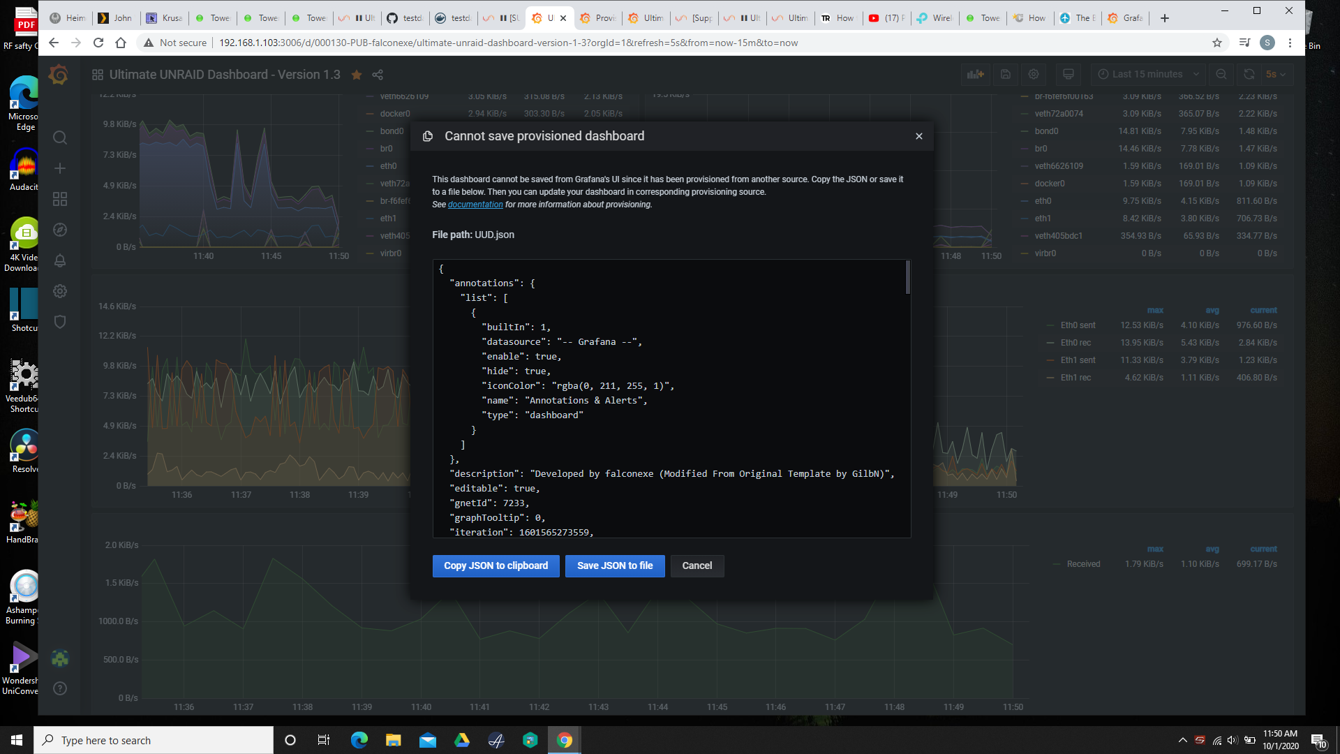

Okay, I think I have everything working good. There are some data streams not showing up that I need to address but most of them are working fine. I  made sure all the drop downs at the top of the dashboard have the correct data in them.
Just to clarify, if I make changes like edit a data stream or add one, ect that change will be lost if I close out the browser tab then later go back to it unless I go through a process where I save the JSON file.  In this image, do I need to just click "save to file" or do I need to "copy to clipboard" then reimport it or something like that?  I'm making changes and just want to make sure I dont lose them.

Nope. Just click the save button in the upper right any time you make a change.
