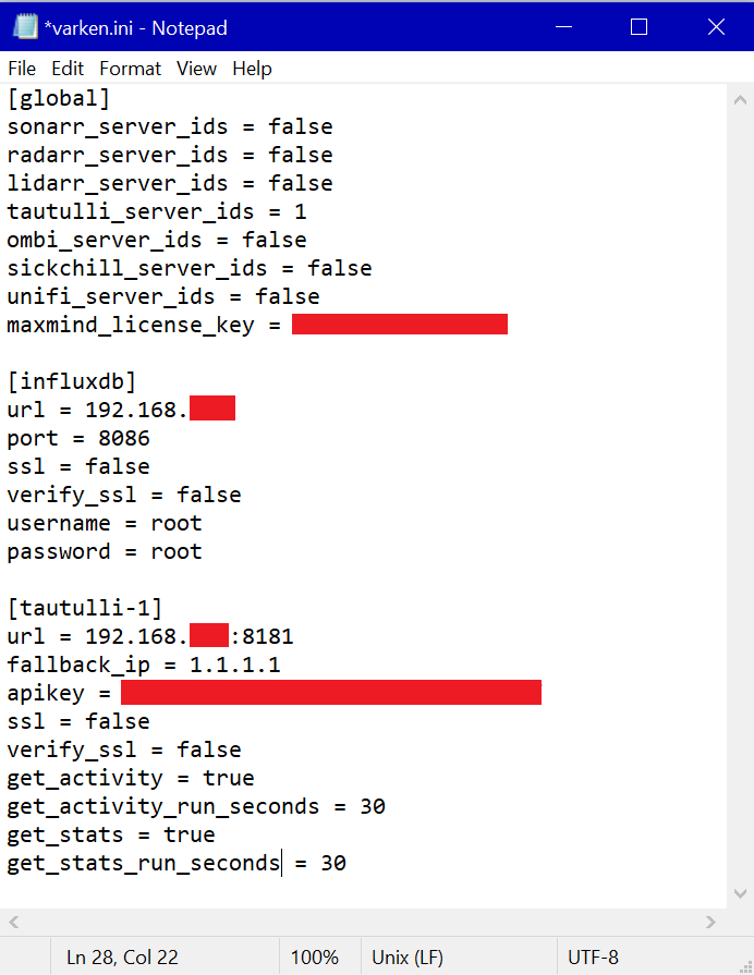

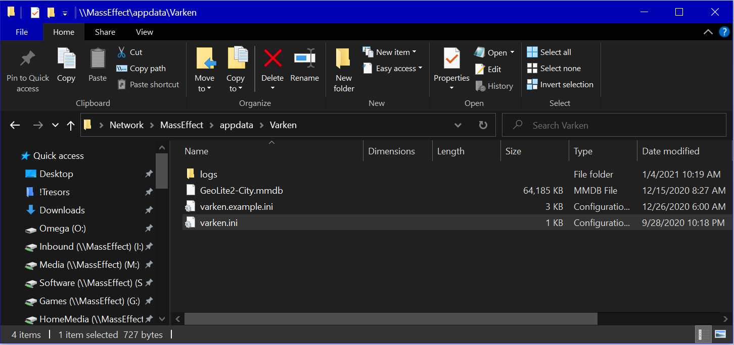

Here is my Varken Config (ini File). I have redacted it of course. This is a streamlined version which removes everything from Varken except Tautuilli for Plex monitoring. You'll notice that the other services are set to "false".  Adjust everything in RED for your server including IP addresses, KEYs, and Passwords. This should be placed in the following location:
Path: \\YourUNRAIDServer\appdata\Varken
File Name: varken.ini
FilePath: \\YourUNRAIDServer\appdata\Varken\varken.ini
[global]
sonarr_server_ids = false
radarr_server_ids = false
lidarr_server_ids = false
tautulli_server_ids = 1
ombi_server_ids = false
sickchill_server_ids = false
unifi_server_ids = false
maxmind_license_key = abcdefghij12345678910 <<< Put Your Max Mind Geo Mapping API Key Here
[influxdb]
url = 192.168.###.### <<< Put Your InfluxDB Docker IP Address Here
port = 8086 <<< Put Your InfluxDB Docker Port Here
ssl = false
verify_ssl = false
username = root
password = abc123 <<< Put Your Password Here Or Use the Default of "root"
[tautulli-1]
url = 192.168.###.###:8181 <<< Put Your Tautulli Docker IP Address/Port Here
fallback_ip = 1.1.1.1
apikey = abcdefghij12345678910 <<< Put Your Plex/Tautulli API Key Here
ssl = false
verify_ssl = false
get_activity = true
get_activity_run_seconds = 30
get_stats = true
get_stats_run_seconds = 30
Here is what the INI file looks like (redacted pic):
Here is what the Varken appdata folder should look like once everything is working.

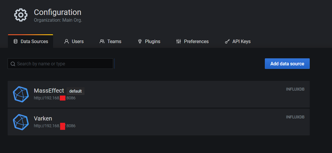

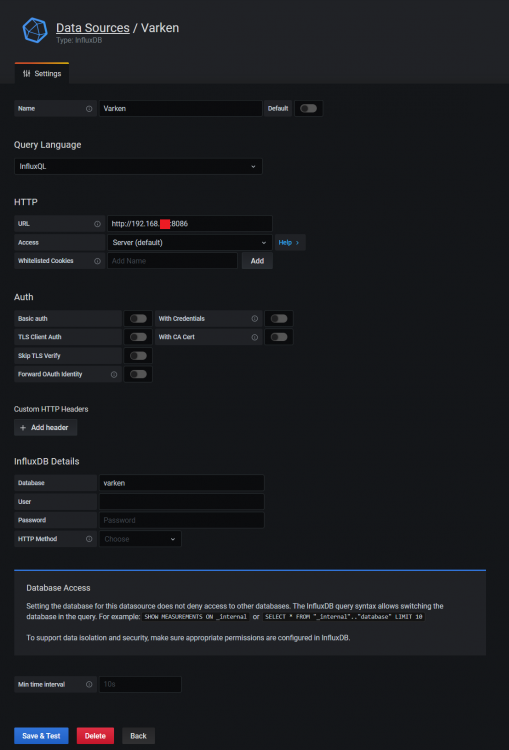

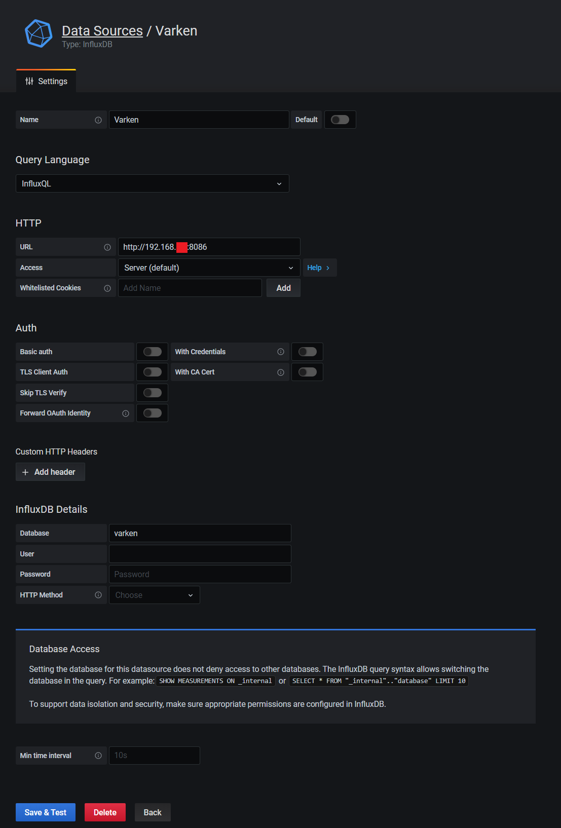

Here is another key element to the UUD Version 1.5. This new datasource should have been created WITHIN GRAFANA if you follow Varken's default installation instructions. However, I thought it would be helpful for everyone to see it!
NEW DATASOURCE FOR THE UUD 1.5 (VARKEN):
Once setup, you should see 2 datasources. The default one we used for UUD 1.4 and prior (yours may be named differently than mine), and the new one named "Varken" which will be required for UUD version 1.5 onward if you want real time Plex monitoring.

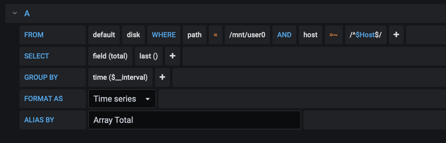

3 hours ago, RockDawg said:
1.4 and 1.5 give me some issues that 1.3 doesn't.  Most of the array info panels just say No Data but they work on 1.3.  When I look into it the differnece seems to be that 1.3 references path=/rootfs/mnt/user0 whereas 1.4 & 1.5 references path=/mnt/user0.
My question is why the change and why doesn't it work for my system but apparently works for others?
Yeah I made that change based on personal expereince/feedback/DMs that others were saying it would not work with the Root File System. Mine will only work with rootfs omitted, and "rootfs" does not show up in the Grafana dash within the path tag drop down menu. I have not spent the time looking into the differences with invoking the rootfs prefix or not. I suspect it gets invoked behind the scenes if you start with mnt while in UNRAID, as it is implied perhaps as a global variable/reference, where Grafana does not like it in some situations.
Furthermore, the user vs user0 debate is the same deal, regarding those that use cache Vs. not cache. I went with assuming users have cache using /mnt/user0 in UUD (excludes cache) and they can change the path if needed to /mnt/user which includes all disks (no cache).
Example Looking At Array Growth:
  • Cache Present = TRUE
    • Then use /mnt/user0 to exclude cache and only get actual array disk (non cache disk) growth.
  • Cache Present = FALSE
    • Then use /mnt/user to include all disks, as cache is not present, and the user0 path does not exist.

The UUD instructions state that users must configure their dash for their system. However, I want to find that sweet spot where most everything works out of the box. @GilbN any thoughts here? Any REGEX we can leverage to look for both rootfs and/or mnt? Like a version of the code where it works for all scenarios? Perhaps you have already figured this out...
Edited by falconexe

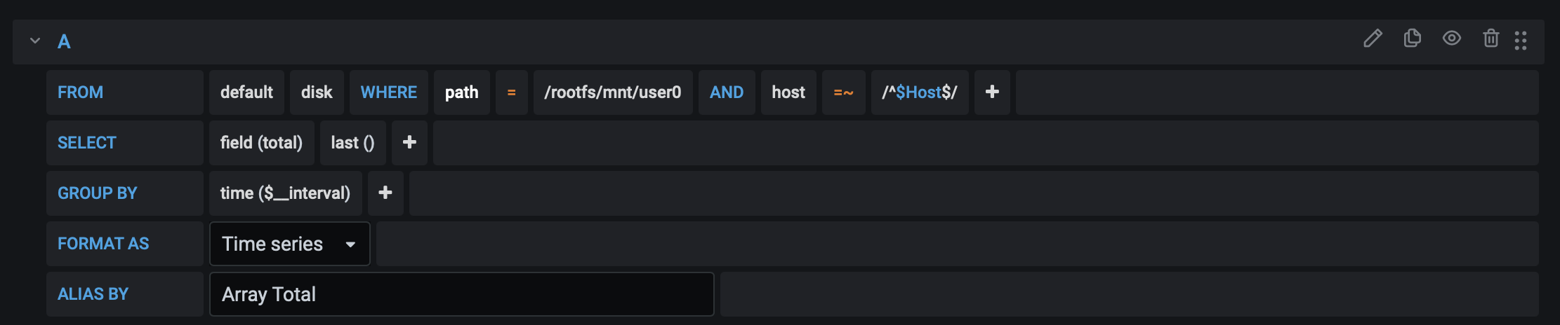

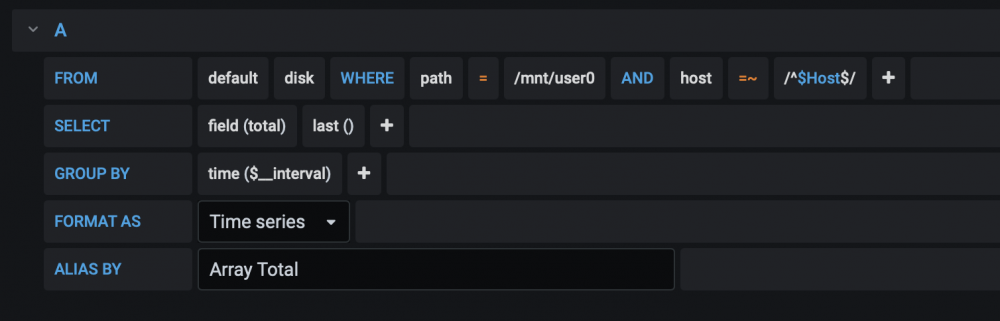

@GilbN - Yes, your dashboard works.  I knew the difference between user and user0, but what is the difference with rootfs vs without?
@RockDawgI think i saw you're the GUS docker for your Grafana? I believe when I setup Grafana on my server to test a while back, i used the standalone docker and those I had to manually configure the paths i wanted (/mnt/user or /mnt/user0 or /) for the container. When I started messing with this dashboard, I installed the GUS docker and in that / is mapped to /rootfs/ for the container.
Not sure if that kinda of answers/helps you with anything but I can say, you aren't alone. The array stats didn't work for me either I had to go in and adjust the panels to point to "/rootfs/mnt/user0"
Ah that makes COMPLETE sense now. Thanks for pointing this out!
People using GUS have a different hardcoded path due to using the all in one package (which testdasi set in the GUS docker parameters), whereas most UUD users, including myself, who use the standalone dockers, it just works as currently coded.
I’ll add Gilbn’s trick to a development panel, and then I’ll need some people to test the dev code on GUS. If resolved for both flavors of docker setup, I’ll release the fix officially in UUD version 1.6.
