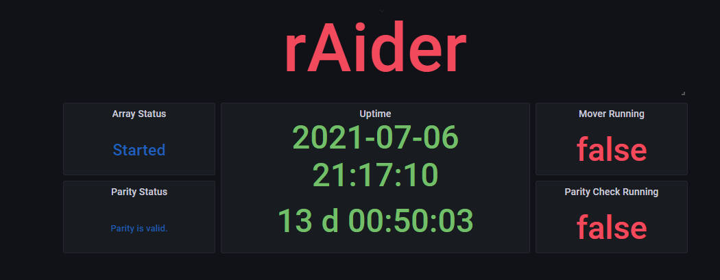

I've just noticed an interesting inconsistency.
As reported by the WebGUI:
As reported by UUD:
I know that the UUD is only refreshing every 30 seconds, but trust me, my system is NOT capable of writing 62GB to the cache drives in 30 seconds.

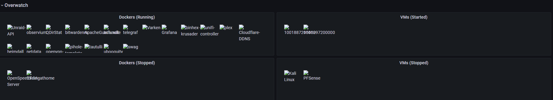

did anyone figure out how to fix this?. i´ve seen a few more have this problem.

i´ve read all of it. i understood it like it still does not work properly for most people. thats why im asking. i could not get it to work as well 😕

11 hours ago, hogfixer said:
My problem with this was fixed by editing the following.
Assuming you have the Dynamic Image Panel plugin installed and unblocked.
Check the base url in the Dockers (Running) panel.  (see attached)
The http or https needs to match the setup for the API docker container.
If it says http, change it to https and see if that works.
If it does, you will need to change it in each panel, Dockers and VMs.

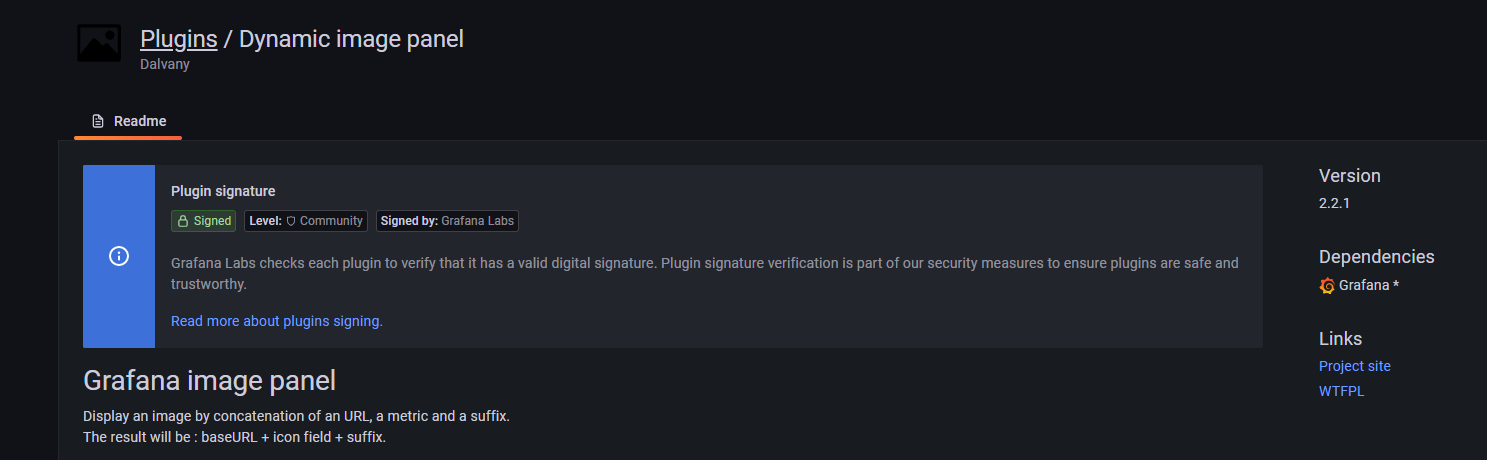

thanks for the tipp. what do you mean with unblocked? i´ve installed it over CLI. how can i unblock it?
And since its a docker and uses the same IP as my Unraid Server but with a Port do i need to put the IP + Port in that field?
No you do not need a port number.
The important part is http or https.  I assume you are getting some data from the UnraidAPI?  Does the array status panel show Started?

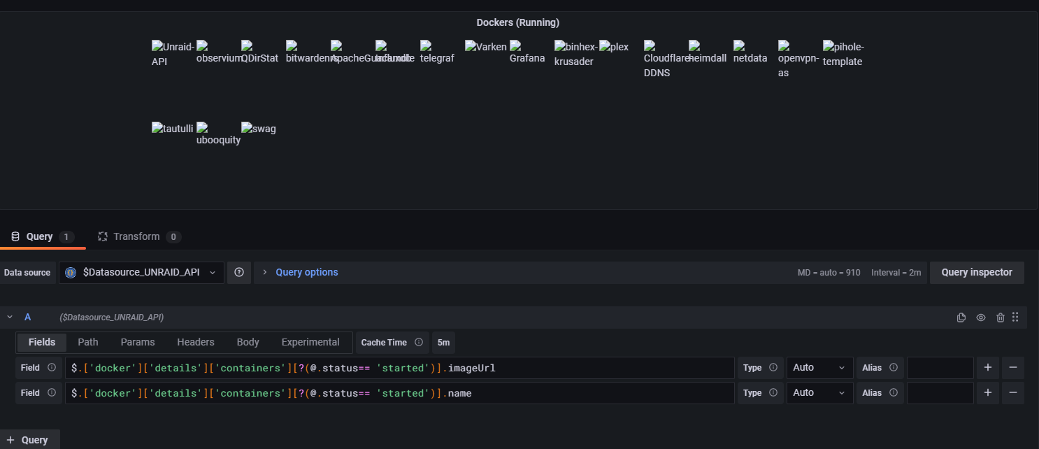

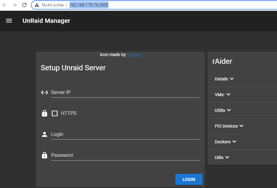

Yesterday when i checked the Dynamic Image Panel plugin in Grafana, it said it wasn't loaded because it was unsigned.
Check the plugin tab of Grafana for the status of your plugins.
IF it was not loaded by Grafana, you will need you add a ini file.
I created a conf folder in the Grafana app folder.  Next create a file called custom.ini.   In the custom.ini file add the following:
[plugins]
allow_loading_unsigned_plugins = "dalvany-image-panel"
Save it.
You will need to restart Grafana for it to be loaded
After doing the above, i did not need to open the icons in another tab or log into the server again.
Edited by hogfixer
[plugins]
Save it.
yes the api is working. it says started. i only have the problem with the images.
it looks like the plugin is loaded to me.
i used the IP of the Api plugin docker without the port, wich is basicly the IP of my unraid server...
but as you can see its not working.
do i still need to creat the folder and the file as you descriped?
do i still need to create the folder and the file as you descriped?
No you do not.
You could try changing the IP address from http to https and see if that works.

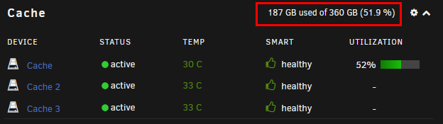

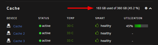

On 7/3/2021 at 11:38 AM, falconexe said:
Check Your timeframe in the upper right. Set it to the last hour and see if it changes. When is your mover running?
Note: If you are using cache pools, then you’ll need to explicitly modify the query to account for all cache drives in the pool that makes up that instance of “Cache”.
Also, to remove the second image on your post, you need to delete the second (or all) of the attachments in the post of that image. If not, it will stick the dupe on the end… Once they are all deleted, save your post. They should now be gone. Edit it again, upload the single photo, stick it where you want it, then save.
This had, initially, fixed the display issue. However, it's back.
These were from yesterday:
image.png.58cbbab13f7fbba47e4784c420208212.pngimage.png.73fcb900483d24df228892ec2d9a7132.png
And this is from this morning:
image.png.82bcac160a1c0c5ee95bb2fc29c79008.pngimage.png.120c2a994d33dd9e2d129f3698b8a7c9.png
No amount of adjusting the time frame will cause the Grafana reported utilization to get back in sync with the WebGUI.
To address the other issues noted in your original response:
* The mover is running at 01:10. It is currently 06:56, it's long since completed its task, the first shots were from sometime after noon yesterday
* As noted previously, the query is pulling `"path" = '/mnt/cache'`. If you have a specific recommendation on how to modify it to pull in the 3 individual drives that make up the cache pool, I'll be happy to make that mod to see if it makes a difference.
I suppose this isn't critical, as UUD is a nice addition, and I'm relying on the WebGUI being accurate as the last word, however, it's mildly annoying. I'm willing to test out suggestions, but I'm not going to be heavily digging into finding a solution myself.
I'd like to say that this is a recent change (though I don't believe I've changed anything in either my UNRAID or Grafana setups that would have caused this), but it may well have been off from day one and I just never noticed. Out of curiosity, I just loaded UUD v1.5 and it is reporting the same incorrect number that v1.6 is, so this is probably nothing new.
Just for fun, today, the Cache Utilized Percentage is almost right, but the actual amount used is off.
175GB out of 360 is 48.61%. 147GB out of 360 is 40.83%. So either the math is wrong or it's not finding all 360GB of available cache space.
