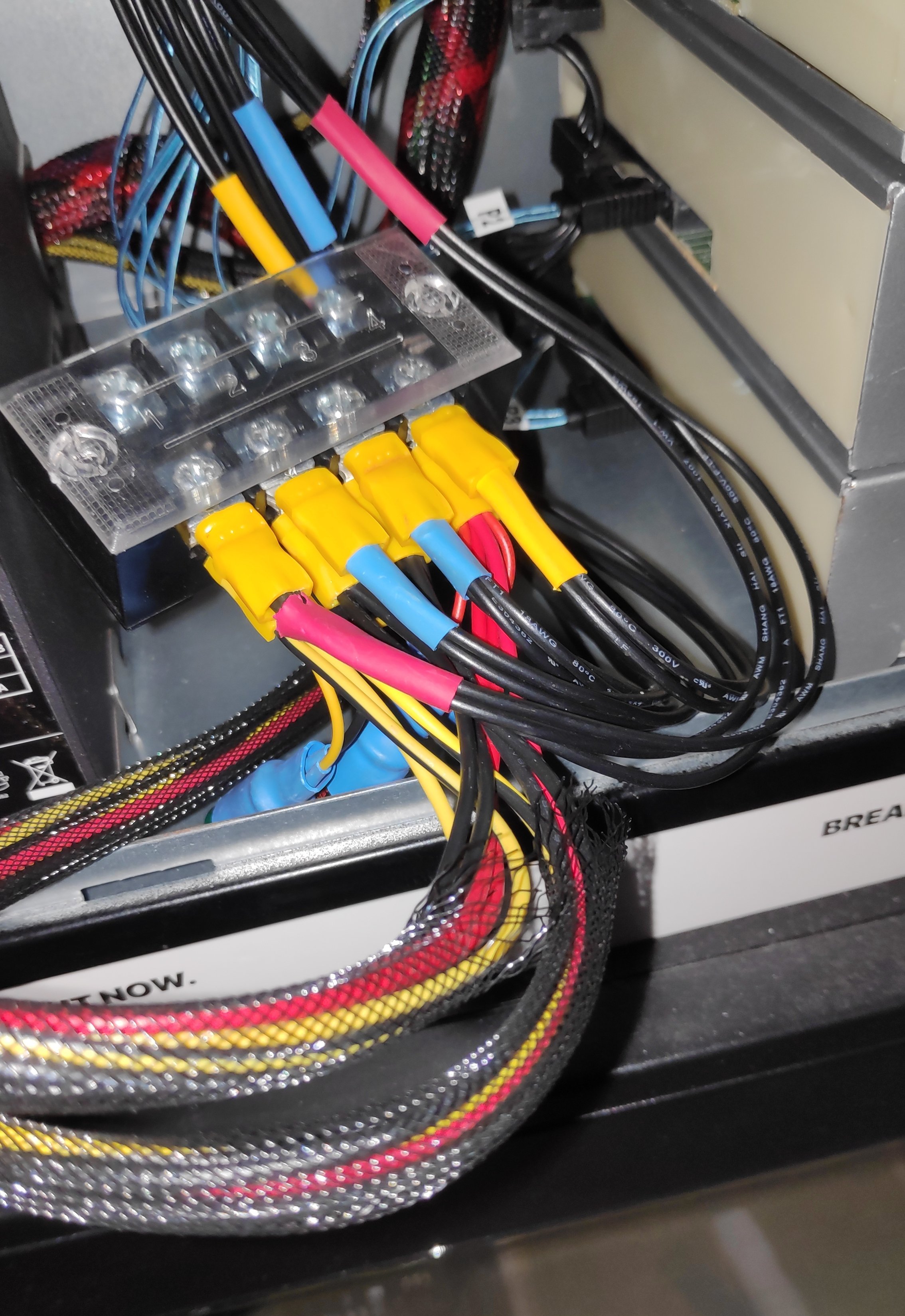

I have two Seasonic focus+ PSU, both perform excellent, CPU power cable have capacitor at mainboard end, so you can't bend at that region.
As you plan using SATA power spliter, due to SATA have 3.3v, WD disk could be in disable state. This is not the fault of PSU or splitter, you can cut the orange wire at splitter for fixing.
From my experiences, SATA power plug have better connection then molex plug, but it also more easy to burn out and cause trouble. The best solution is you build disk power delivery system.
I always DIY
