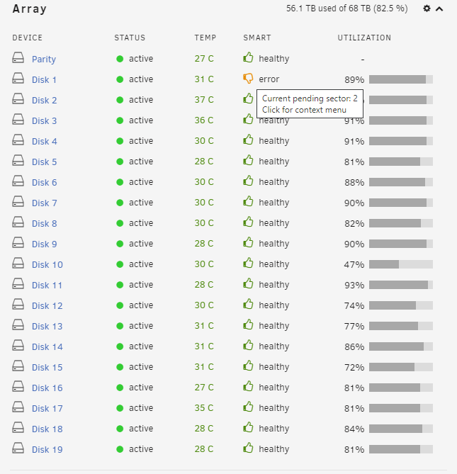

This morning it happened again within minutes of the parity check starting, this time with UnRAID claiming there are 2 pending sectors:

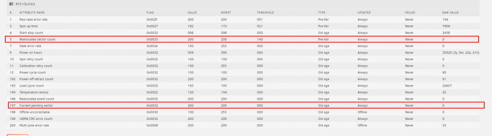

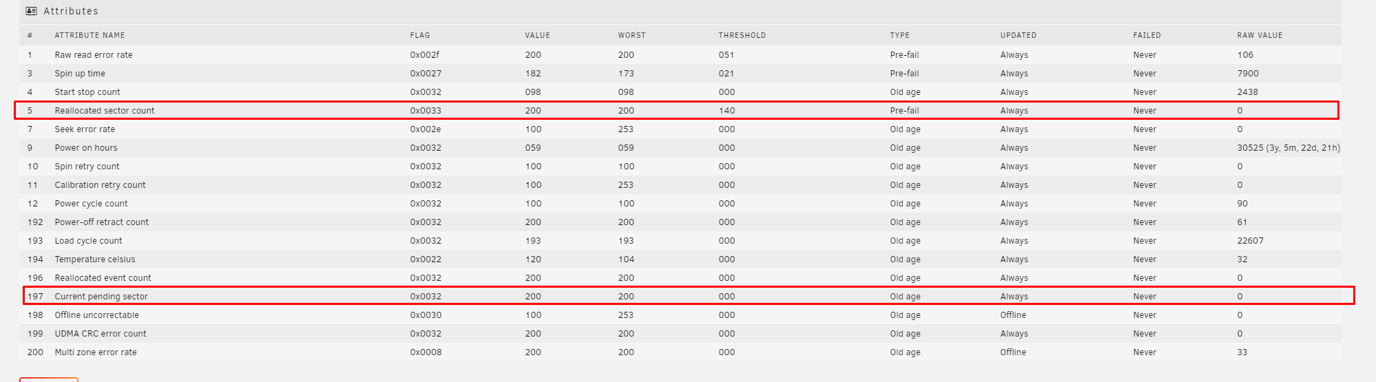

However when I go to look at the drive stats in the context menu SMART doesn't report any pending or reallocated sectors??

EDIT: "solved" per say. I know the drive is dying though I do find the ghost re-allocated sectors reported strange. I have a new one on order.

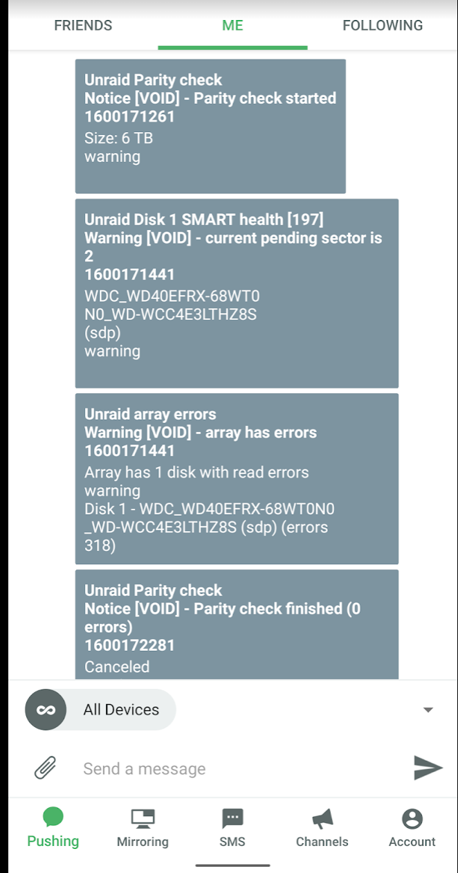

Nope, I got two notifications from UnRAID, one about the read errors and a second about the 2 pending sectors. I went to check the SMART stats and saw the discrepancy, canceled the check and shut down the server to swap the disk with another.
The diag file posted above is from before I shut down the server and after the alerts were generated.

Pending sectors are considered 'suspect' by the drive.
If the drive subsequently reads OK from them, the pending count will reduce, effectively they will disappear.
If the drive continues to be unable to read from them, they will be remapped. In this case the pending counter is reset to zero and the remapped counter incremented.
 Looks like your drive is starting to fail, but not consistantly enough for the drive to remap the sector as yet.
