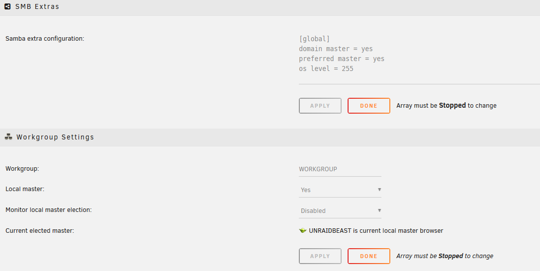

September 16, 20206 yr Community Expert OK first thing, is your Unraid server the Local Master? What happens when you enter the following on the Address bar on Windows Explorer (Window s file manger)? \\192.168.1.17 Di you look at the Link that @trurl provided in his post above? Read the first couple of pages and make sure you try those suggestions in your setup. Then go to the last page and work backwards. SMB problems are seldom ever simple to troubleshoot and fix. As I have mentioned many times, SMB is more like witchcraft than science....
September 16, 20206 yr Author Hey Frank, thanks for your reply. See below Local Master info: inputing \\192.168.1.17 in file explorer brings up the same error message. I did look at @trurl link provided above and tried many options. I will give it another stab and see what happens. This witchcraft is driving me insane. I should mention that I have zero issues accessing my Unraid server from my Mac device. Completely simple plug and play. I wish windows would fix this. -Thanks

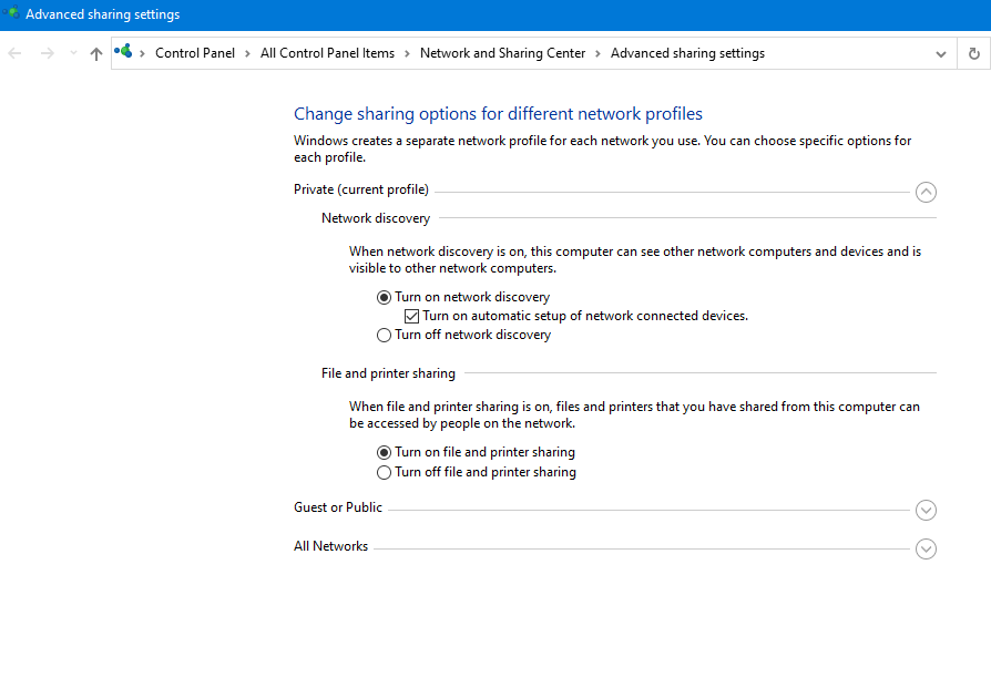

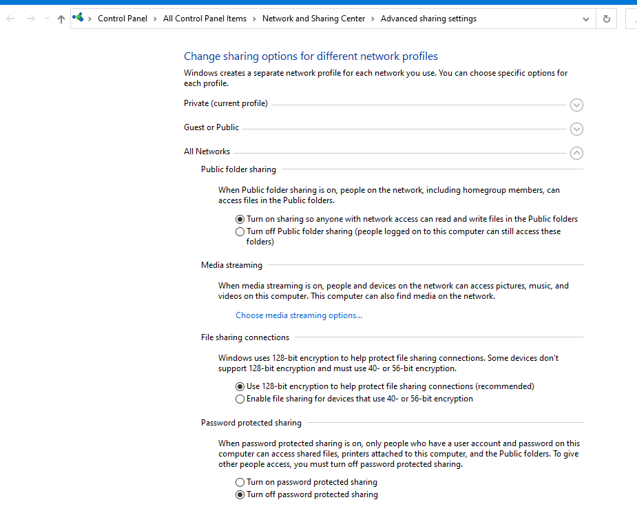

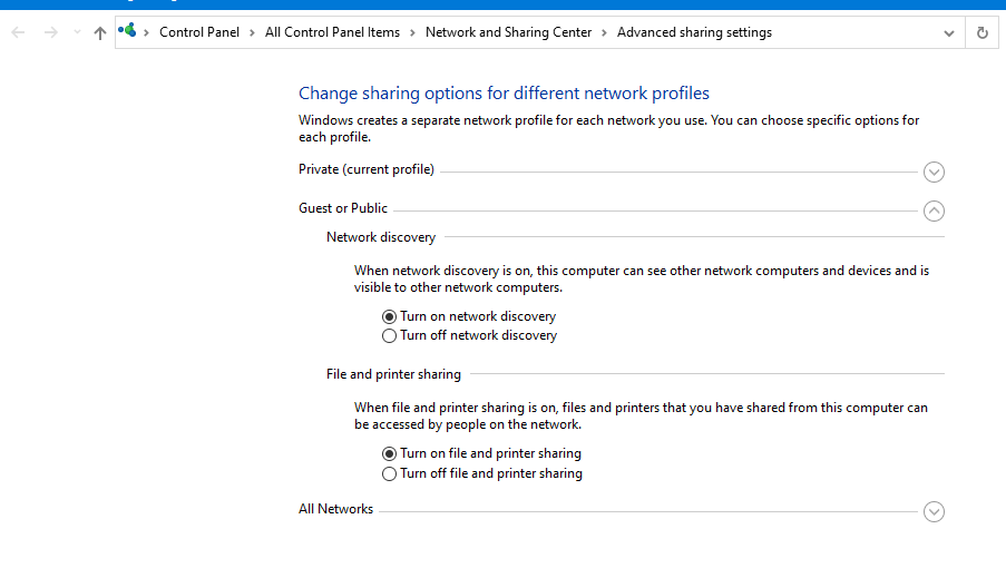

September 16, 20206 yr Community Expert Make sure you have these settings: and and the last one Note each setting before you change them. Later if you want to tighten security up you can go back and do so one at a time. I know it looks like some of these only apply to the client PC but it seems like some of them also apply to any client/server you try to access.
September 16, 20206 yr Author I have confirmed that all settings listed above is what I have set in my client, however, the access error is still persistent.

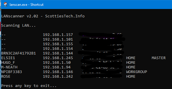

September 16, 20206 yr Community Expert One more thing you can try. There is a program you can run on your Windows computer that will scan the SMB network and show what your PC is 'seeing' is on it. You can find it by goggling: LANscanner v2.02 The name of the website is Scottie's Tech.INFO As with all Internet downloads use due diligence on checking things out. The output will look like this:

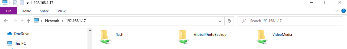

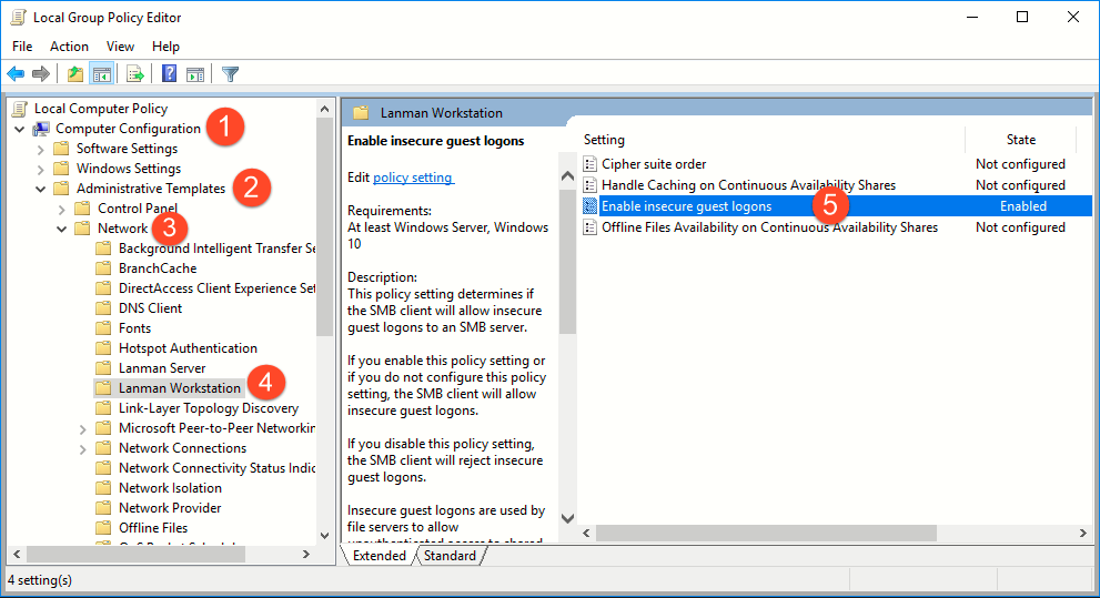

September 16, 20206 yr Author Lo and BEHOLD. I am not sure how I missed this amazing piece of information, but I am glad I caught it. This is what solved my issue: 1. Open the registry editor and go to Computer\HKEY_LOCAL_MACHINE\SYSTEM\CurrentControlSet\Services\LanmanWorkstation\Parameters 2. Double-click on AllowInsecureGuestAuth 3. Under "Value data:", change it from 0 to 1
