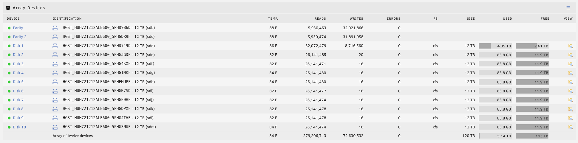

Bellow is the current status of my new raid array.  I have a share named `storage` and i'm currently rsyncing data from an older FreeNAS machine into the `/mnt/user/storage` to copy all of the data to the new Unraid machine.  I'm hoping that that's an ok way to transfer the data from another machine to Unraid - i assumed that `/mnt/user` mount was where the array was mounted.  But upon looking at the image below you can see that most (all?) of the data is on the first disk.  Is this normal?  Will it get spread around later?  Is this not how I should be transfering data?

Depends on the allocation mode and split level set for the share(s), default is high water and split always.

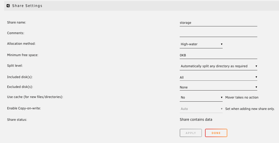

Here's the settings:
996239078_ScreenShot2020-09-15at10_31_28AM.thumb.png.877da6b802f04e7b4e2d8f4ad1122ecc.png

As mentioned, highwater allocation is the default, and for good reason. It is a compromise between using all disks eventually without constantly switching between disks just because one disk temporarily has more free space.
Unraid does not automatically move files between array disks, so files already written do not get spread around. When allocation method says disk1 is done, it will begin writing new files to another.
Since all your disks are 12TB highwater is easy to figure out, it is half that or 6TB. When 6TB have been written to disk1, the next disk in line will be chosen until it has reached highwater, etc.
I read the definition of highwater - so it seems to be working correctly.  Is this safer/better/faster/etc. than the "most-free" option?

Most free is bad for performance since writes to parity disk will overlap when changing data disk, resulting in worse write performance.
