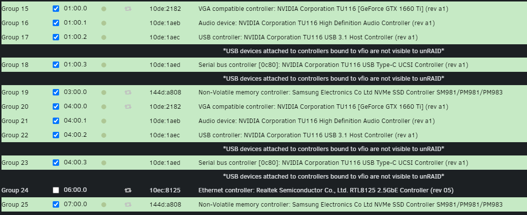

But another show stopper turned me down when with the two graphics cards i couldn't make everything work. I watched spaceinvaderone videos of how to rip the rom from the card and did so and also managed to hex edit to cut out the non usable starting portion. I was quite shocked to see that i had to trim it down from 1,047,040 bytes to 881,664 bytes. vm1 with the 1st graphics card just woudn't work (in fact i coudn't get the bios out of it - the file would be empty).  vm2 with the 2nd graphics card worked alright and was able to see the graphics passed through and install the nvidia drivers w/o issues. i did left on the integrated graphics and had a monitor hooked to it at all times to be able to pass console commands and to make the two discreet cards available so i don't know where and if i failed to do something on the configuration side.

I did in fact separate the two vm's each with their own nvme drive and gpu. Once more i did passthrough all related multifunction devices for the gpu that are exposed to the unraid (video, audio, usb-c controller). Baremetal all works alright with booting both. But inside unraid only the 2nd vm works. the 1st doesn't boot due to something related to the gpu.
Edited by Cristian Sava
I think that i may have found the issue. It seems that my first graphics card is jumping from one id to the other (01 and 02).
When the first card's id is 01 it seems to display "(rev a1)" and when id is 02 it shows as "(rev ff)".
The second card seems to be stable at id 04 with "(rev a1)".
I managed just once to boot both vm's when they displayed different revisions. This is very strange.
q1 : is this an issue cause the cards are suposed to be idendical (should i just put in two different cards)?
q2 can i make their id's "sticky" somehow if i were to have them both identical ?
