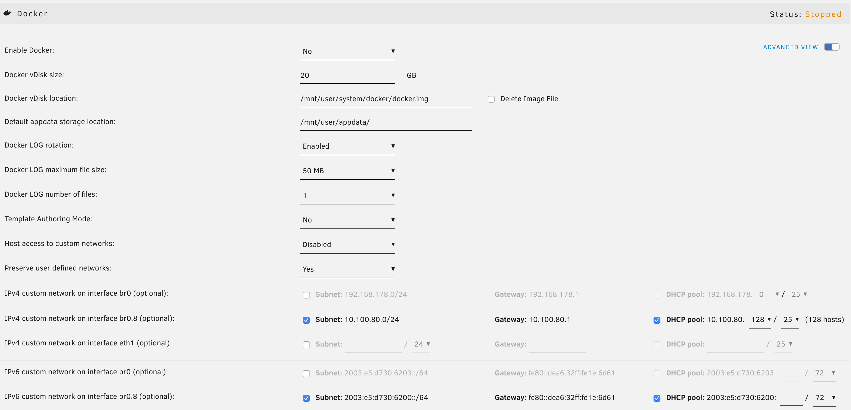

IPv6 is enabled in the Docker settings:
It seems like I'm missing something here, but I don't know what else to try.
I fixed this for now by creating the Docker network manually and not checking the custom networks in the Unraid Docker settings.
