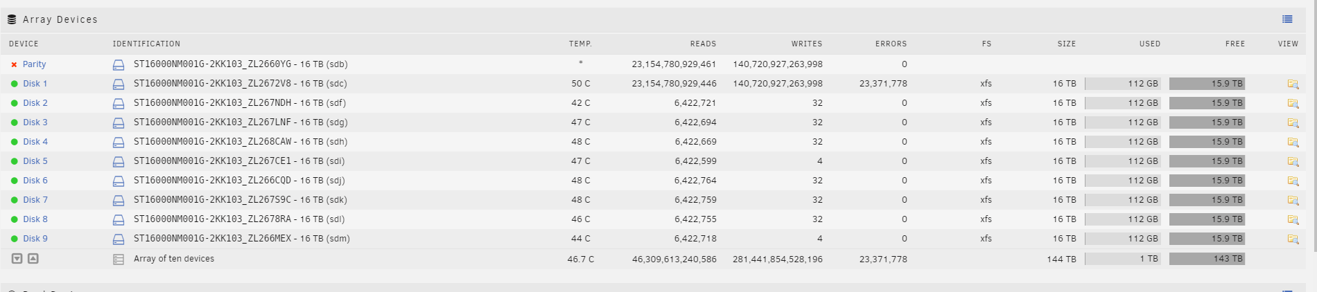

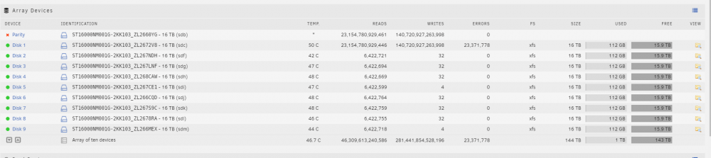

September 17, 20205 yr I have a new fresh install of unraid Version: 6.9.0-beta25 and I have selected my 10 drives to be part of the array. 8 of those drives are connected to an HBA, 2 of them are connected via USB 3.1 in an external 4 bay case. the 2 that are connected through USB keep dropping at around 1-2 percent: I know the drives are good, I cannot see them in system devices. This is the 4 bay device: https://www.amazon.com/Mediasonic-SATA-Hard-Drive-Enclosure/dp/B078YQHWYW/ref=sr_1_18?crid=17E73CTFH7K5G&dchild=1&keywords=4+bay+hdd+enclosure+usb-c+10gb&qid=1600316641&sprefix=usb+c+4+bay%2Caps%2C203&sr=8-18 The mobo is an Asus Zenith Extreme II Alpha if that matters. best i can tell, the usb enclosure is an HBA. Any Ideas? tower-diagnostics-20200916-2117.zip Edited September 17, 20205 yr by TheSkaz
