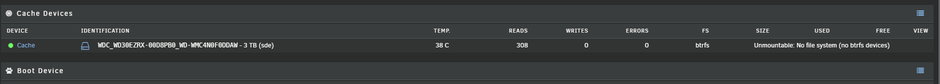

Good day everyone

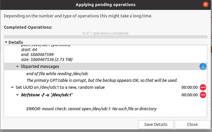

So this morning I was working on getting something set up on my new pc and I went to get the file off my unraid server and found one of my drives missing. I went and looked at the server interface  and saw the that drive was listed as “Unmountable: no file system” and was asking to formate that drive. So I thought thats was odd the SMART report looked fine. So i took the server offline and pulled the Unraid boot disk and booted in to an ssd with Ubuntu on and it showed the same with the main Disks tool that Ubuntu comes with. Then I tried Gparted tool and did show something was wrong with the drive.

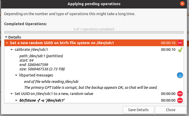

The first thing was this error “end of file while reading /dev/sdc”  The button I pressed was “Ignore” to move on. Then got this error “The primary GPT table is corrupt, but the backup appears OK, so that will be used.”  The button I pressed “ok”.
 after doing some quick Googling I decided to right click on the partition and use the “New UUID” option to see if that would work. It failed!
I think the drive is fine with the data is still there. I just need to figure out how to fix the partition table.

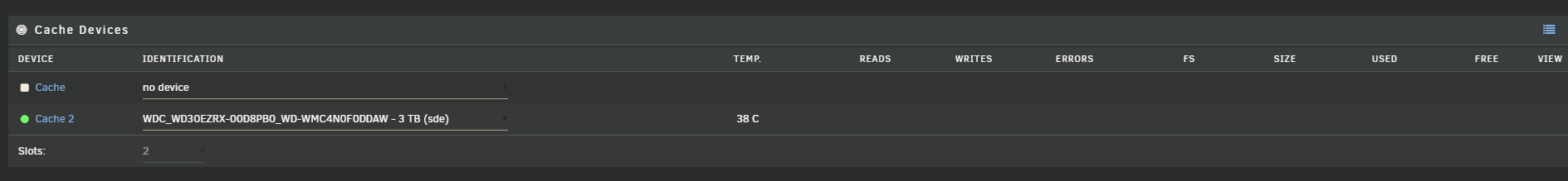

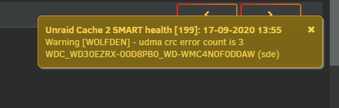

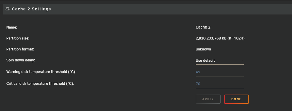

ok i moved it to cache 2 slot it was in slot 1, but as soon as i did it gave a warning "udma crc error count is 3" this is new and did not show that this morning. also i don't know where you met to change that setting that field is unchangeable.

Don't move to slot 2, leave the ssd on the 1st slot and change total cache slots to 1.
ok did the changes and started the array but looks to be the same as before “Unmountable: no file system”. the new diagnostics zip is below.

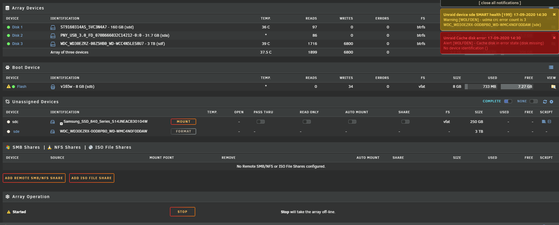

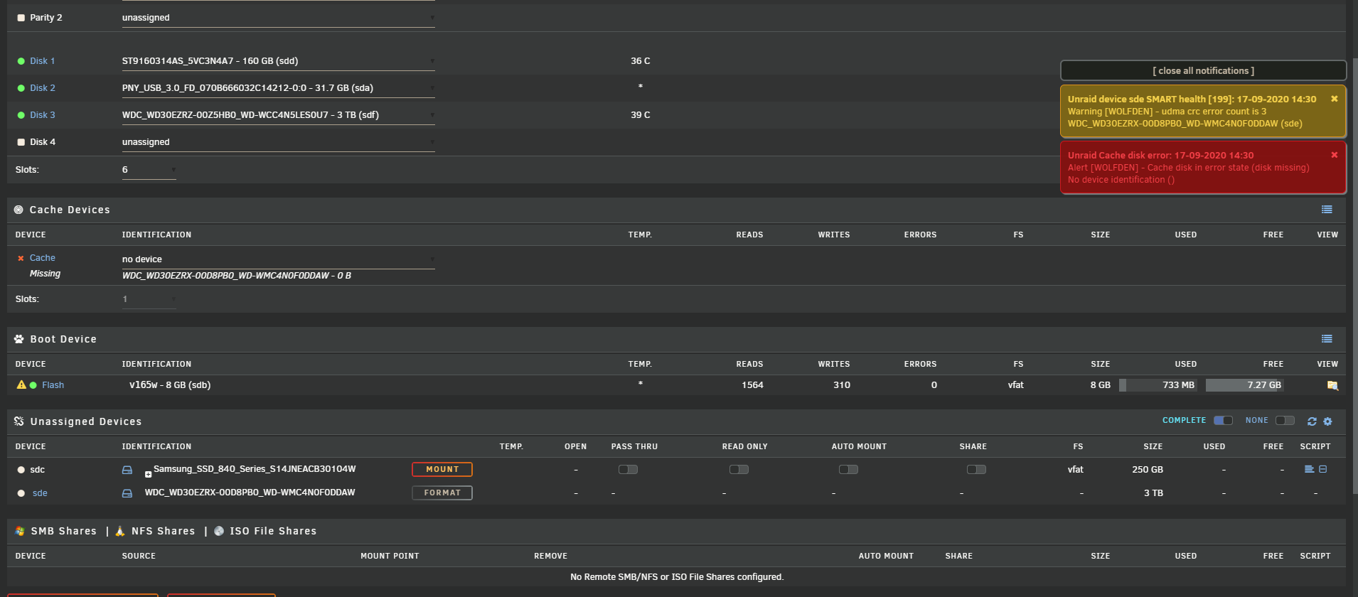

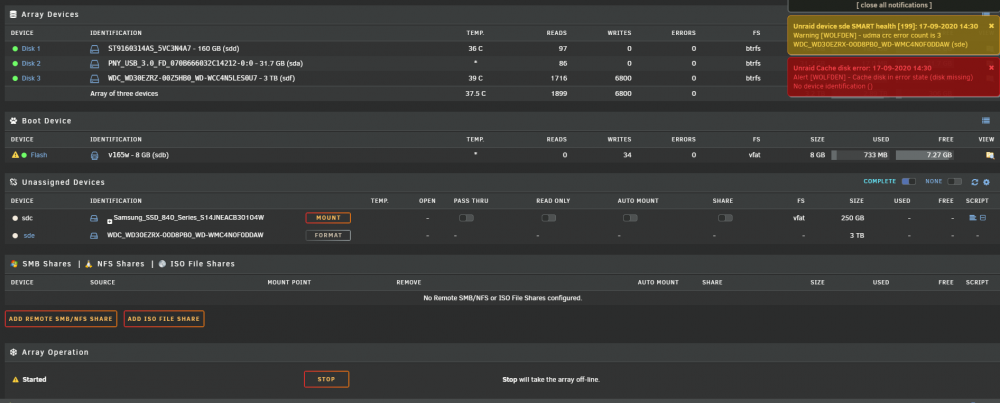

There's a problem with the partition, unassign cache, start the array, install the Unassigned Devices plugin and see if there's an option to mount the disk there.
so i installed the plugin and unassigned cache drive but now the array does not start. i see nothing that the plugin help with. and i knew that there was something was wrong with the partition. please read my first post. Gparted tool did see the issue was the partition table is missing but the backup table is there. how do we get the back up table to work or fix the first partition table.
There's a checkbox to allow starting the array without the cache assigned.

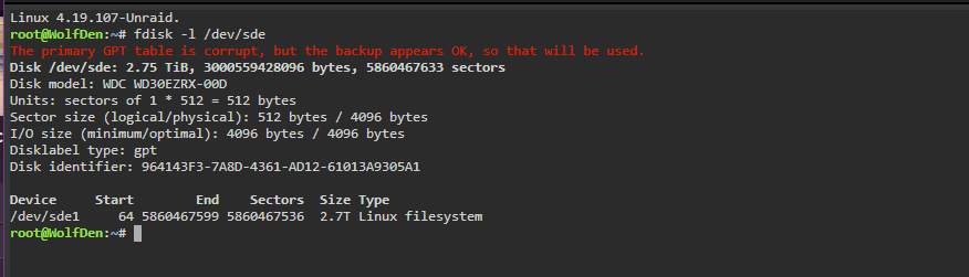

According to UD there's no partition, post the output of:
fdisk -l /dev/sde
ok here you go. it say the same thing?
It appears that the GPT corruption is causing an error that makes Unraid not even detect the exiting partition, I have no experience repairing GPT partitions, quick google search found this:

P.S. don't try to change the btrfs UUID, it won't help and can cause further problems.
