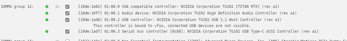

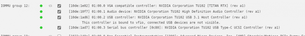

Pass through 2x RTX Titans (with nvlink) to single VM
I cant seem to find anything regarding NVLink and passthrough to a VM. Is it possible, or is there such a tutorial?

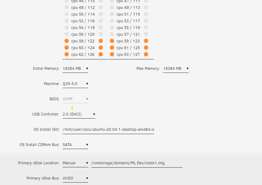

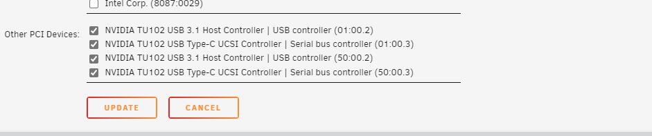

here is what I am trying now: (causes a kernel panic when trying to start vm)
Edited by TheSkaz
Does this mean anything useful in regards to my issue?

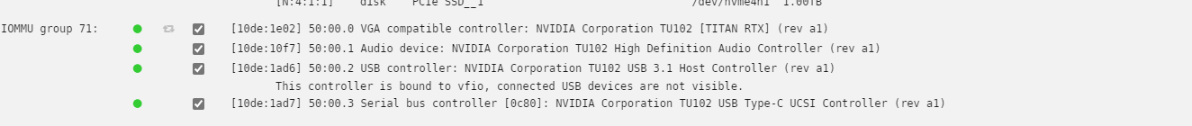

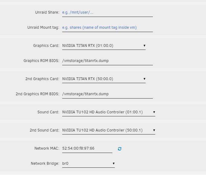

I have the VM up and able to boot with both gpus showing. in the VM logs for the machine, I am getting hundreds of these:
2020-09-22T06:21:28.221139Z qemu-system-x86_64: vfio_region_write(0000:01:00.0:region1+0x801b8, 0x0,8) failed: Device or resource busy
that is my primary video card for the system and 1 of the 2 gpus for the VM. anything that attempts to use the gpus freezes.
googled the error and found that running:
echo 0 > /sys/class/vtconsole/vtcon0/bind
echo 0 > /sys/class/vtconsole/vtcon1/bind
echo efi-framebuffer.0 > /sys/bus/platform/drivers/efi-framebuffer/unbind
works. NVLink seems to work too
