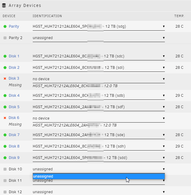

I moved to another server by swapping the mainboard. As it has less SATA ports and my Port Multiplier isn't delivered by now I tried to connect two drives with USB3.0 to SATA adapters. But after rebooting those two drives are missing:
If I understand my diagnostics logs correctly, the server completely does not find these mass storages. There is only one mass storage entry and this is the unraid flash drive. What could be the reason? Or do I need to enable something in the settings to use usb disks as part of the array?
EDIT: Sorry, sometimes its needed to read a manual. For 3.5 inch drive I need to use an external power supply 😅

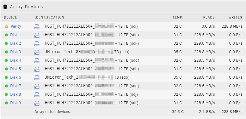

But the performance of the usb connected drives looks good, so no reason not to use USB (except of the little bit higher energy consumption of 2W per drive):
