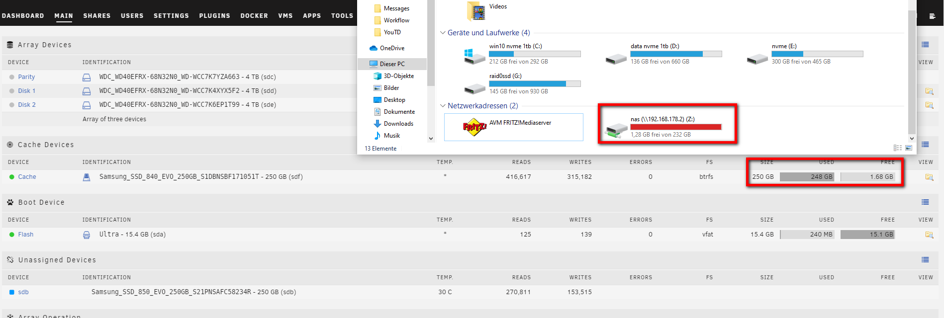

Today i wanted to copy some files to my NAS and noticed in my Windows Explorer from my computer that the network drive from the NAS is only 465gb big. Most of the data was missing.

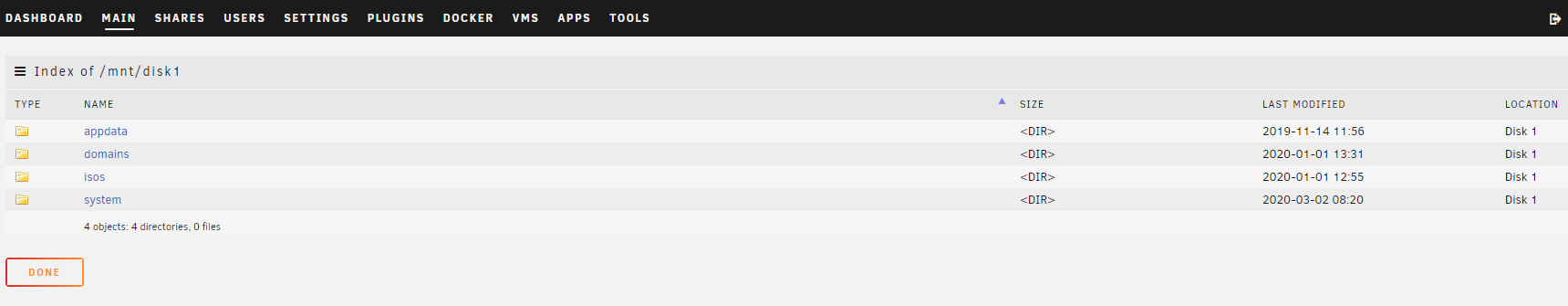

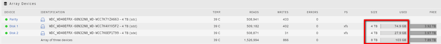

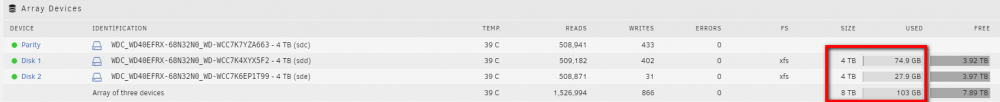

In the Main window you can see that my HDDs are nearly empty now. As i wrote i was using about 3TB.

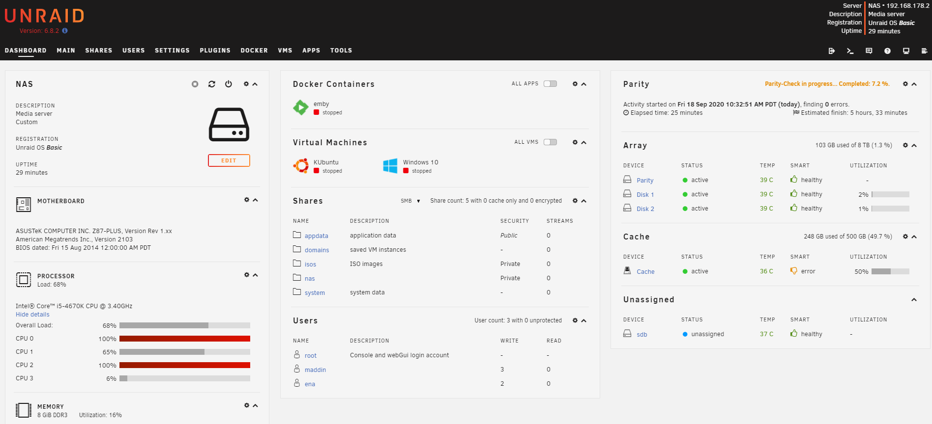

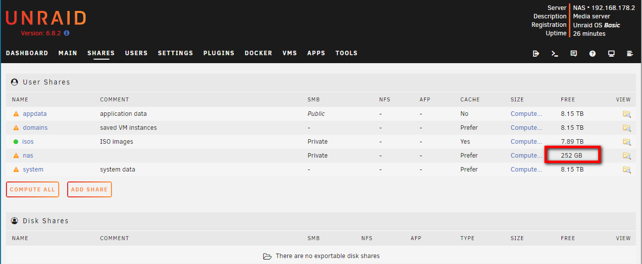

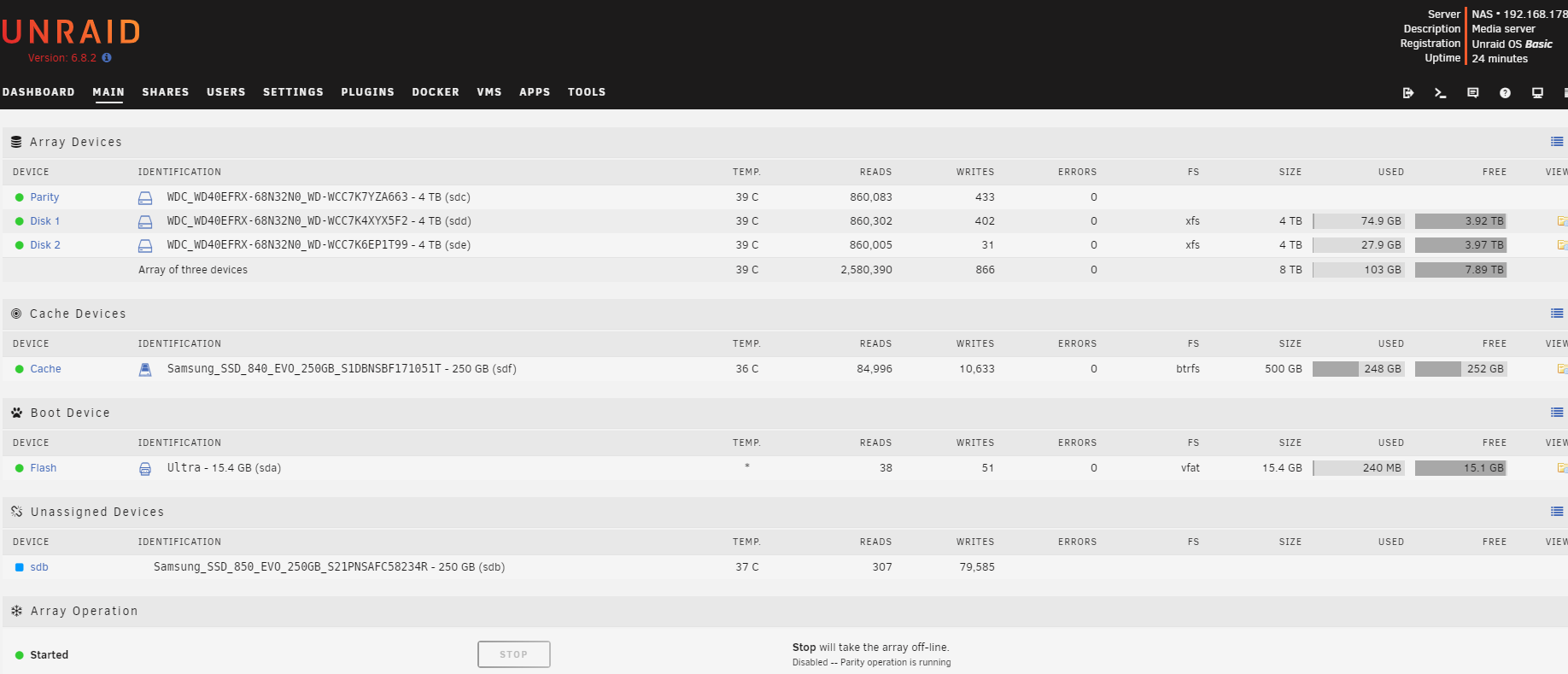

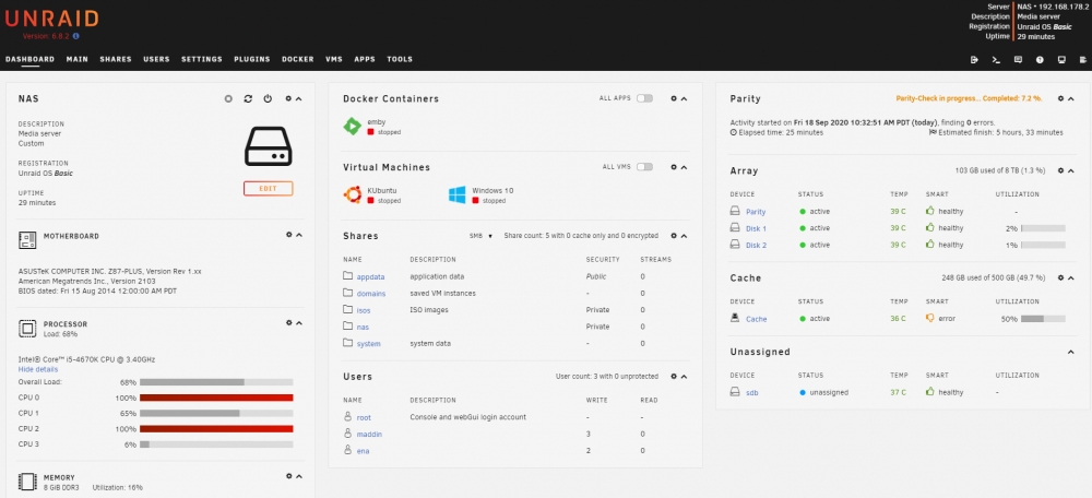

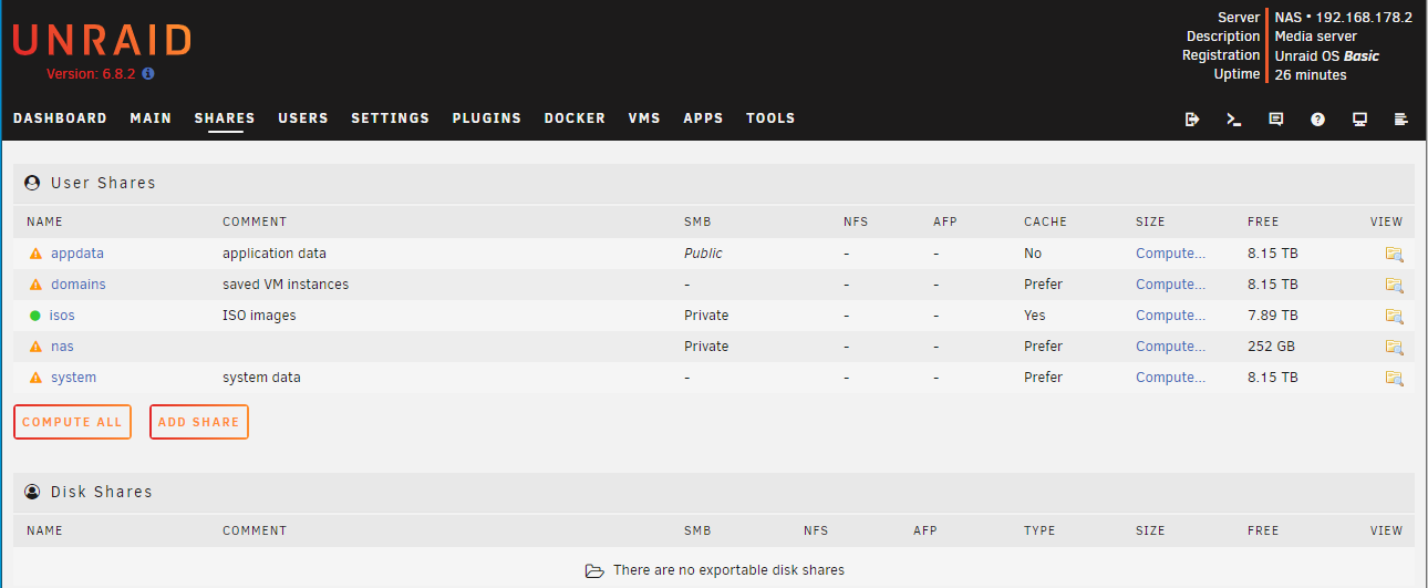

Here some more screenshots i think could be usefull
Are you sure you didn't format them, perhaps because they were unmountable? Formatting would be the most likely cause.

Was there anything related to cache you had to do when starting with a new flash?
appdata, domains, system shares have files on the array instead of all on cache where they should be. In fact, for some reason you have appdata set to cache-no instead of cache-prefer. And I don't know what the nas share is used for or why you would want it all on cache.

It is still showing you have total array storage of 8TB, just not much used.
No, its not and that is strange. Now it only shows 232GB in Windows as max capacity which is the size of the cache drive. When i open the network storage i find all the files and links but nearly everything has 0kb size.
Im not very sure at the moment to be honest. I think i fired it up and it was ok, i saw that only one cache-drive was assigned to the raid. i stopped the array and added the second cache drive.  Now what i see is that my "NAS" share is only on the Cache drive and not on the big drives anymore. Thats not right.
I have no idea what the settings were where appdata, domains, system and so on should have been. I did not touch these settings when i installed unraid. i only set up my array, users and smb share.
Now it seems that everything swaped. my cache drive is the "NAS" drive now where all my data should be and on my 8TB share are the appdata, domains ....
I made a few screenshots: Nas share is only 232GB big, as the cache drive. On the 4TB HDD Disk 1 is only appdata, domains, isos, system, but not nas.
On disk 2 is only appdata.
