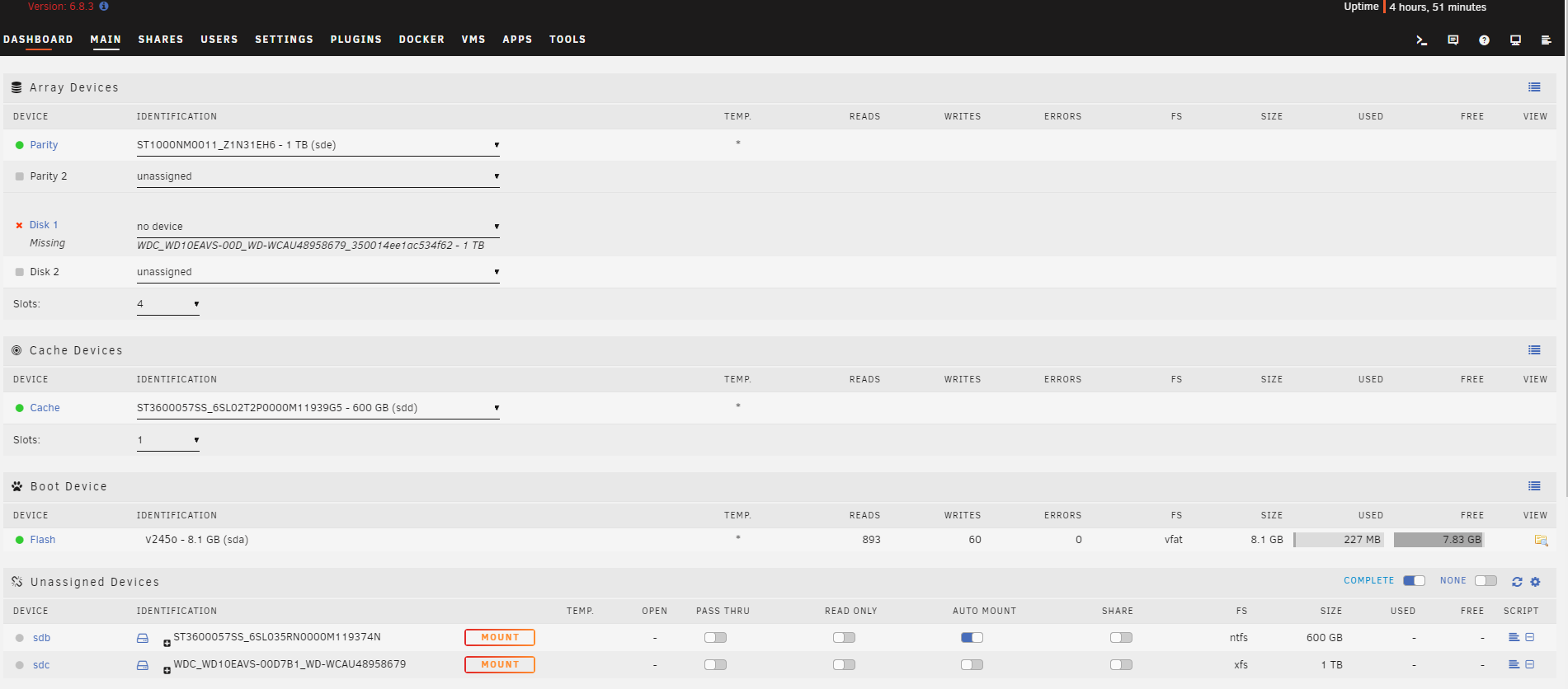

Now i am having trouble with Unraid before reboot everything in the array looks fine
After reboot in this case disk 1 is a unassigned drive. its says its missing but the drive is there.
Now when i look assign the drive to Disk 1 it says its wrong.
Can someone tell me whats wrong ?

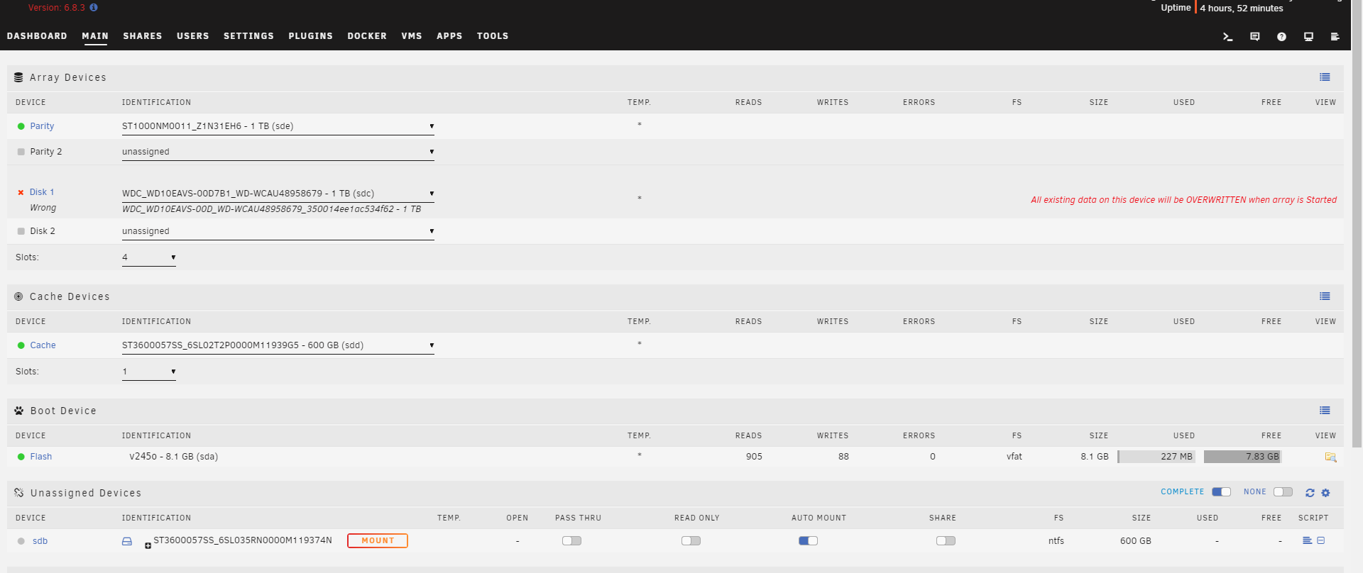

Call me stupid but i dont get it i did not change the drives.
The r710 has 4 drive bays connected to the sas controler not to a SATA port.
When i start a new config and start over the same thing happens. after reboot it kicks out the drives

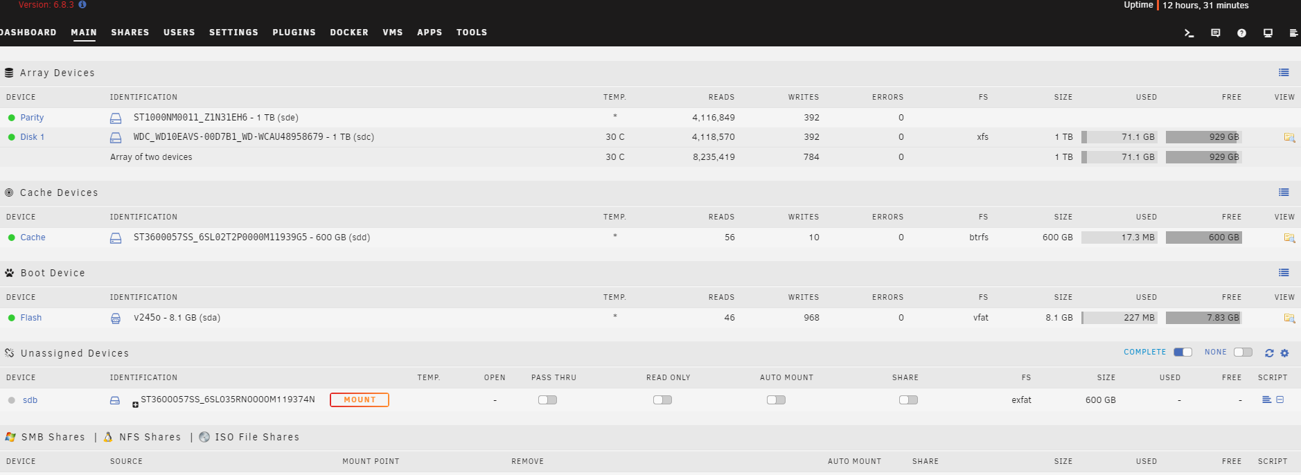

Hi Guys,
Thank you for all your input.
I had updated the sas card and bios ect ect.
Now it stays good when i reboot. however i need to flash the h200i to TI mode. can some tel me how to do this for this card ?
