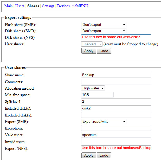

Sounds like you shared out the disk shares in the Export settings section which will share out all your disk mounts i.e. /mnt/disk1 /mnt/disk2 etc.  If you want to use NFS for a particular user share you need to set it on a per share basis in the user shares section.  See attached pic.

Thanks Spectrum! I now see the share export option. I always thought it was at the upper portion of the Share tab.
So I will set "*(rw)" for the share I want to export.

"mount -t nfs server:/mnt/user/Movies /mnt/Temp" command works with setting User Shares to *(rw)
Then using "rsync -av --stats --progress" copying all the files with the right file attribute and permission. No more hidden files using NTF.
