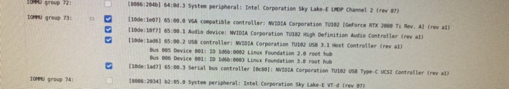

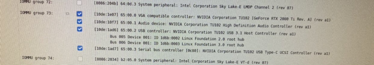

I hit the hurdle that I had with only one gpu, I go into device settings, then select to bind the 2080ti (it selects all 4 devices, including sound etc..) then as soon as I reboot it hangs.
I guess I need to tell unraid to use the 1650 as the main gpu before doing this? How would I do that please?
EDIT: i remember reading I could wipe the vfio-cfg.cfg if this happened, so I did.
The contents, with the change I made previously were:
BIND=0000:65:00.0|10de:1e07 0000:65:00.1|10de:10f7 0000:65:00.2|10de:1ad6 0000:65:00.3|10de:1ad7
thats the 2080ti identifiers

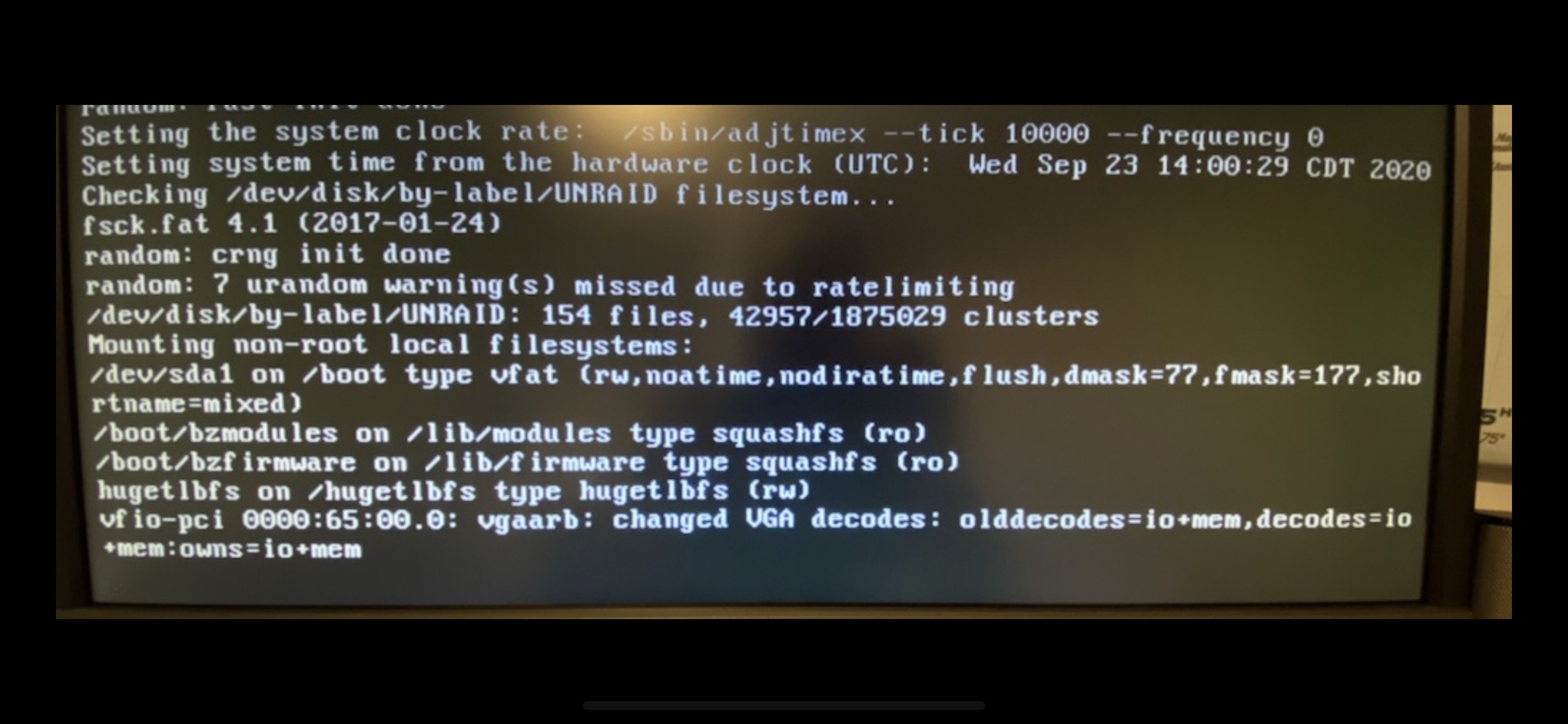

What do you mean by it hangs?  Do you get to the boot menu to choose the GUI/non-GUI/safemode and then nothing appears on the screen?
Try switching to the other gpu (1650) when that happens.  When you isolate the 2080ti, unraid essentially doesn't see it so it can't use it.  Therefore it will fall back to its other gpu (1650).  Failing that, it will go into "headless" mode and not use any video card, in which case you should still see it on the network.

I'll do it again and grab a pic of where it hangs.
This is what I select to bind and then this is what happens if I reboot/ either with or without gui.
Main monitor plugged into 2080ti via DO cable and also 1650 plugged in to same monitor via HDMI.
Interestingly, if I unplug the DP cable from the 2080ti then I can boot, certainly headless. Will try GUI now.
That is what I expect, I'm assuming that is the output from the 2080ti.  So basically, at that point the kernel binds that video card at the specified hardware location (based on the vfio-cfg.cfg file) to the vfio-pci driver. Thats basically just a placeholder for when the VM starts and it gets passed through.  But once that card binds with that driver, unraid can no longer see or talk to it.
So I expect that and your system is still functioning, not hanging.
The 2080ti must be checking if the monitor is attached, if not then it excludes itself from being available. Does the other 1650 takes over?
So you have three options it sounds like, see if you can specify in the bios which card is the primary, rearrange your gpus on the motherboard so the 1650 appears as the primary, or find a kernel boot parameter to specify which card to treat as the primary (haven't checked if possible but I'm sure it it)
Thank you.
It is the output from the 2080ti yep. I thought it was hanging as when it gets to that point the machine never comes up, I can’t access it even remotely.
If I unplug it, then I can get in headless and see the machine remotely.
Looked around in the bios and can’t see anyway to set the primary gpu. If it helps the motherboard is an ASUS TUF X299 MK2.
I can’t boot with the 1650 only, can’t get any display it seems to need the primary gpu for any sort of display; even bios?
Cant really swap the cards around due to space i wonder if there’s any way to edit via a kernel boot parameter as you say?
Correction. The machine DOES come up. I had it set to dynamic IP, changed that now!
So the machine doesn’t hang, but the DisplayPort (from the 2080ti which is now out of bounds for unraid) sticks on the console screen.
No output at all from the 1650 via hdmi, tried all ports and also tried DisplayPort to be safe. Assuming I somehow need to ‘tell’ unraid about it?
