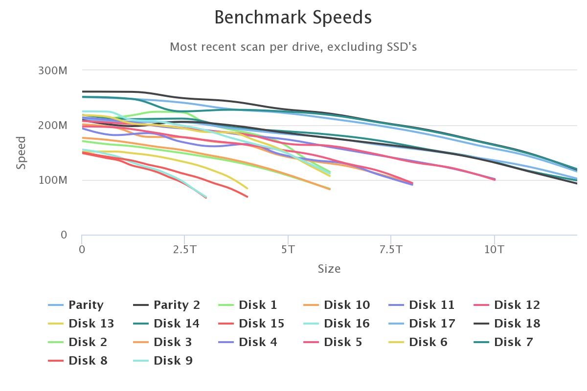

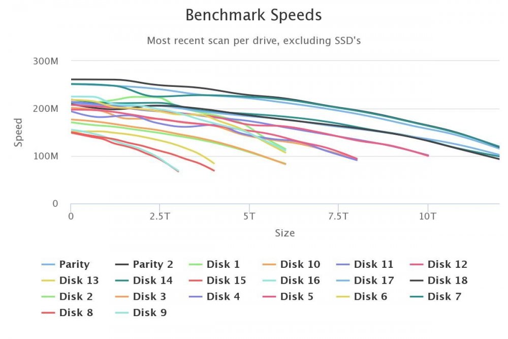

ok drive scan done all looked ok it didnt work with the ssd's
all the speeds looked all  ok over the 3 and 4 tb drives sropped to about 69mb

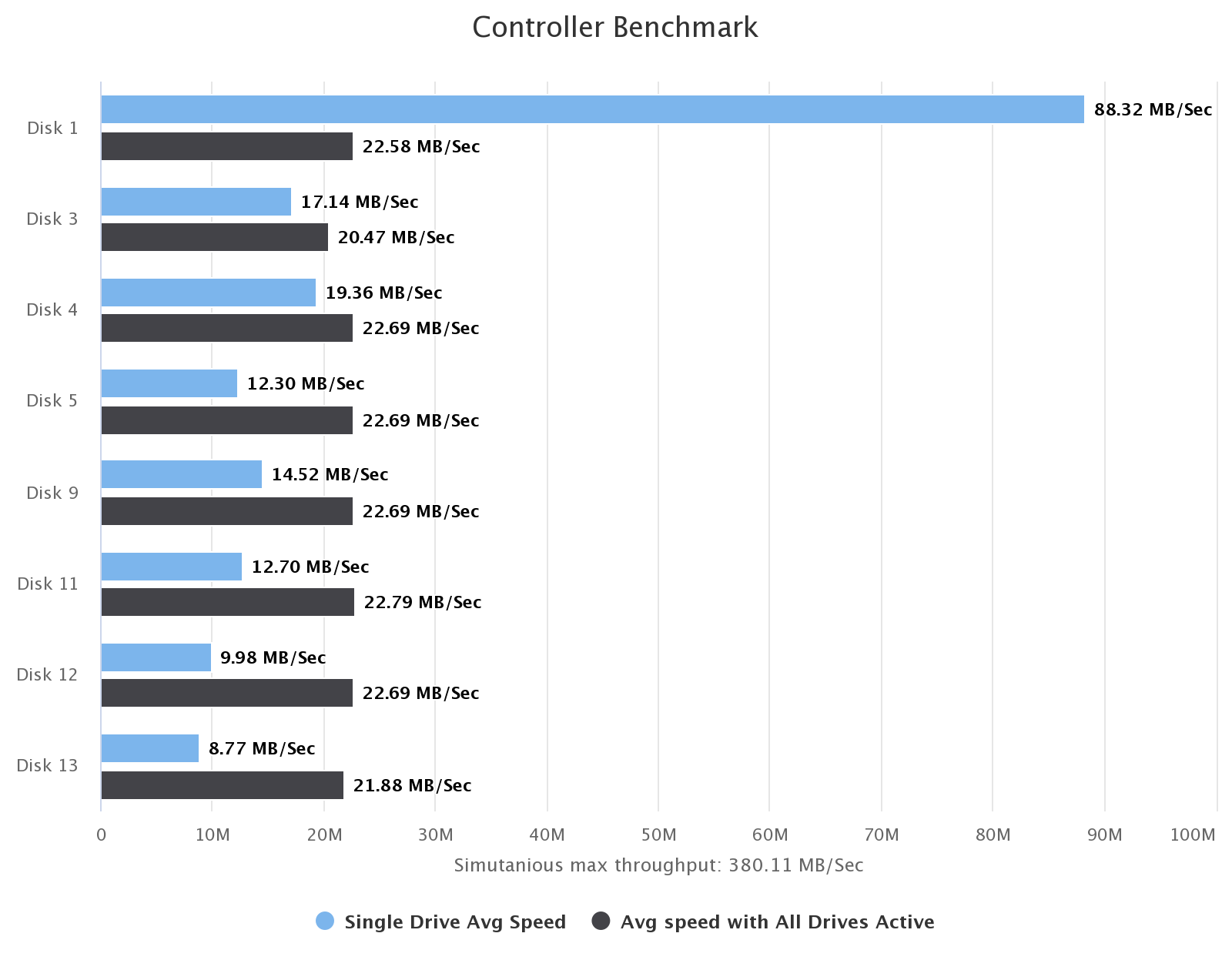

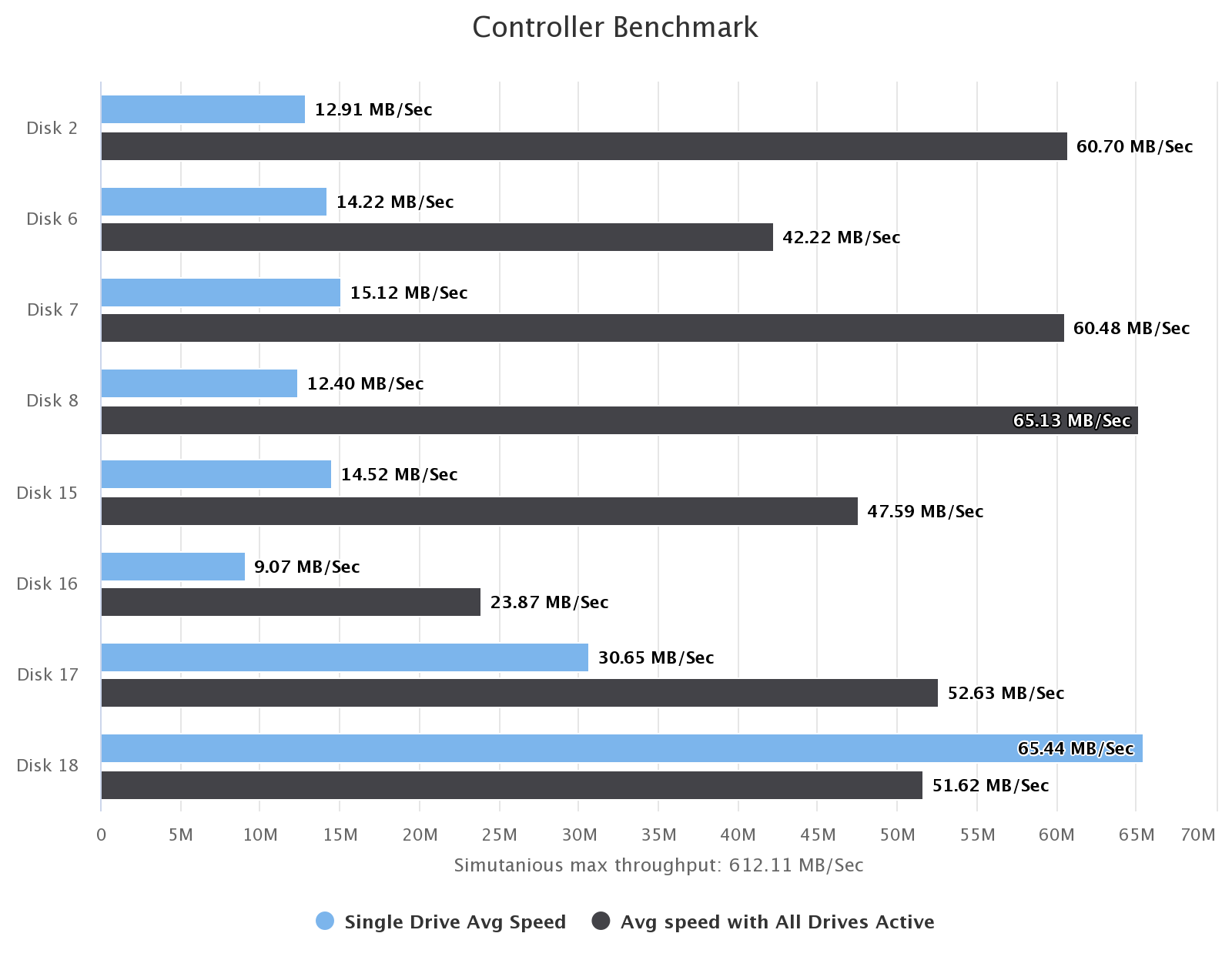

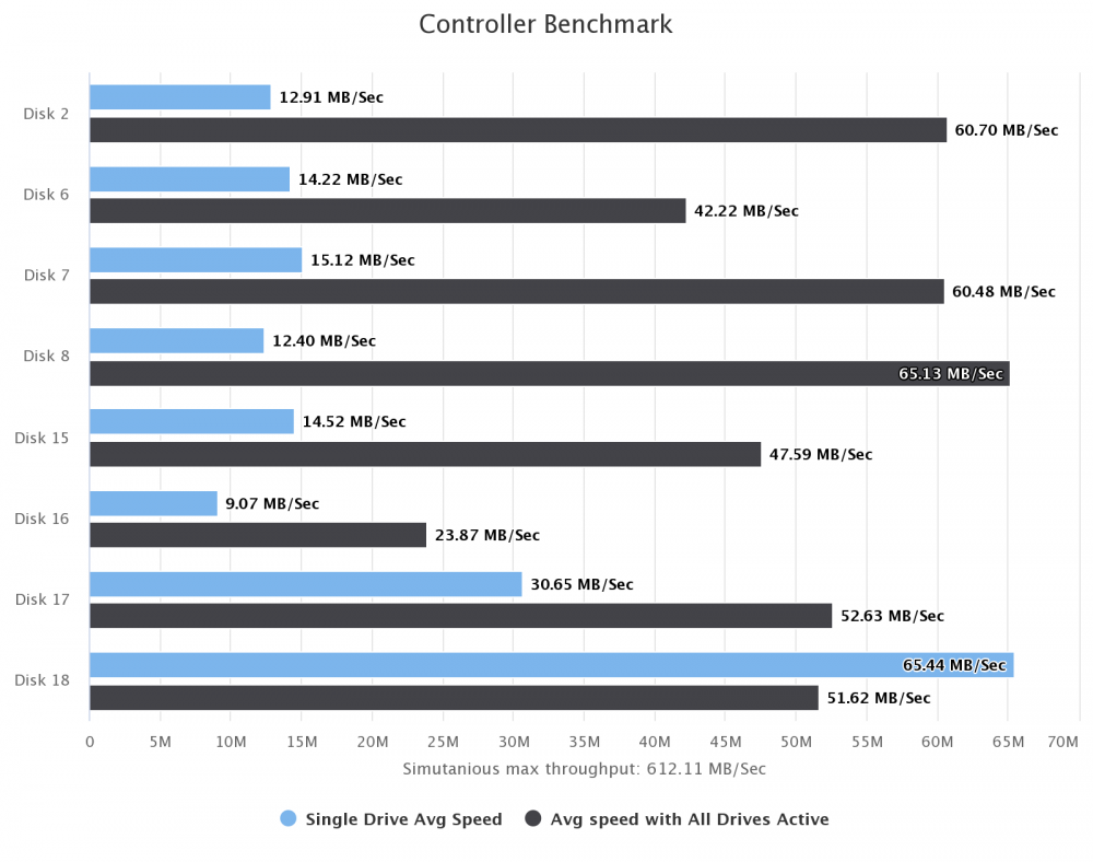

and some controller benchmarks
it looks like my two sas cards are slow
SAS2008 PCI-Express Fusion-MPT SAS-2
SAS2308 PCI-Express Fusion-MPT SAS-2
Even single disk performances are way of.
what can that be
It's strange, max speed with all drives active on the second LBA is low and about what you're getting during the rebuild, that would suggest the controller is not linking at full speed/with, but that doesn't explain the low single disk speeds, in any case check HBA link speed.
