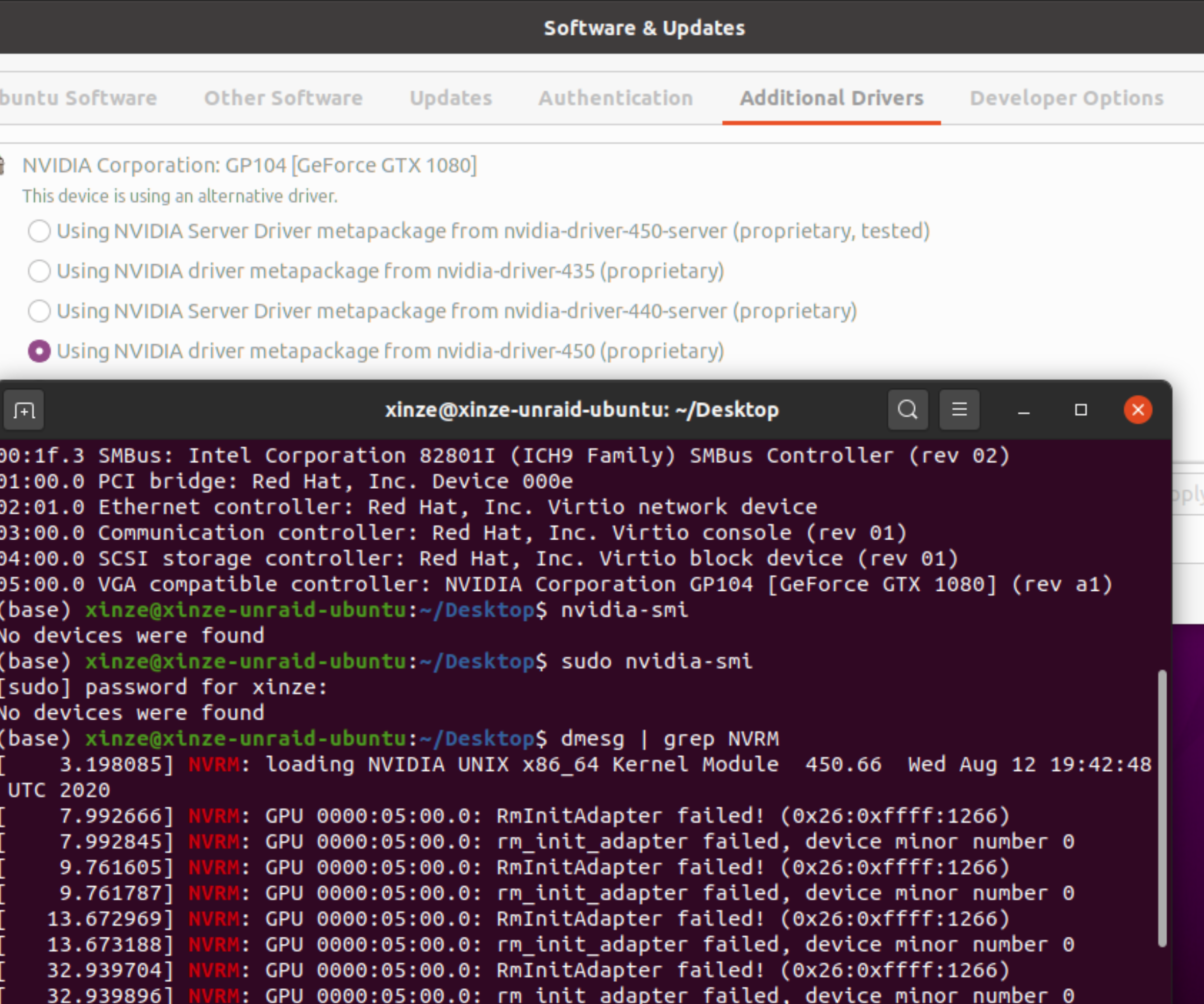

I have created a ubuntu 20.04 LTS VM on Unraid 6.9.0 beta25. I want to passthrough the GTX 1080 to use cuda to train Neural Network.
I can find the GTX 1080 device on VM by lspci command, however, the driver I installed failed to find the device, which shows:
No devices were found
and the dmesg | grep NVRM shows:
[    3.198085] NVRM: loading NVIDIA UNIX x86_64 Kernel Module  450.66  Wed Aug 12 19:42:48 UTC 2020
[    7.992666] NVRM: GPU 0000:05:00.0: RmInitAdapter failed! (0x26:0xffff:1266)
[    7.992845] NVRM: GPU 0000:05:00.0: rm_init_adapter failed, device minor number 0
My xml file of VM is attached:

  • 2 months later...
Did you ever solve this?
Please note that this is a completele different approach than yours, he can't install the driver in the VM you want to install it on the host (Unraid).
What Version of Unraid are you running?
