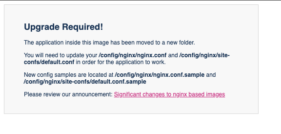

August 26, 20224 yr Okay, so I managed to get this working. Today I upgraded Snapdrop though and I have no idea what this means I need to do? https://info.linuxserver.io/issues/2022-08-20-nginx-base/ Can someone please enlighten me?
September 15, 20224 yr @blaine07 I dont know what this means. The comment on github issues https://github.com/linuxserver/docker-snapdrop/issues/9#issuecomment-1236914847 thinks this message is clear enough. It looks like there was a push to the docker image a about 6 days ago. I tried removing the app and force updating. I found that changing the Repository to include the latest tag worked. lscr.io/linuxserver/snapdrop:latest saved this change and the new image is working fine. I still dont understand what the original message wants you to do.
