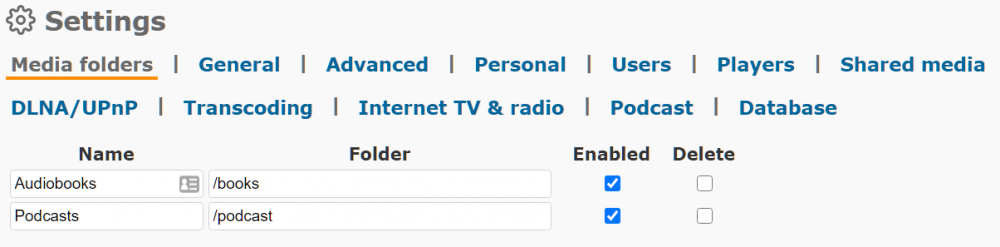

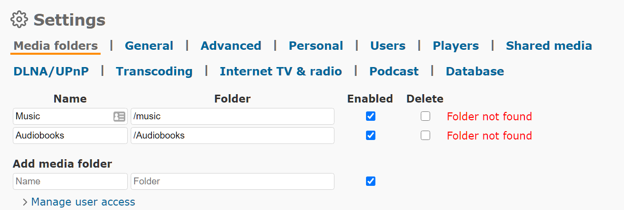

I'm probably being a plank but I can't seem to add Media folders.
Configured in docker to use /mnt/user/MediaLibrary/Audiobooks/ and /mnt/user/MediaLibrary/Podcasts/ but in the interface I can't seem to add these to have the application index the folders:
TBH, I'm no unraid power user and have been holding my various media shares together with lots of help from the forums and @SpaceinvaderOne's unraid tutorial vids... Plex, Calibre & Calibre Web are working fine but I suspect I'm doing something wrong in Booksonic - any help gratefully received.
post docker run command as explained at the very first link in the Docker FAQ in the Docker Engine subforum
thanks trurl,
This is the output from the docker run command:
root@localhost:# /usr/local/emhttp/plugins/dynamix.docker.manager/scripts/docker run -d --name='booksonic-air' --net='bridge' -e TZ="Europe/London" -e HOST_OS="Unraid" -e 'CONTEXT_PATH'='' -e 'PUID'='99' -e 'PGID'='100' -p '4040:4040/tcp' -v '/mnt/user/MediaLibrary/Audiobooks/':'/books':'rw' -v '/mnt/user/MediaLibrary/Podcasts/':'/podcast':'rw' -v '/mnt/user/appdata/booksonic-air':'/config':'rw' 'linuxserver/booksonic-air'
f18e5f6ddfbab0abc6ee2bc38238c69897d3b0d53ed45e83de99ff250981c1df
The command finished successfully!

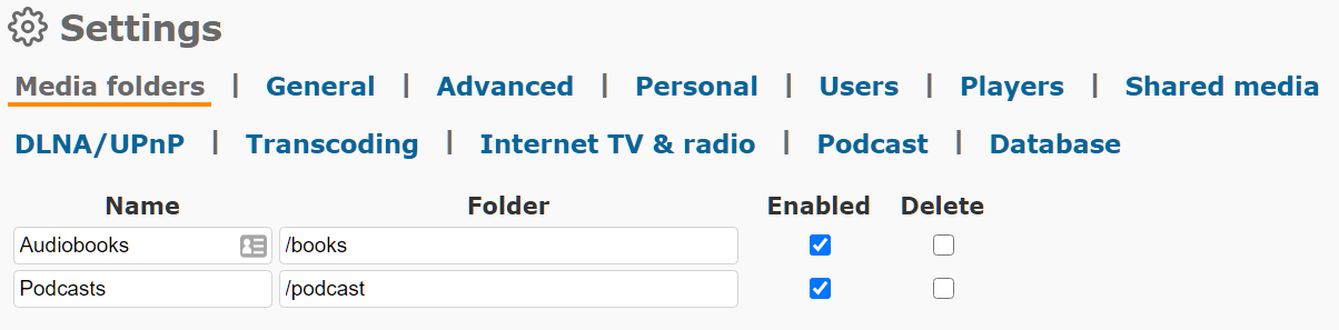

I *was* a plank.
having read the run command output, I realise that the names of the folders I assigned in the container were what the GUI was expecting to have in the fields, not the *actual* paths - DOH:
This is the GUI now with correctly identified paths and no more missing folders :)
docker volume and port mapping is 90% of what you need to understand about setting up most dockers.
