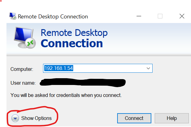

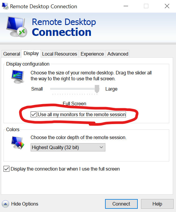

October 1, 20206 yr Author @ghost82 Thanks for the recommendation. I have found a solution that seems to be working, but is not yet my ultimate goal. Although that solution was not highly relevant towards the Windows VM, the video you linked had some good info in the comments section. Thank you. I have documented the "part 1" of my solution below for anyone interested. My Win10 VM on the Unraid Server is a standard Win10 VM within Unraid. QXL video drivers and the rest of the standard drivers one installs when installing Win10 in a VM on Unraid. I am not using any GPU passthrough. Setup the needed items for RDP access within the Win10 Unraid VM. (Settings -> System -> Remote Access) On your physical desktop Win10 system, launch RDP and enter the hostname/IP for your remote VM. Click "Show options" in the RDP dialoge. Go to the display tab and check the box that says "Use all my monitors for the remote session" Click "Connect" in the bottom right corner. Type in credentials if prompted, click "yes" if you receive a warning about a bad cert. The VM will be visable on both your displays - thereby creating a multi monitor VM. It is important to note- the first time I tried this, I tried it on a system with only 1 monitor and it had no effect. I believe if you have 1 display - you will not be able to see two remote VM windows on the same screen. That was very easy- Now I will test if I can do this same process from my Ubuntu desktop PC using Remmina or another RDP client. That is my ultimate goal. Edited October 1, 20206 yr by charlescc1000
