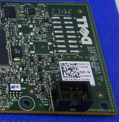

Also I noticed there is a little four pin (?)  connector on the lower right corner oif the card. Can you tell me what that one is for?

32 minutes ago, razr said:
After I re-installed everything back in my case and started the machine all disks connected to the controller are not found anymore.
Same issue with my Dell H310 (same as H200 but with ports at back of card) after flashing to IT firmware.
Taping over pins 5 and 6 with Kapton tape fixed it and that card and all attached drives were immediately recognized.
Did your machine boot up? Because mine does. It also shows the other seven drives connected to the mainboard. But not the ones connected to the card. Are there any experiences with the taping in such a case?
Yes, the machine booted up without issue. Same thing; all drives connected to MB showed up, HBA connected drives did not.
Apparently, those pins have something to do with the card being used on a Dell MB in a Dell server but on many non-Dell boards there can be issues with the card not initializing properly without the pins taped.
Alright. Then I will give it a try tomorrow! First need to check where I can get Kapton tape though :D Will report back once I tried.
You can use regular electrical tape.  I did to start with even though it is a little thick.  When I got some Kapton tape (a cheap knock-off version from Amazon), I replaced the electrical tape.
The adhesive on electrical tape tends to be kinda nasty after a bit, so replace with Kapton ASAP. Also, electrical is WAY thicker, so it could spread out the contacts far enough to cause issues if you need those pins to make connection in the future.
True.  I only used it for a couple of days while I waited for some Kapton from Amazon.  I wanted to see if the tape trick would fix the problem (it did) and then  ordered some Kapton.
It is definitely much thicker than Kapton.
