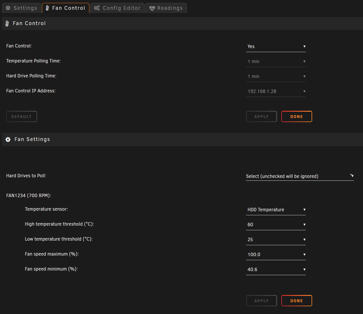

September 26, 20206 yr Author Thanks for the response chaps. Yeah, there are no fan settings in the bios. I've Downloaded the ipmi plugin and set the fan control to 'yes'. Fans now running at full speed (circa 1600 rpm). Any recommended settings please?
September 26, 20206 yr As far as I understand, you can only link the fan speed to one temperature sensor, I chose the drives temperature but depending of your need I think you can adapt. On the Fan Control tab you can select the drives you want to use ( I only check HDDs, not SSDs that have separate cooling ). Then set your temp thresholds and the corresponding fan speeds.

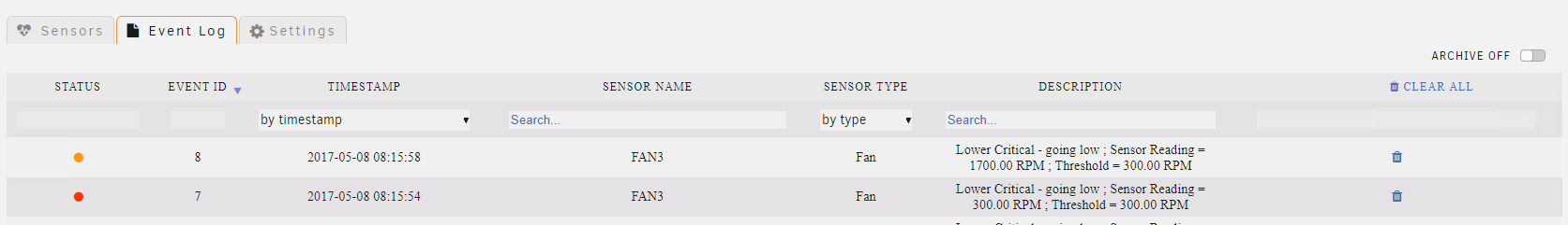

September 27, 20206 yr This usually means one (or more) of the fans is hitting the lower non recoverable threshold, check the IPMI event log with the plugin, it will tell you which one it is.
September 28, 20206 yr Author Hi guys. Log is attached. It seems that no matter what the settings, the fans will just run at full speed 😞
September 28, 20206 yr Did you check the log like I asked above? If a fan is reaching the threshold all fans will spin up, independent of settings.

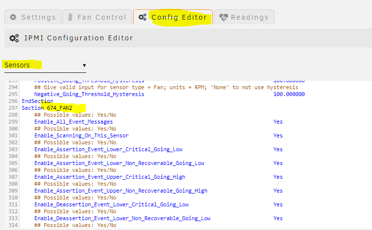

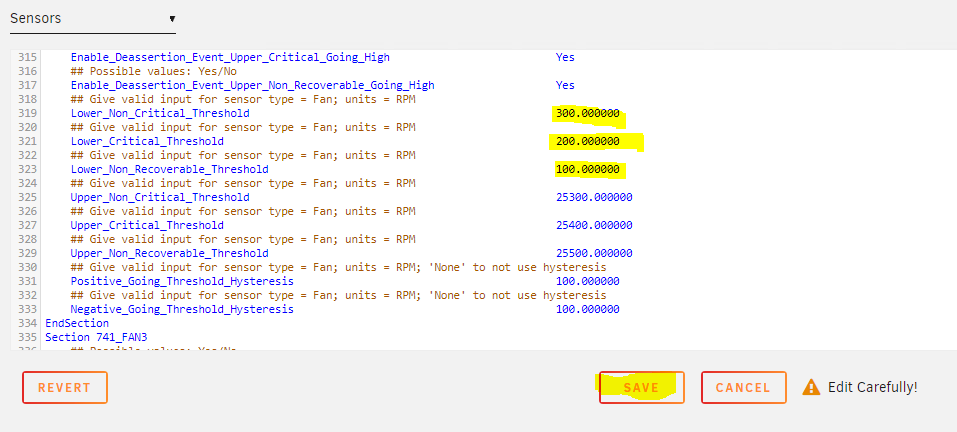

September 28, 20206 yr Like expected you need to change FAN2 thresholds, you can do that with the plugin, set them to 0 / 100 / 200 for example

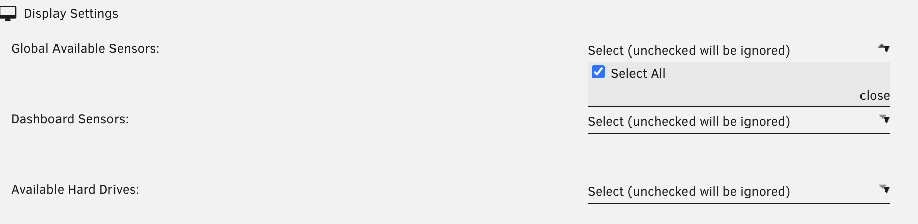

April 11, 20242 yr I have a Gigabyte ATX DDR4 Intel LGA 1151 SATA E (6Gbit/s) (GA-Z170X-Gaming 7) Motherboard and 3 "Wathai 12038 120mm x 38mm PWM Computer PC Case Fan 12V 4pin 5300rpm High Airflow Duall Ball CFM FG DC Brushless Cooling" Fans. I've tried installing Simon Fair's IPMI Tools but I don't get the ability to control the fans. When I expand global available sensors nothing shows up. I don't know if my motherboard is too old. mediaserver-diagnostics-20240409-1644.zip
April 11, 20242 yr 10 minutes ago, flivaudais said: (GA-Z170X-Gaming 7) That won't have IPMI, so the plugin won't work.
