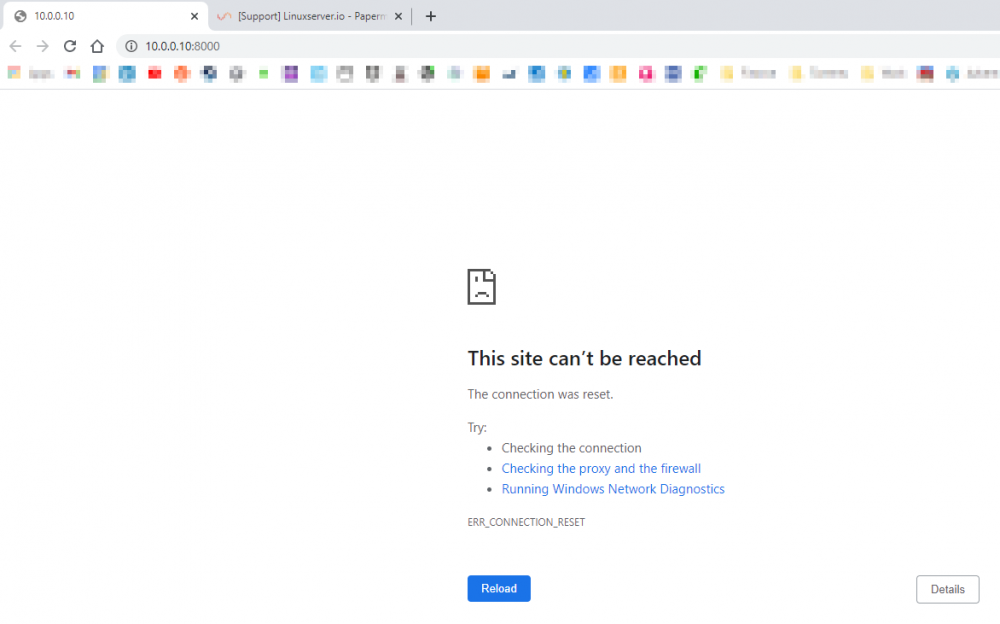

Just installed the docker, but when I want to open the WebUI I get this message in the log:
[WARNING] unable to add HTTP_UPGRADE_INSECURE_REQUESTS=1 to uwsgi packet, consider increasing buffer size
And the WebUI doesn't work.
Hm, I just tried a clean install and it worked here. Did the logs say anything else?
No, no other warnings. This is the complete log:

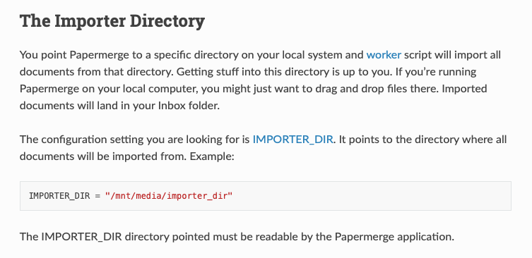

Ok, I have PaperMerge installed...Now, if anyone were to feel so inclined...I need help setting up the "Importer Directory." With importer directory setup I can use my Brother Scanner to upload via FTP into the Importer Directory on Unraid and PaperMerge will automatically import documents and handle it. I think something needs to be defined in Container Template to setup a Importer Directory? I see that one of the setup files for PM may need edited but I think first hurdle is container template? Any direction would be greatly appreciated! :-)
https://papermerge.readthedocs.io/en/latest/consumption.html
Edit: Nevermind. Added “queue” folder in the config file and now it seems to be processing files put in queue folder.

invalid HTTP request size (max 4096)...skip

updated the container to the new version form today, now it works!
I'm getting this error in the logs. I've tried redoing the docker and deleting everything but this keeps popping up.
[2020-09-29 14:53:58,964: ERROR/ForkPoolWorker-2] Error while getting page count of /tmp/tmpfwvh_lfl/685491868_c58dbb94-16e3-4ea7-b72b-e70bb6b908f9.186b186d-c67d-399e-ac01-6aa58d3623e7.msg.
Pull down of container was fine, but I get the same error as other mention above.  The webUI wouldn't load in chrome each attempt to load appeared to create more of the error below in logs, but I loaded in MSFT Edge (new), and the page loaded fine (and I was able to log in with admin:admin).
"invalid HTTP request size (max 4096)...skip"
I can provide more info if you think it would be helpful
I was having the same issues with Chrome, what I had to do was clear all browsing data from chrome, close and relaunch browser and it works properly in Chrome.. YMMV and good luck!

And I'm searching for a solution to define the "Input" folder. I found this in the documentation, but I'm not able to set it for the docker container.
@blaine07 can you please describe step by step what you've done?
I already see the "queue" folder within the root of the folder set up at "data path" - along with the folders media and static.
But I cant upload any file into the queue folder - nor in any other.
Thank you for your help-

Added these two lines to this file in appdata.
Thanks - that worked! So I can test while I'm waiting for german language and OCR.
