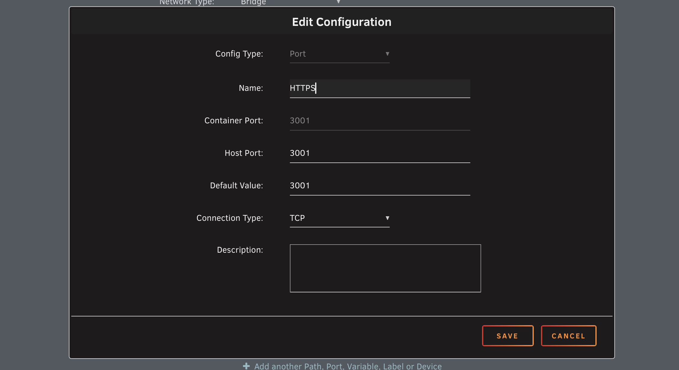

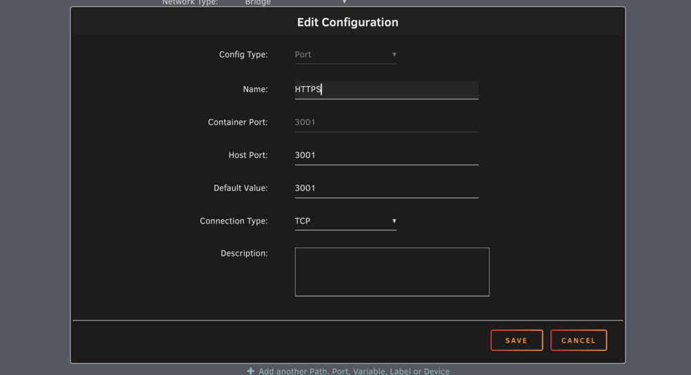

August 24, 20251 yr I also had that problem with the HTTPS: as its rebased and https is now needed. So i added poort 3001 to 3001 which is the https port and it works again here.
September 11, 20251 yr On 8/24/2025 at 10:59 PM, KoNeko said:I also had that problem with the HTTPS: as its rebased and https is now needed. So i added poort 3001 to 3001 which is the https port and it works again here.Cheers, I didnt realize that you can simply access it through port 3001 instead of 3000, after ignoring the HTTPS security warning ofcourse.
October 11, 2025Oct 11 Add a Port with the info below. Add https:// before the address when you try to access it. Hope this helps someone.
