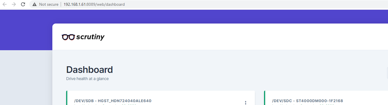

Well, I can help you out (even though no one has responded to why mine is not working)
Apparently you can NOT change the API endpoint of the scrutiny UI which you have done.  The port has to stay 8080
Works for me
But, set the API endpoint back to http://localhost:8080 and just change the port.  (That line, [not quite sure why its there], dicates where scrutiny is listening to.  A docker container has no concept of port mapping, and will always listen to its internal port (which is also always going to be on local host)

Hey,
This is AnalogJ, the developer of Scrutiny.
I've seen some confusion around the SCRUTINY_API_ENDPOINT. If you're using the "all-in-one" container, which runs both the API and the collector, you do not need to touch that variable. Set it to the default value (http://localhost:8080). Within the container, the API is listening on localhost:8080, even if you bind that port to something else on your host. It's primarily used by users who are deploying scrutiny in a hub/spoke model -- one API server & db with multiple collectors.
Hopefully that fixes most of your issues, however if any of you are still running into problems, feel free to open an issue on Github: https://github.com/AnalogJ/scrutiny.
