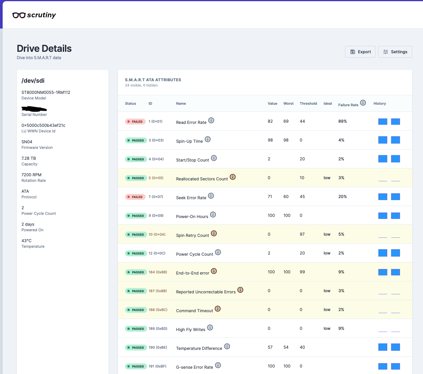

I need help deciphering what these attributes mean in scrutiny. I purchased two Seagate EXOS 8TB hard drives and one (my parity drive) shows failed Read Error Rate. Is this a comparison of data between my drive and Backblaze or is this actually failing? My smart reports all say PASSED. Given that this is my parity drive I would like to know before something really bad happens.

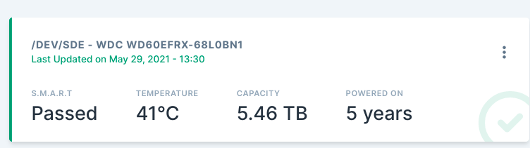

The main page shows everything to look good: everything is green and says passed. I have to actually open each one to see any signs of problems -- such as a failed Reallocated Sectors Count. Is that expected behavior?  Seems like those failures and warnings should be out in front.
