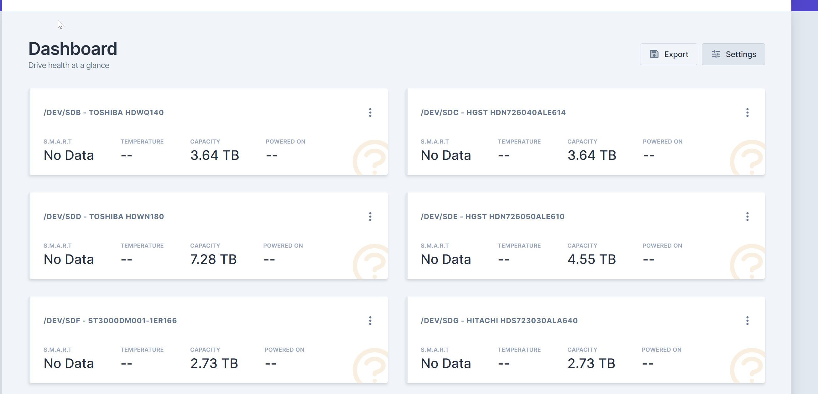

I have it installed - but all disks show up with no data. What should it do to get the SMART data populated?
Edited by abhi.ko
Addec screenshot
Try going into the shell (click on it's icon, and select shell) then run
scrutiny-collector-metrics run

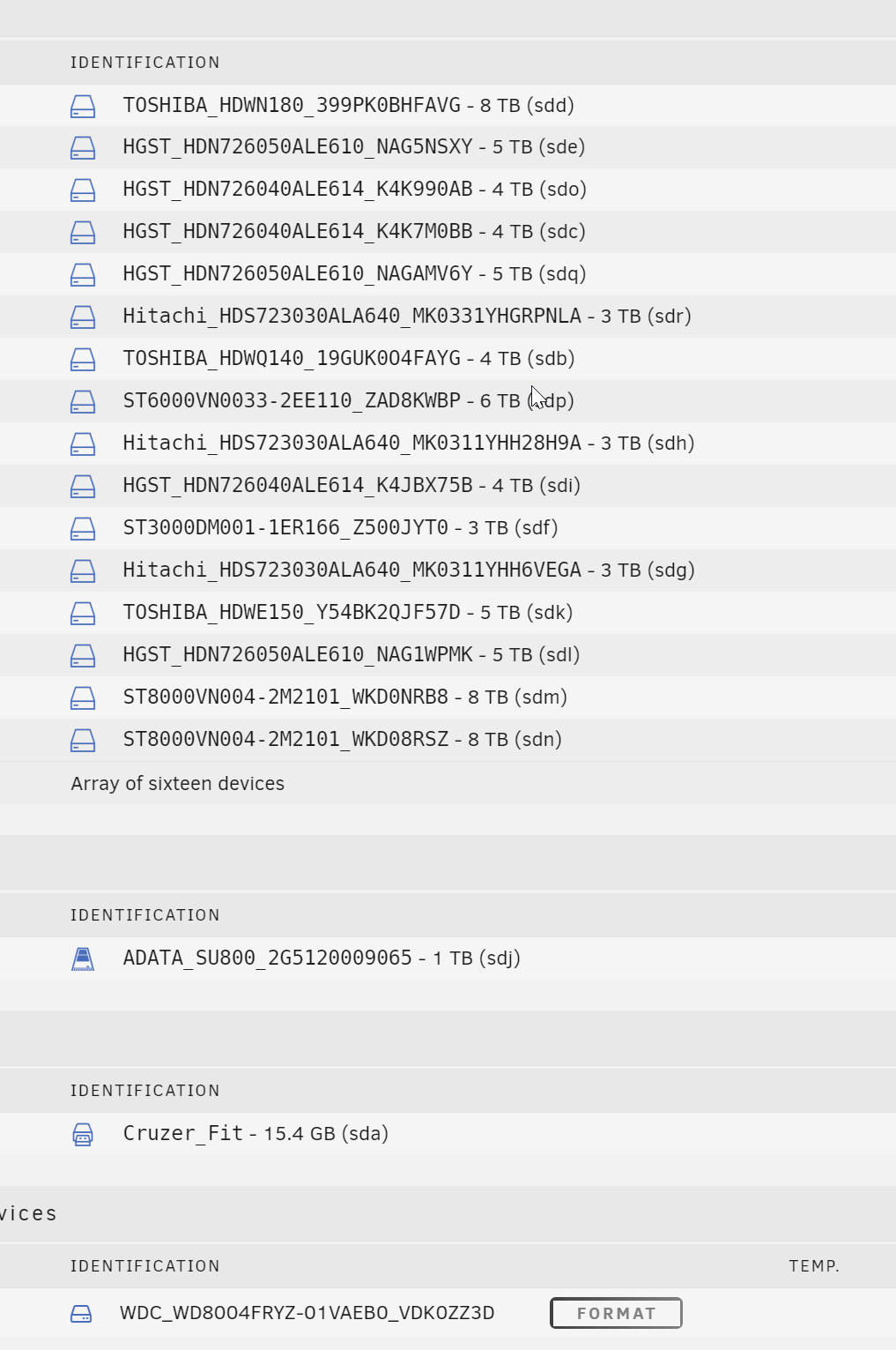

Thanks! That worked, but I only have metrics for sdb-sdg. What about the rest of the drives? How do I get those?

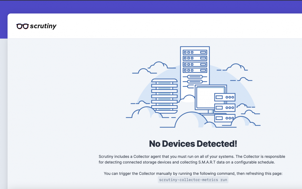

Is there a second part I need to install to have this working?  I only see this in the WEB UI.  When trying the command mentioned, it cannot find the command.
Are you running the command on unRAID terminal or the docker console?

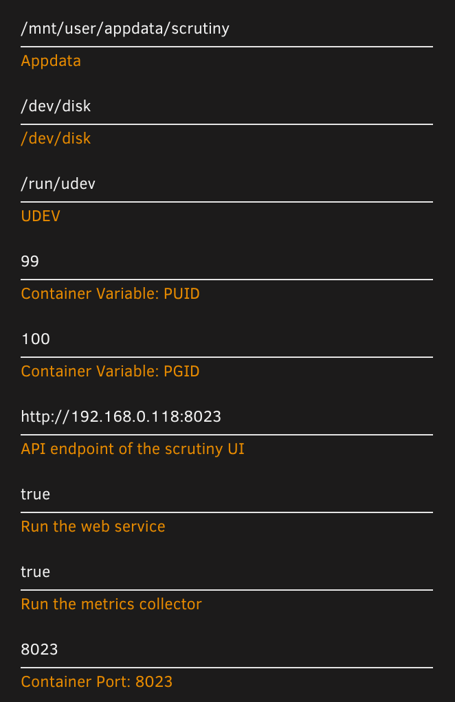

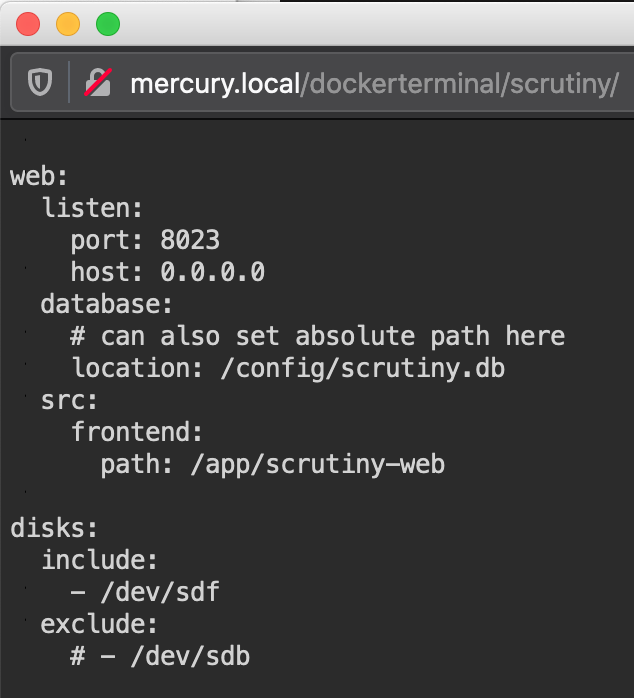

I'm also trying and can not get this to work.
Container settings:
963761734_Screenshot2020-09-30at21_14_34.thumb.png.ef53a312fb48e2ba32e7cc64367461d8.png
Run the command:
1635163675_Screenshot2020-09-30at21_14_59.thumb.png.070450100d00ff959aa390422c876228.png
yaml file:
What should i do more?
Got it working, I was running the command on the Unraid Terminal instead of the Docker's terminal 😮
