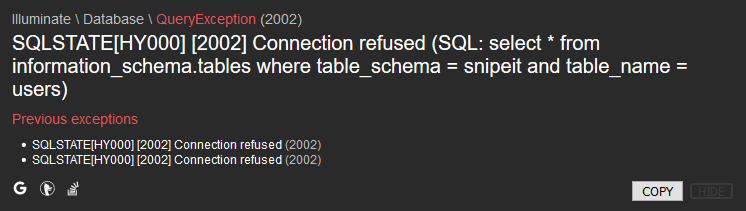

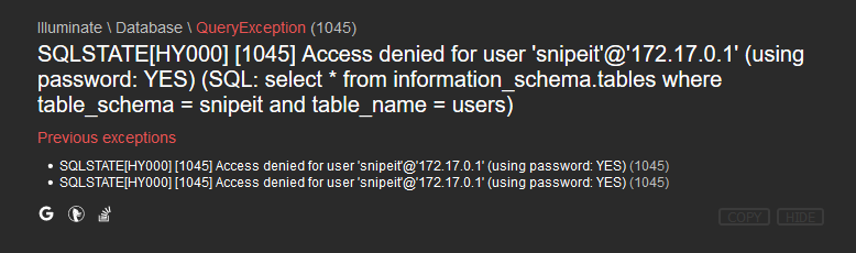

vuribe1221 Posted September 30, 2020 Share Posted September 30, 2020 I get errors on install. not sure what is relevant or helpful at this point but the debug logger gives be the above error. I already checked the port for mysql and user/pass as well yet it doesn't work. Any help is appreciated. Thanks snipeit.txt Quote Link to comment
saarg Posted September 30, 2020 Share Posted September 30, 2020 17 hours ago, vuribe1221 said: I get errors on install. not sure what is relevant or helpful at this point but the debug logger gives be the above error. I already checked the port for mysql and user/pass as well yet it doesn't work. Any help is appreciated. Thanks snipeit.txt 6 kB · 0 downloads You need to give the right permission to the snipe-it user in the database. You probably didn't allow any access outside the database container. Quote Link to comment
vuribe1221 Posted October 1, 2020 Share Posted October 1, 2020 I got passed the other error. I guess the username password wan't taking. My new question is, do I need to setup the database or should it setup the tables it needs to work. Seems like its asking for the schema of "users" table and "snipeit" table but they're empty. Quote Link to comment
SpyKiIIer Posted October 2, 2020 Share Posted October 2, 2020 On 9/29/2020 at 9:16 AM, SpyKiIIer said: I am seeing this same issue. When I attempt to load the application in my browser, all I get is a white screen. I am not seeing the errors the vuribe1221 is seeing. Looking at the database that was created, there doesn't seem to be any table created on the docker startup. Quote Link to comment
saarg Posted October 2, 2020 Share Posted October 2, 2020 6 hours ago, vuribe1221 said: I got passed the other error. I guess the username password wan't taking. My new question is, do I need to setup the database or should it setup the tables it needs to work. Seems like its asking for the schema of "users" table and "snipeit" table but they're empty. It says connection refused, so your database doesn't let snipe-it connect. Quote Link to comment

Zambuck Posted October 10, 2020 Share Posted October 10, 2020 (edited) On 10/2/2020 at 4:31 PM, saarg said: It says connection refused, so your database doesn't let snipe-it connect. Try modifying your snipe-it user similar to this, by running the command as the root MySQL user, to ensure it uses mysql password authentication: alter user snipe-it identified with mysql_native_password by 'newpassword'; Make sure the password matches what's in your snipe-it docker setup of course. Edited October 10, 2020 by Zambuck clarification Quote Link to comment
vuribe1221 Posted October 12, 2020 Share Posted October 12, 2020 (edited) In the end I needed to delete the mariadb image and delete the docker instance for the correct user/pass to take effect. I used this guide in the end to setup the image (the key is generated automatically now so you can skip that step for the Snipe-IT docker). I'm on to a new issue. Is there a guide anywhere to setup the certs for ssl with Let's Encrypt or better yet the SWAG app? Using the docker I noticed it was http and it seems like the https port wasn't forwarded so as a temporary workaround I made the http port 90 and the https port 80. I'm looking to make the install work "as intended" with certs/https and general security practices followed. I also would like to use the SnipeIT app (for android if it matters) but I get an error that says "java.security.cert.CertPathValidatorException:..." and if I try to input the api key manually it says "It seems that https://empoleon:8000 is not a valid Snipe-IT Server". The dns does resolve correctly to my unraid server by the way and am able to reach and login to the app in Firefox on mobile using the name. Followed steps here for android app setup with no luck. https://github.com/diegogarciadev/android_snipeitapp_config Thanks Edited October 12, 2020 by vuribe1221 Quote Link to comment

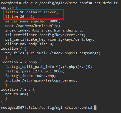

vuribe1221 Posted October 13, 2020 Share Posted October 13, 2020 (edited) Used this tutorial for setting up swag and reversed my previous port changes. Now I'm over at the swag topic nagging about getting a config file so the container is forwarded properly. https://www.youtube.com/watch?v=I0lhZc25Sro Thanks saarg Edited October 13, 2020 by vuribe1221 Quote Link to comment
saarg Posted October 13, 2020 Share Posted October 13, 2020 32 minutes ago, vuribe1221 said: Used this tutorial for setting up swag and reversed my previous port changes. Now I'm over at the swag topic nagging about getting a config file so the container is forwarded properly. https://www.youtube.com/watch?v=I0lhZc25Sro Thanks saarg Nagging won't help. The proxy-confs are often supplied by the users and not us. 1 Quote Link to comment
