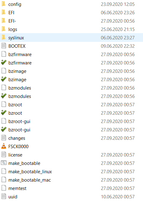

2 days ago (on bare metal) i used the USB Creator to create a new Unraid Stick for my other Server while the Unraid USB drive for my Gaming Machine was still plugged in. (bad i know)
In USB Creator i choose the other USB Drive to erease and write but it failed :( and it wrote the data to my productive stick. (no data on the new USB drive)
i run 6.8.2 on my Gaming Machine, i told the USB creator to get ma 6.9 beta on it, i did not touch anything on the drive since that happened and did not try to boot it, but somehow it did not erease it, more overwrite it, see attached screenshot.
Can i do anything to get this to work again ? i Have a backup from june but its old, basicly i want my Settings and VM Settings back.

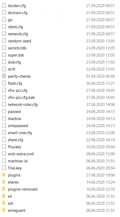

Post a screenshot of the contents of that config folder.

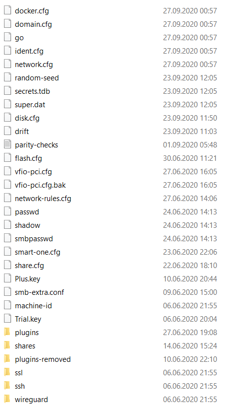

Hi, here is my config folder.
Looks like it might still have your config. Have you tried it?
i could manage to recover the docker,domain,go,ident and network.cfg from a backup and recovered it successfully, Thank you
