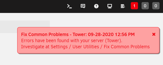

i also just noticed:
I looked through fix common problems and it just has an issue with tatauii being in slave and a docker had an update.  I cleared the notification and hasn't come back.
I attached the diagnostic in case someone more knowledgeable than me wants to take a peek.

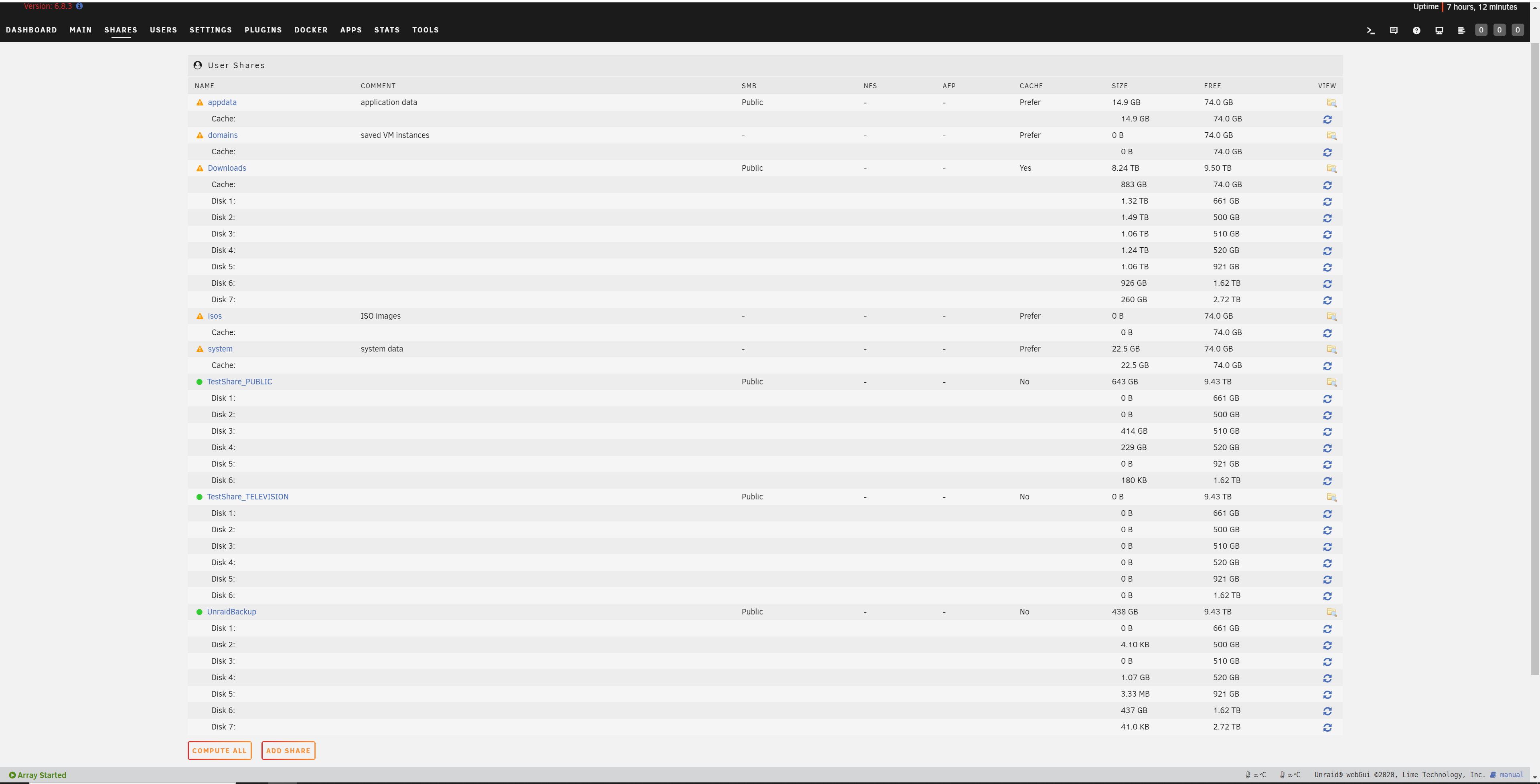

Go to Shares - User Shares, click Compute All, wait for the result. If it doesn't show the results after a few minutes refresh browser. Then post a screenshot.
Most of your Cache seems to be used by your Download share that is set to YES.
It raises the question of why so much data you actually need on Cache from that share. Is 883 GB expected between 2 Mover runs?
if so your Cache size might not be appropriate
if not, why your mover does not move that data to the Array ?
What is the scheduling of your Mover ? Did it run recently ?
You can of course launch it manually.
Note that mover can't move open files, so if your Downloads includes seeding torrents, for example, they can't be moved while seeding.
Your diagnostics were just after reboot so no mover runs in syslog. If those files aren't getting moved and you can't figure out why you can turn on mover logging in Settings - Scheduler.

I have CA Mover Tuning plugin initiate the mover at 95% full, so most of my current media stays on the cache.
I just looked at a couple screenshots and i must have been looking at the flash drive being mostly empty, because my cache was at 89% full before i shut down.
