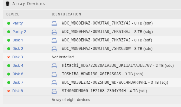

yes im trying to just remove the new disk (3) which is empty but disk 8 is disabled assuming due to power so i just would rather continue to use unraid as it is without adding disks till i further figure out what the issue is.image.png.59e18c52967b908971371c814d407c4a.pngserver-diagnostics-20200928-1932.zip

Since you have dual parity, you can rebuild disk8 without having disk3 installed.
how do i do that? do i just unselect disk 3, start the array and do a parity check?
You should be checking to see if your PS has single or dual +12V rails.   Single rail PS's are recommended for servers.
Looks like disk3 is already not assigned.
Stop array, unassign disk8 (and disk3 if not already), start array with both unassigned.
Stop array, reassign disk8, start array to begin disk8 rebuild.
After disk8 rebuild completes, you can shrink the array with New Config (without disk3) and rebuild parity.
