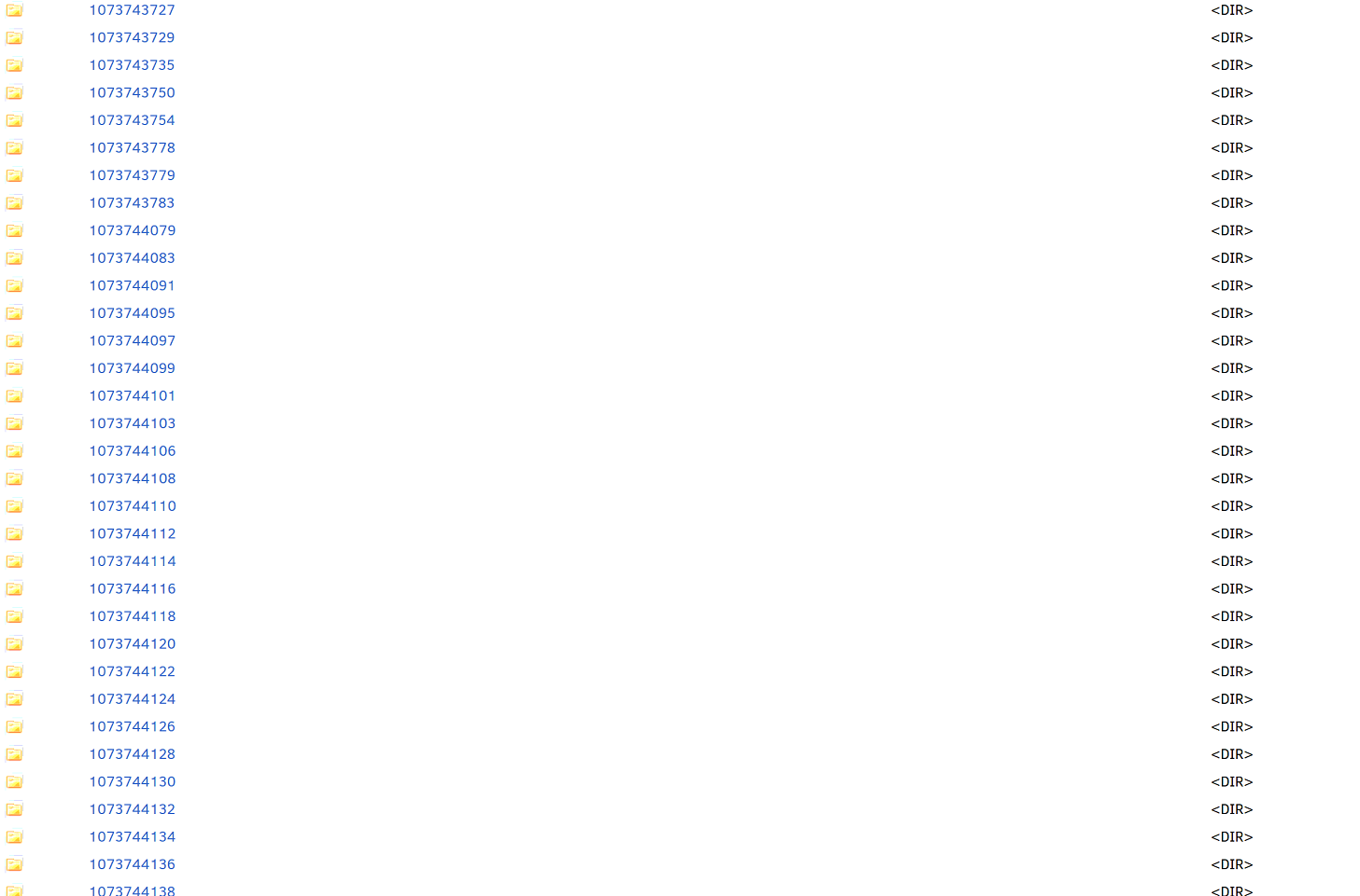

There are 760 numbered folders (which contain data that is readable) but seems all disorganized (see attached screenshot).
There's no magic way, you'd need to check folder by folder, "file" command might help identify some of the files.
for my docker apps, I should reinstall, then move all the lost+found files/folders?
Best would be to have an appdata backup, then you could restore it, it won't be easy to restore from lost+found folders.
