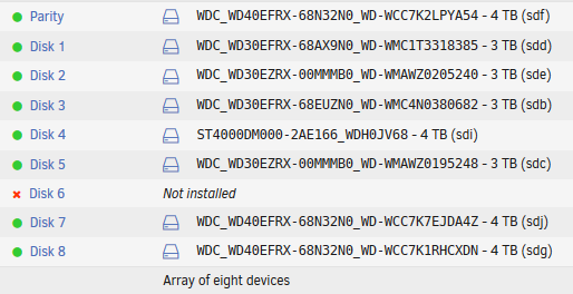

I have 8 disks, a mixture of 3TB and 4TB and 1 parity running under 6.8.2. I had Disk 4 show signs of failure, so I backed up Disk 4 to another array as a precaution, and pulled a spare 4TB drive that I keep for disk failures to swap in while I submitted a warranty claim.
When I powered the box on again it showed that Disk 6 was not installed and Disk 4 didn't have a file system. I thought that was a little weird but figured maybe I bumped a cable or something while I was swapping Disk 4. I opted to format Disk 4 before opening the case again to check on Disk 6 but discovered that despite Disk 6 claiming to be not installed it was formatted too. I assume that Disk 6 must have also failed while I was swapping Disk 4. Even after the format Disk 6 is still displayed as not installed.
Disk 4 is no big deal as I took a backup before starting. Disk 6, I'm a little puzzled about. I have my critical data backed up so I can sync my most recent backup to my shares and get that back. To my mind formatting the disk, even though the drive was seemingly failed should tell Unraid that I don't care about that data.
I am curious if perhaps I don't understand it as well as I think and if there is a way to make Disk 6 appear as failed again or convince Unraid to recover that disk from parity by some means to restore the non-critical data once I get another drive in there.

Did you actually unassign disk 6 before formatting? If not then presumably it formatted all assigned disks that weren't mountable.
Since you have backups that will be the simplest way to recover.
Of course, formatting isn't the way to fix unmountable disks. You should have asked for help before doing anything.
Yeah, I got cocky since I knew I had a backup of Disk 4 and Disk 6 "appeared" to be disconnected. I presumed that I was going to be able to format Disk 4 on it's own, which was a replacement for an already failed disk and data loss wasn't a concern, and then address my issues with Disk 6 after. Needless to say I was a little surprised to find that Disk 6 was connected. I got suckered in by the "not installed" message, didn't think and wound up wiping Disk 6.
In hindsight unassigning Disk 6 would have been logical but as I said...I got cocky. It won't be an issue to restore the critical data. Needless to say the majority of what was on Disk 6 was non-critical but nice to have. I just don't have much of an idea what was lost.

Looks like you are using a Marvell controller for four of your drives, two of which are ones that you were having issues with in this post.  I don't believe Marvell controllers are recommended and all of your connections issues may be caused by this card.  It could have also been the cause of the corrupted file system on disk6.
As for formatting disk6, judging by your logs, it looks like disk6 (sdh) drops in and out because of connection issues (presumably). I can only guess that it looks like it drops out when it should have been assigned the "disk 6" designation but still maintains a md6 presence.  so the format is performed against md6.  Just my educated guess.. in that case, maybe this is a bug
That's interesting. I had the card on hand and gave it a go. I didn't even stop to realize it was a Marvell. I stuck it in there and just lit stuff up.
