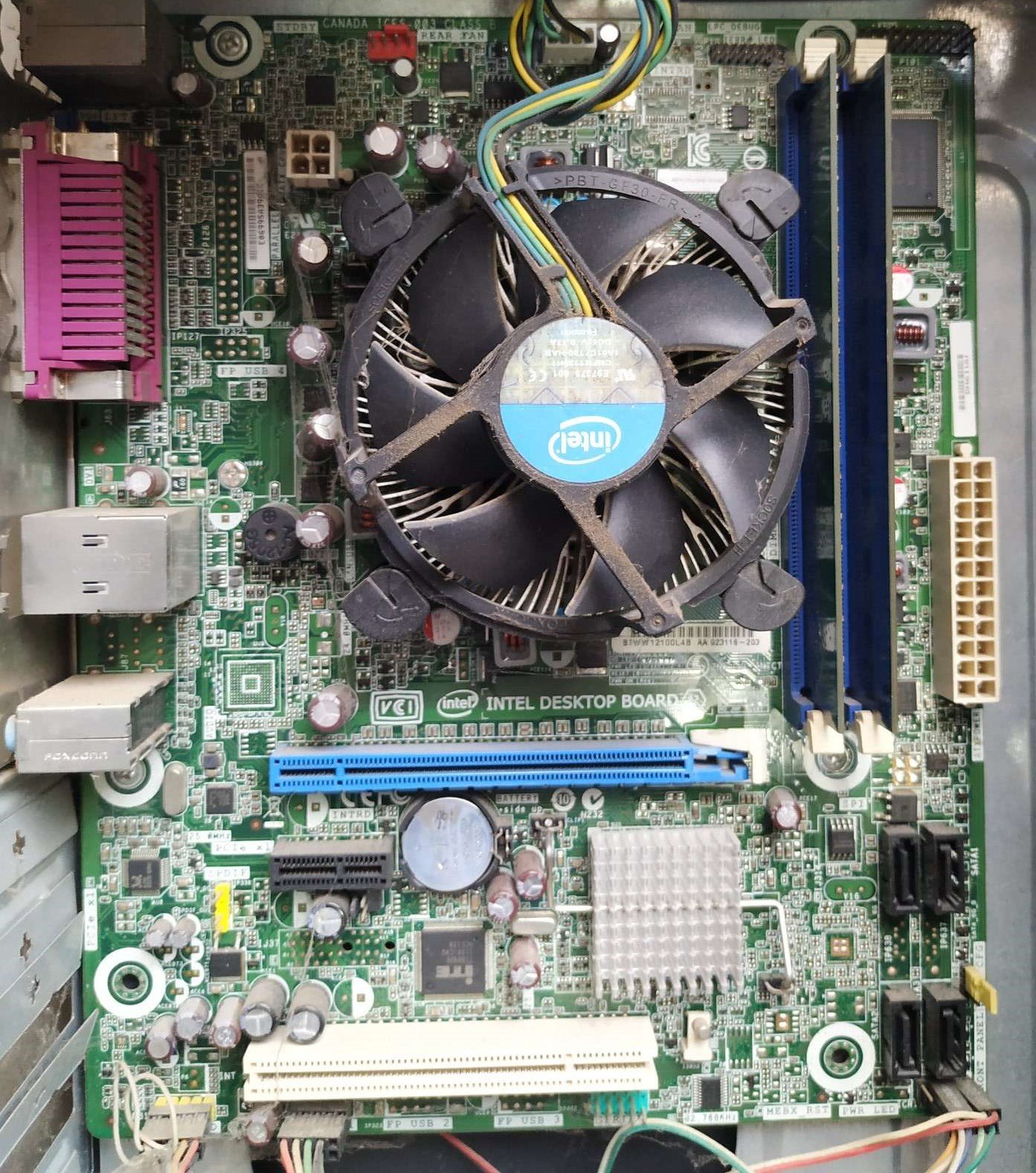

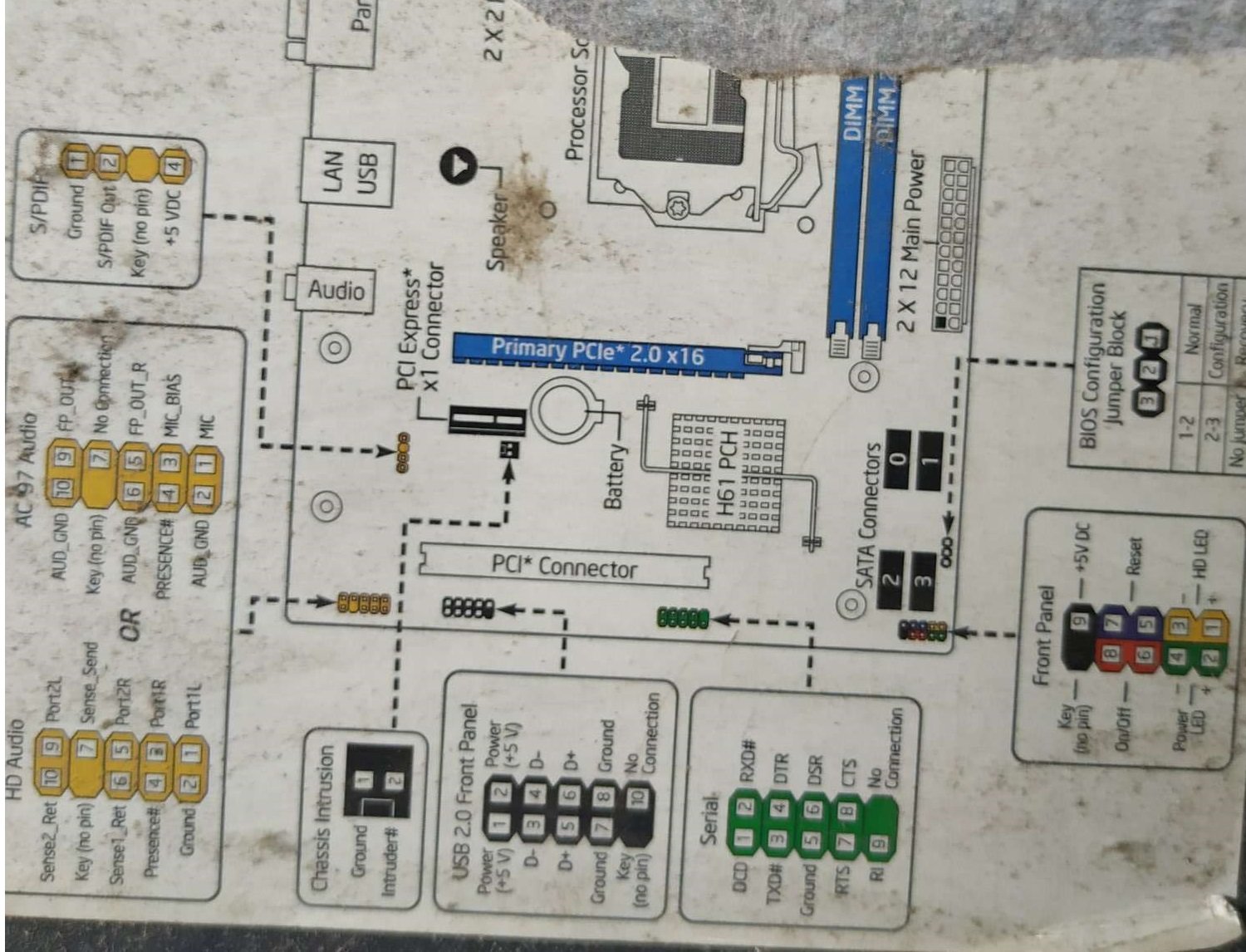

mother board has 4 sata ports, i need another 4 or 8 sata ports for my setup. i have gone through few old discussions and unraid compatibility list
i am unable to chose good adapter to expand sata ports . please recommend me a ideal one for my setup

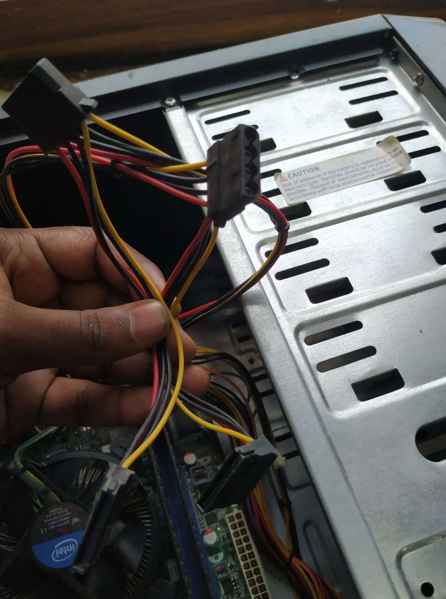

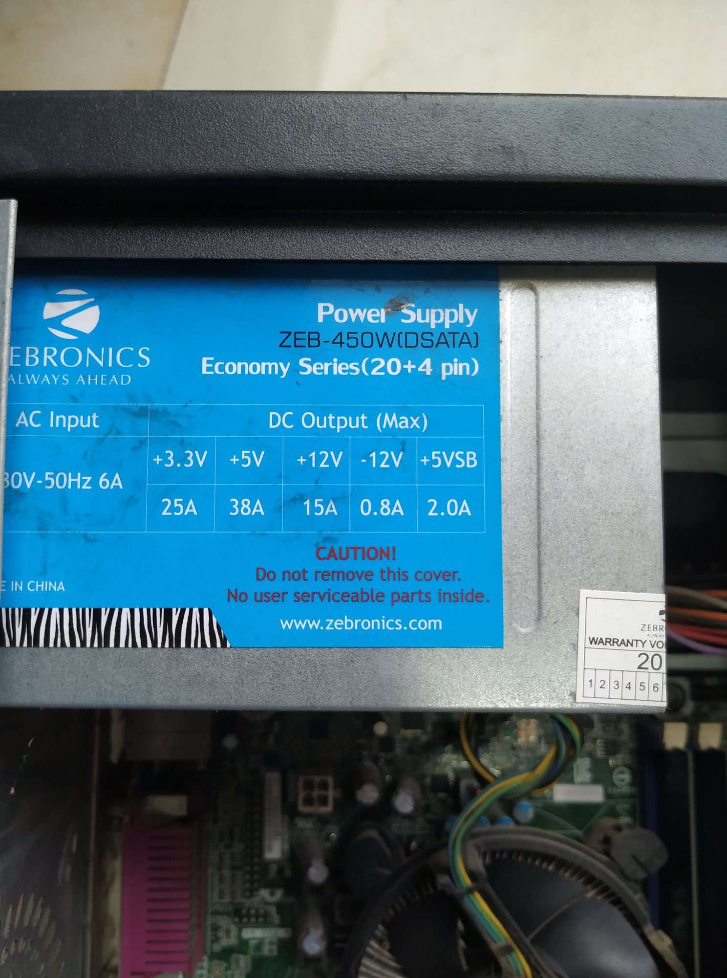

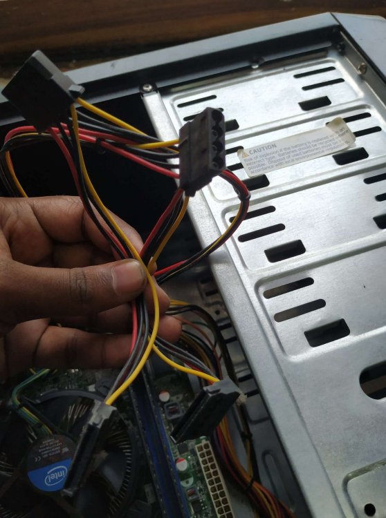

instead of pci to sata shall i buy PCI to USB 3.0 card ?? i want to do this because i need not to buy additional power supply unit .
wd my drive comes with its own power adapter .. i want to power it using power adapter connect it over usb drive
if unraid doesn't take usb drives while making pool drive .. recommend me a power supply unit too
how can i add a gigabit Ethernet port if i use PCI slot for extra sata ?

USB is not a reliable permanent connection which is required for parity array or cache pool.
Usually you power drives from the same power supply as the motherboard.

Not enough information in that Amazon listing to decide whether to recommend or not. You could try it.
There is a very high chance that controller is marvell chipset, so not recommended. I don't know of any 4 port controllers that will work well. Your options are asmedia based 2 port, or JMB585 based 5 port cards, or LSI based 8 port cards.
There are some asmedia 4 port cards, but they use port multipliers, so also not recommended.
This should work. https://www.amazon.in/CREST-Internal-Non-Raid-Controller-Bracket/dp/B07ST9CPND/ref=sr_1_2?dchild=1&keywords=JMB585&qid=1601386545&sr=8-2
