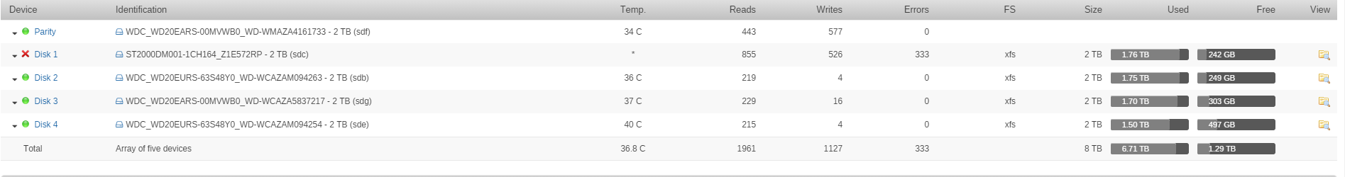

I have 5 2tb drives (including 1 parity) running on Unraid 6.5.3
I have a drive that is giving errors and looks to be failing. I bought 2 4tb drives to replace the failing drive and the parity. I started by replacing the parity because I cant replace the failing drive with a bigger drive before replacing the parity.
I am in the middle of a parity rebuild and it is taking forever because of the "bad" drive. It ran overnight and got to 35% and the ETA jumps between 9 hours and 350 days. Do I just leave it go or should I (can I) put the old parity back in and figure out how to replace the failing drive first?

Again, thanks for your help. I put the original parity drive back in, did the New config and started the array with the "trust parity" option.
It took a while but I was able to get the array to start with the "old" (original parity drive) but the "bad" disk is now showing disabled.
I have 2 new 4tb drives but dont think I can replace that bad drive with one of those yet because my parity is only 2tb, right?
Just verifiing, before I cause anymore damage :), what I should do next.

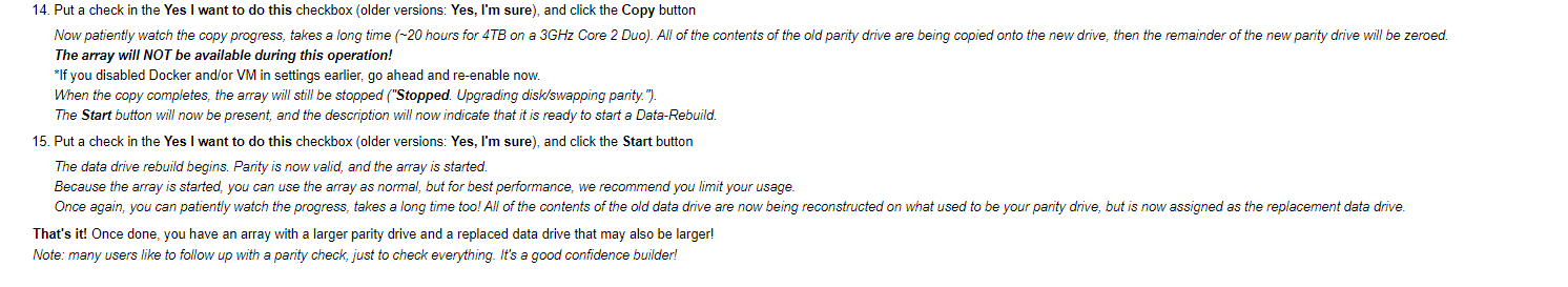

Running step 14 now but have question when it is done.
I have a new 4tb drive in for the new parity and the old parity drive that I am copying from will be removed from the system. I have another 4tb drive that I am replacing the bad drive with.
After step 14, can I power down, replace the old parity drive with the new 4tb and then resume to step 15.
Or should I just follow the process and rebuld onto the old parity drive and then replace it after the entire process is done.
I hope that makes sense :)
Scott
You have to do this, or will need to rebuild the larger disk twice anyway.
