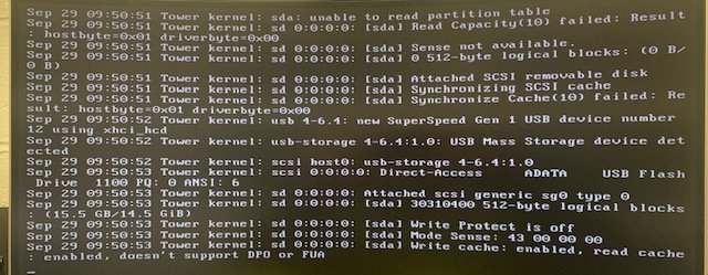

I am trying to get Diagnostics through the terminal because I can't get to the dash board.  It is not working very well.  I have tried cp /var/log/syslog /boot but it is not saving to the flash drive.  I have also just tried to type diagnostics in the terminal and this did not work.  Bad command or something like that.  Any other ideas?
Edited by okhomer
This was using the tail -f --lines=100 /var/log/syslog command.

Make sure that the flash (boot) drive is plugged into a USB2 socket.  (For some reason, certain BIOS/MB seem to lose the Unraid boot drive when plugged into a USB3 socket.)

I was able to get it to load with an IP address plugging it into a USB2 port.  I managed to get the log file to save to the flash drive.  Still was not able to pull up the dash board..
