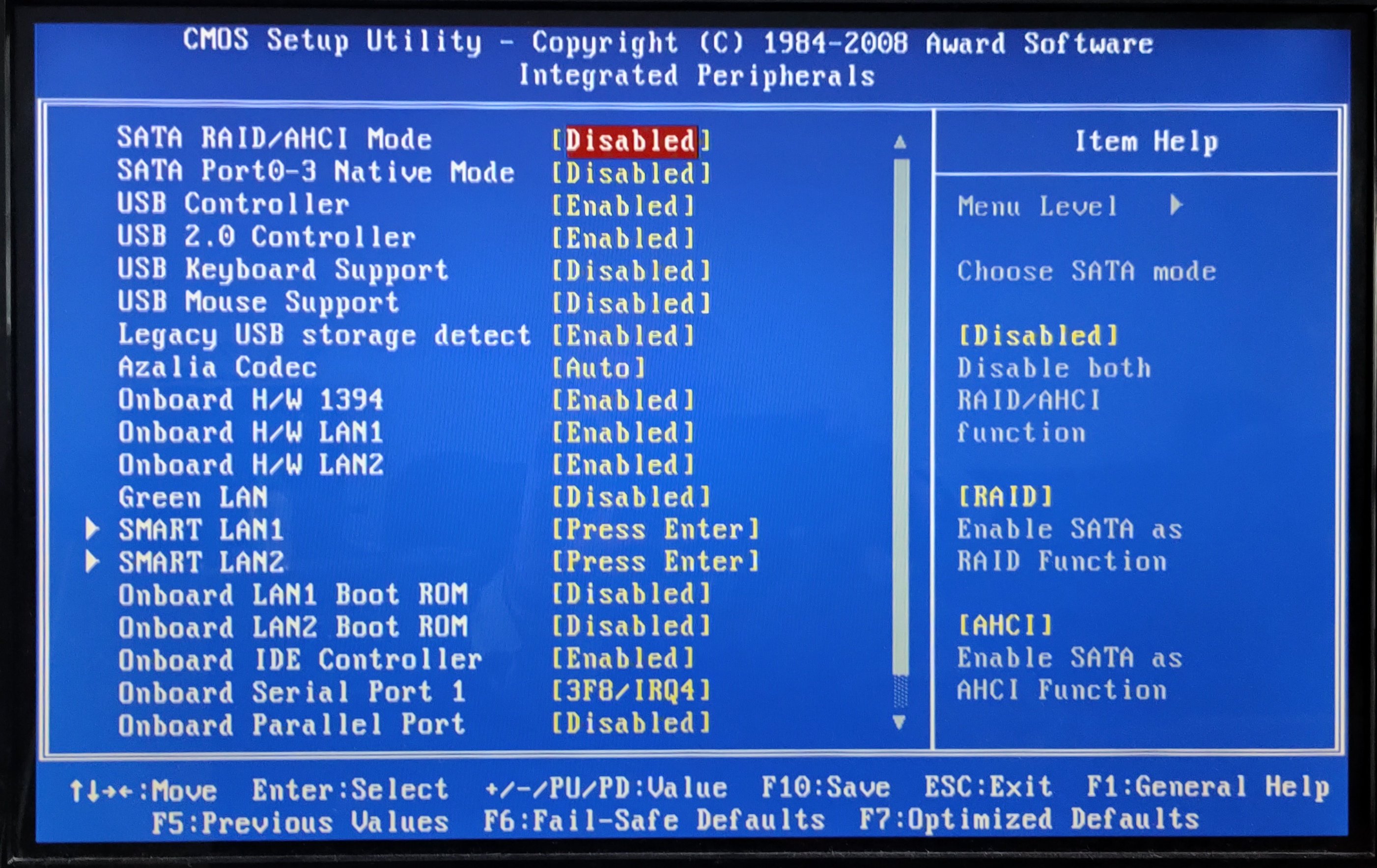

5. All the BIOS parameters relevant to this issue are under Integrated Peripherals and the rest can safely be left to the Fail-Safe defaults.
So I'm currently messing with the Integrated Peripherals parameters then rebooting and checking Q-Flash. If I should be exploring wider parameters or if there's a better test than this or if any of my assumptions are wrong, do please shout out.

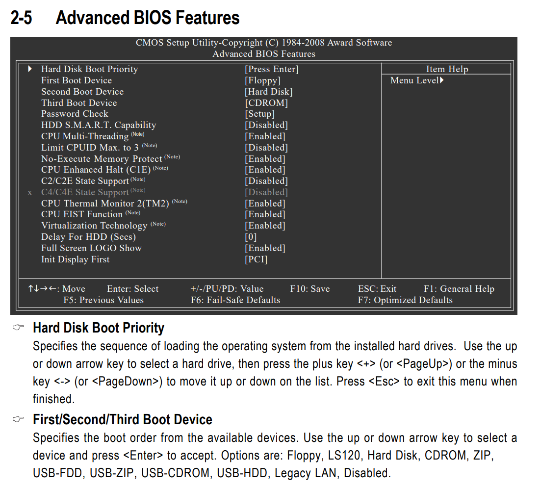

Hi, the manual suggests you should be able to select USB HDD on the advanced tab.
My Gigabyte Z68 has been retired for a while, so I don't remember if there was an option to select a specific USB device to boot from, or if it was just USB HDD and then let it boot. It may you can select USB HDD then make a selection of the drive in Hard Disk Boot Priority.
I'd stick to the back plate ports for now, disable the full screen logo, and the second and third boot devices then see what is reported at POST.
Gigabyte also used to use CTRL+F1 for some more advances settings, could be something hidden.

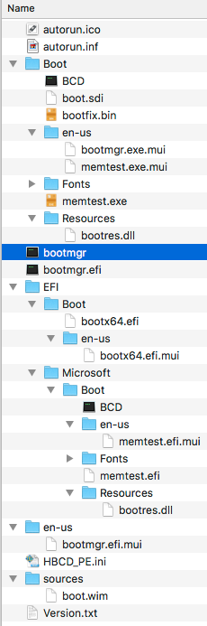

I'm still puzzling over this. Perhaps someone with a general knowledge of bootable USB drives might be able to help out here.
The Hiren's Boot CD (USB version) that I have here is the one USB drive that boots all the way. I have not been able to create any other USB drive, using any other operating system, that does this.
The only unique feature I can identify with this Hiren's USB is that it uses the Windows operating system. All my other attempts (including UnRAID) have involved versions of Linux.
I'm attaching a screenshot of the Hiren's directory structure in the hope that someone here might be able to put their finger on why this boots and others don't. If there's any other information that would help with this, do please let me know.
Thanks in advance to whoever responds and in any case thanks to all of you reading this.
