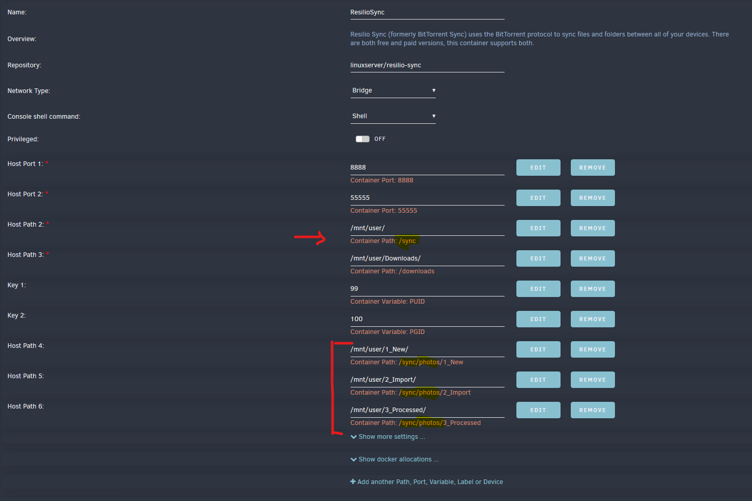

After a bit of fiddling around I discovered resilio won't show any container path unless it's a child of the primary hostpath /sync. So in the below screenshot, I had to nest the extra host paths under /sync/photos/<folder> in order to have them appear. (Actually I first tried manipulating the sync.conf file to do it another way and that worked but is messy and don't recommend it to anyone stumbling upon this)
Before I'm confident, I still have to test whether it will sync properly with a small test folder locally. Resilio's own business support told me it wasn't possible so I'll report back if it's all running smoothly. (They also said syncing files from difference logical disks isn't possible but here we are (Unraid), so I take what they say with some salt)
Just a quick note on your configuration above. Unless necessary its usually not recommended to map the entire array into a docker container (Host Path 2: /mnt/user -> /sync). Usually its preferable to give a container access to only the paths that it really needs, this improves security and lows the risk of an application accidentally touching files it shouldnt. With sync programs like RisilioSync it can be kind of a hassle to first map the individual directories you want to sync in docker and then select them in the applications, which is why some choose to just map everything.

I am not quite sure i understand this. Assuming that what i first suggested works then it should be possible to only map the individual shares you need to sync (i.e. /mnt/user/3_Processed-> /sync/3_Processed) rather than map the entire array (i.e. /mnt/user -> /sync). Again its not really critical, I just wanted to make clear that i was suggesting mapping all shares individually and removing the blanket mapping.

Sort of but not exactly. My suggestion would be to just remove the direct binding to /sync altogether, and leave the bindings to the subfolders of sync the way you have them now. The only potential gotcha i can think of would be what if the application stores anything in the sync folder outside of the individual sync directories you map in.
Oh yep, I did try that but unfortunately it's baked into the container. I also noticed someone discuss it on the linuxserver resilio thread. Basically you can bind /sync to anywhere you like, but all the subfolders for sharing need to be child folders of that /sync location.
Right but docker should still allow you to do bind mounts to children of /sync such as /mnt/user/1_New -> /sync/1_New even if you dont have a /mnt/user -> /sync binding.
Oh I see what you're saying. I'll give that a try at some point in the next week or so. For now it'll have to wait as I have about 10 sync jobs I would need to redirect before removing the /sync binding. :)
