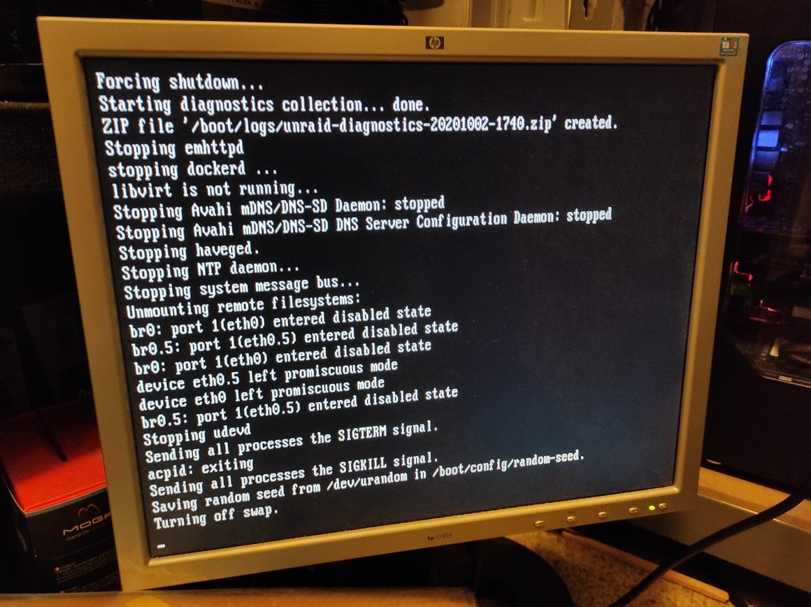

It got stuck on "turning off swap" even though I did not have a swapfile enabled. It generated a diagnostics file which I have attached.
I'm gonna give 6.9.0 beta 29 a try. Hopefully it will solve these weird issues.
unraid-diagnostics-20201002-1740.zip
