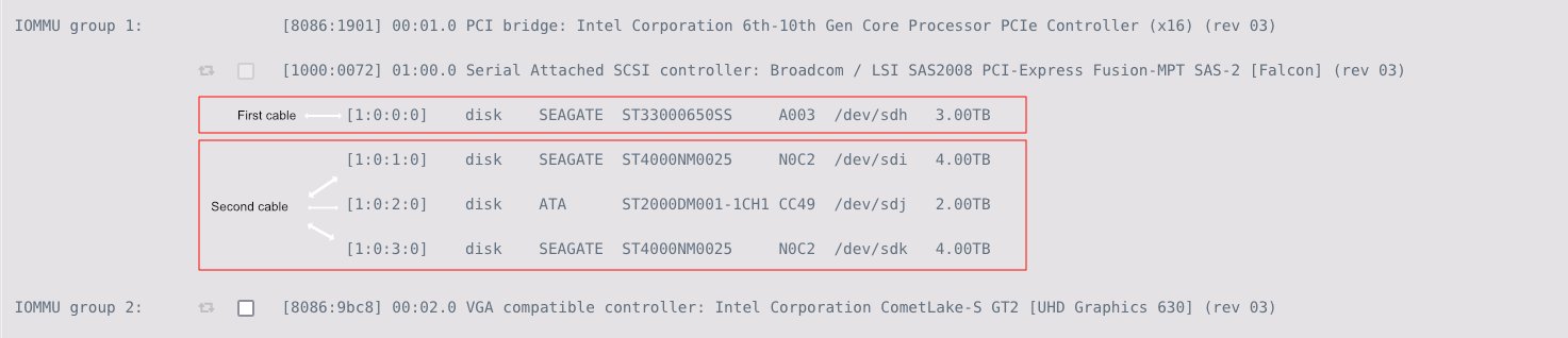

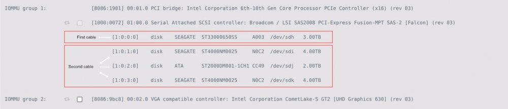

Sorry, I had had a post above
The controller is the same LSI 9211-8i
better I attached a picture
Ah I missed the fact they are all tied to a single controller.
In that case we must conclude that the specific drive (ST33000650SS) does not interpret the spin down commands as expected. Unfortunately there is no "standard behavior" re this. Newer Seagate drives tend to do the right thing, quite a few older ones do not.
Your drive seems to have been pulled from an Adaptec system, which may or may not have to do with this issue.
There's a slight chance that updating the drive's firmware will help, but I can't guarantee it will (or that you won't end up with a bricked drive), so weigh your risk. If you try this, you may want to check out this. I have not tried it, and it seems to be specifically not intended for Adaptec OEM drives, but who knows.

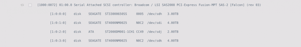

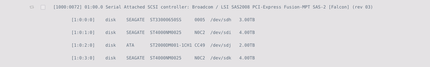

I finally decided to upgrade the hard drive because some days it worked and others it didn't.
I have put the firmware of the link on 0005 but it does not work either.
any advice?
any advice?
348457050_Capturadepantalla2022-03-17alas11_28_39.thumb.png.6346f3c005aaf07561888247b2a60225.png
Unfortunately there's not much more I can suggest. Many Seagate drives have demonstrated erratic results wrt standby/spindown. I don't know of a reliable way around it.
